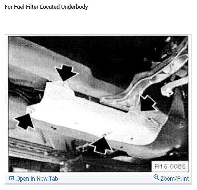

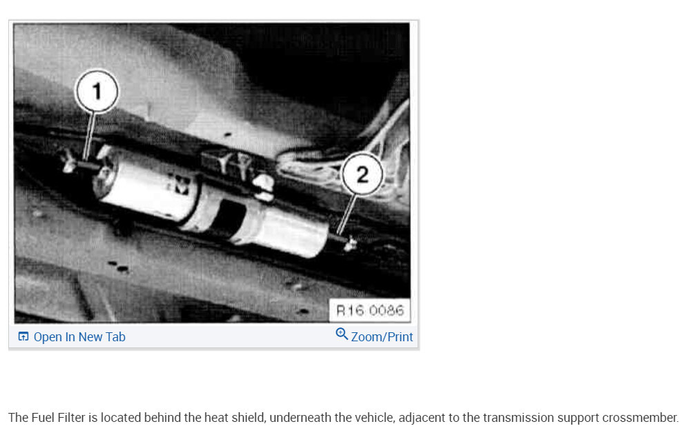

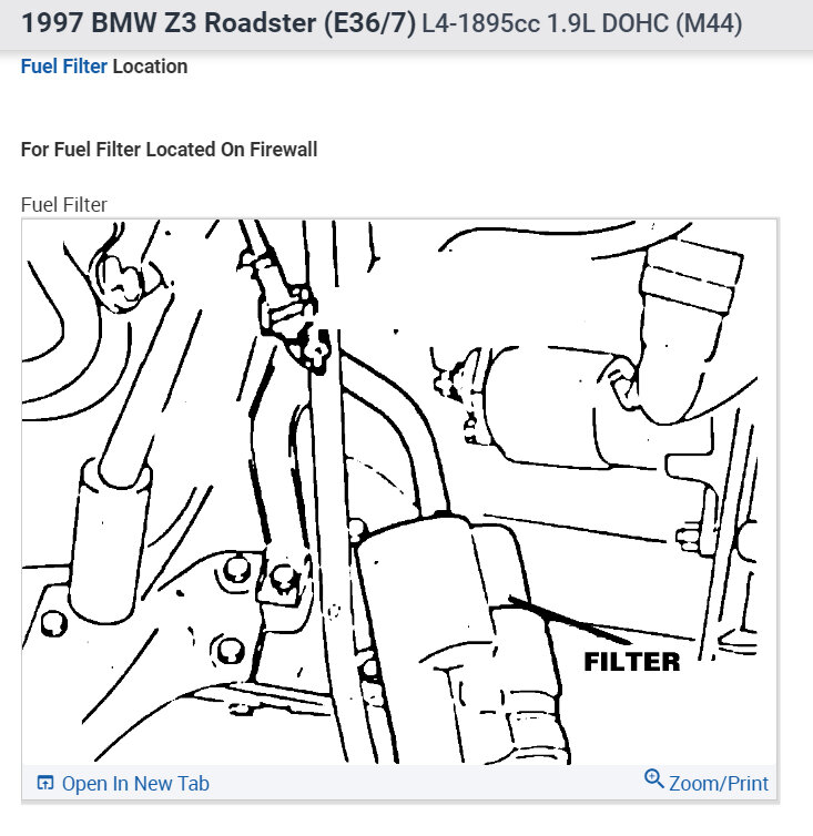

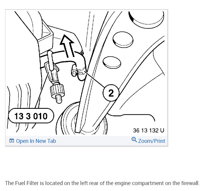

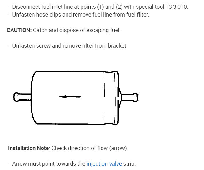

In any gear the engine will cut out around 4,000 RPMs, as if someone unplugged it and plugged it back in, it happens anywhere between 3,500 and 4,100 RPMs and it feels like hitting the rev limiter, the engine light comes on about a second later, I also get an occasional engine light on startup that stays for a day or two then disappears (potentially unrelated).
Sep 19, 2023 at 4:23 AM
  • 55,834 POSTS
The check engine light seems related, it sounds like the fuel filter is clogged. We should run the codes because the computer will store the codes once the light has come on, this guide can help, and I have included the location of the fuel filter and how to change it out:
Check out the images (below). Please let us know how it goes.
