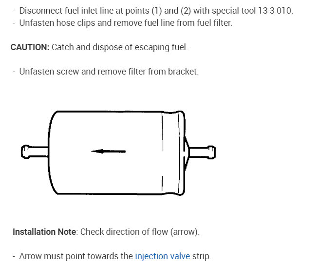

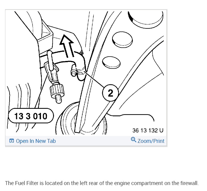

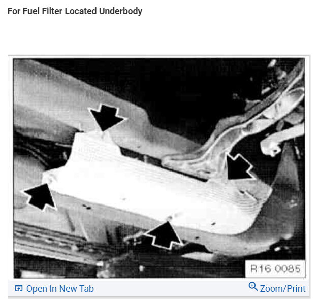

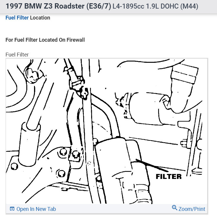

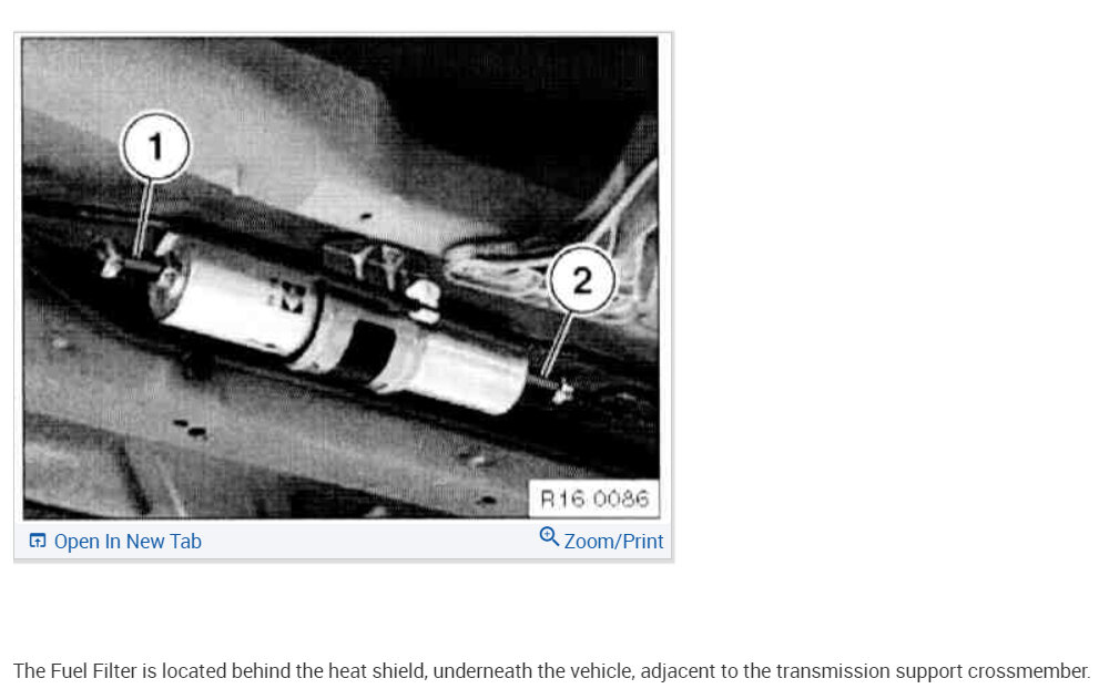

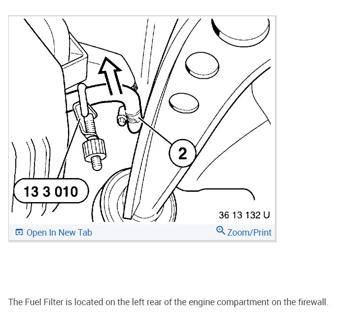

The check engine light seems related, it sounds like the fuel filter is clogged. We should run the codes because the computer will store the codes once the light has come on, this guide can help, and I have included the location of the fuel filter and how to change it out:
Check out the images (below). Please let us know how it goes.
