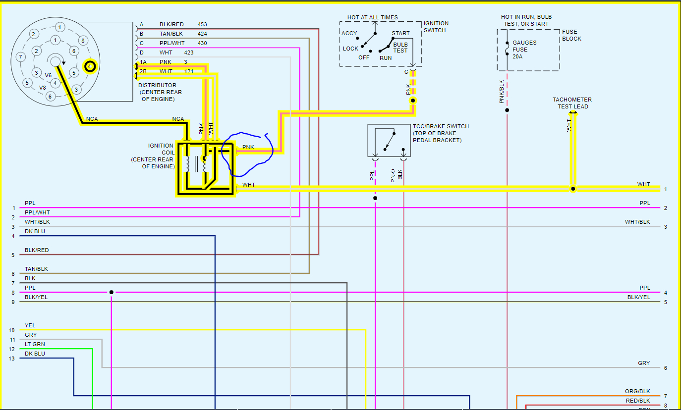

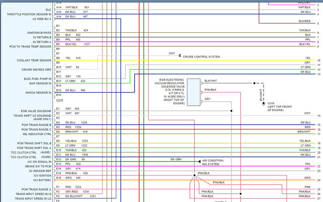

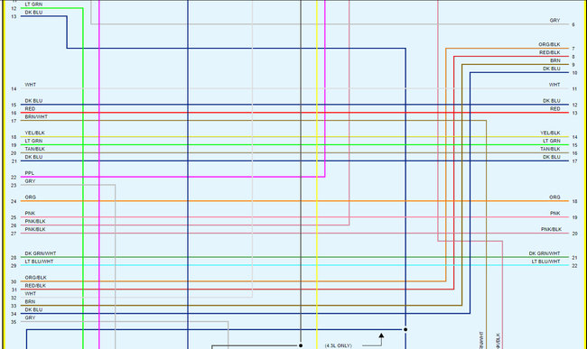

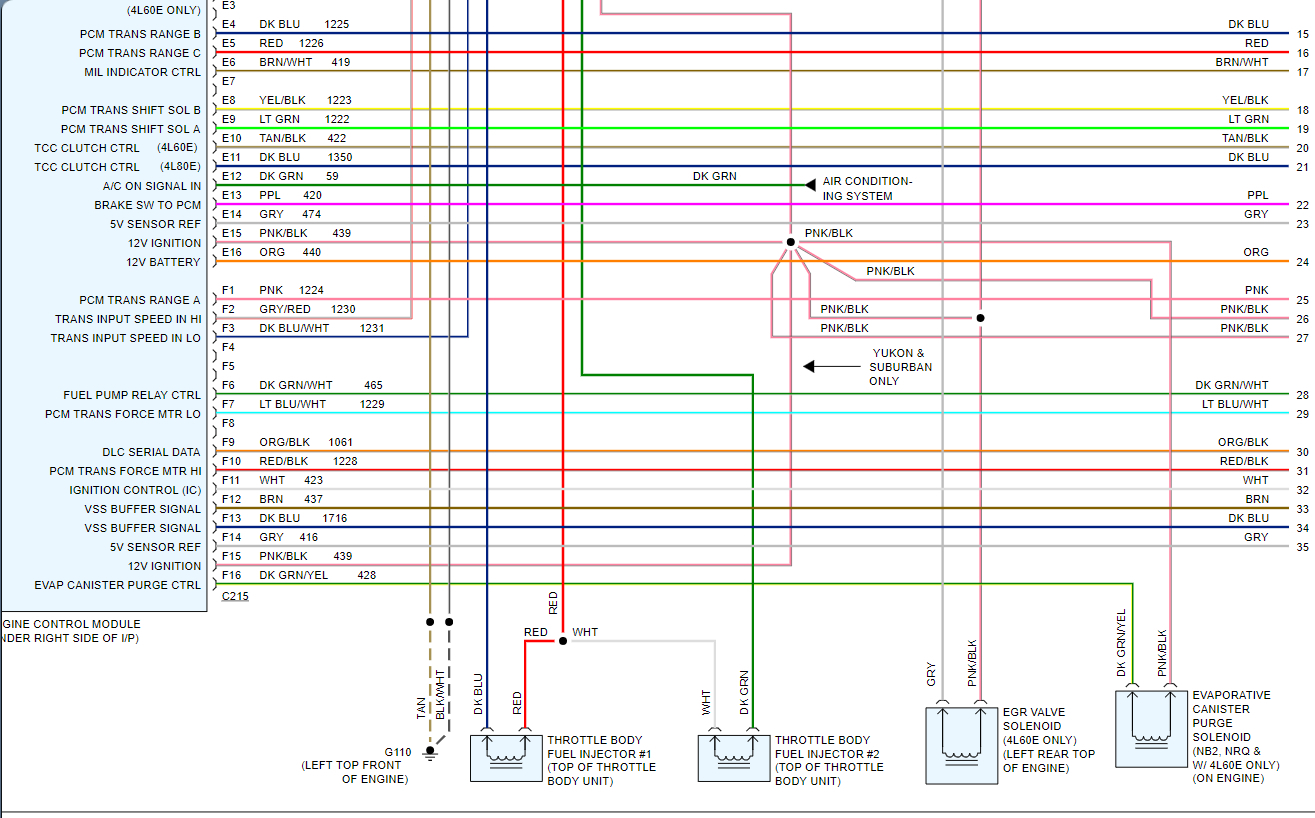

1984 GMC Suburban, truck was running fine. Engine cut out,and now it wont start. It cranks but doesn't start. Replaced injectors, put in a new coil, doesn't seem to be getting any spark. I'm at a loss on where to go from here.. can you help me please?

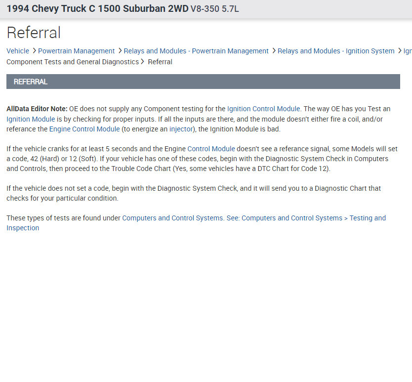

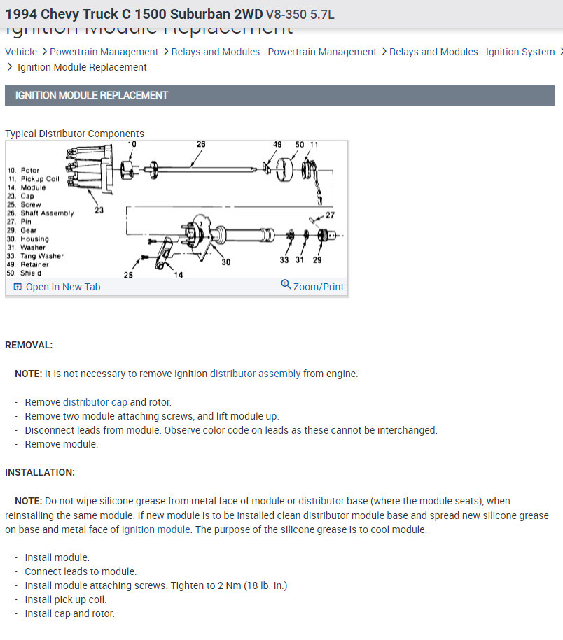

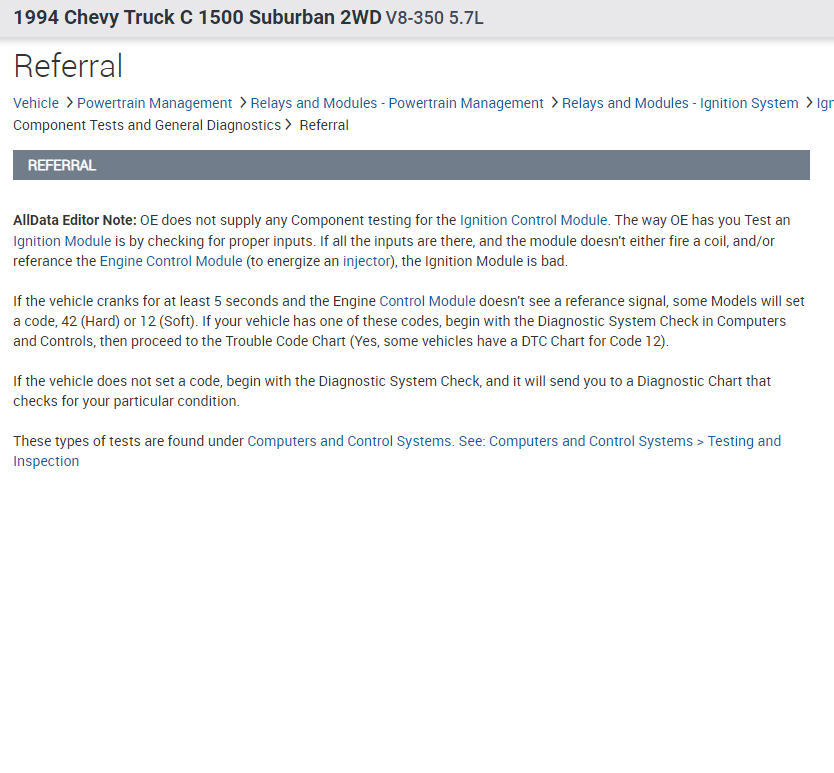

The next item you need to check is the ignition control module. It can be tested.
You can take it to your local auto parts store and they have special testers for these modules.
Here is a helpful video of how to replace the module:
https://youtu.be/Qws2hpduL5Q

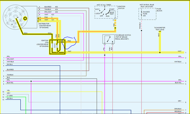

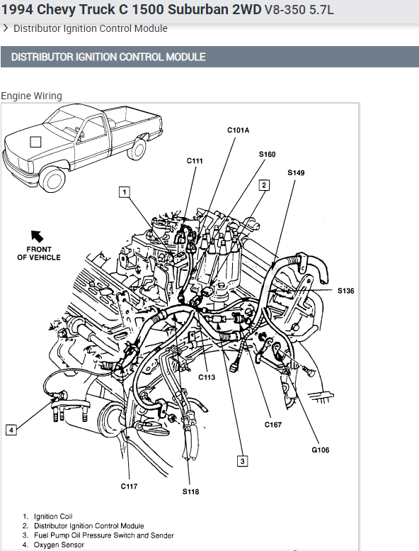

The ignition control module located inside the distributor. See attached diagram for your reference.

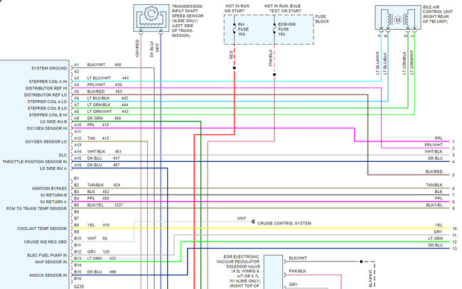

Good afternoon,

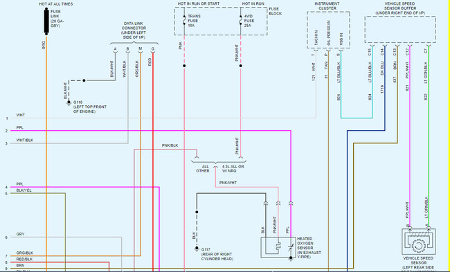

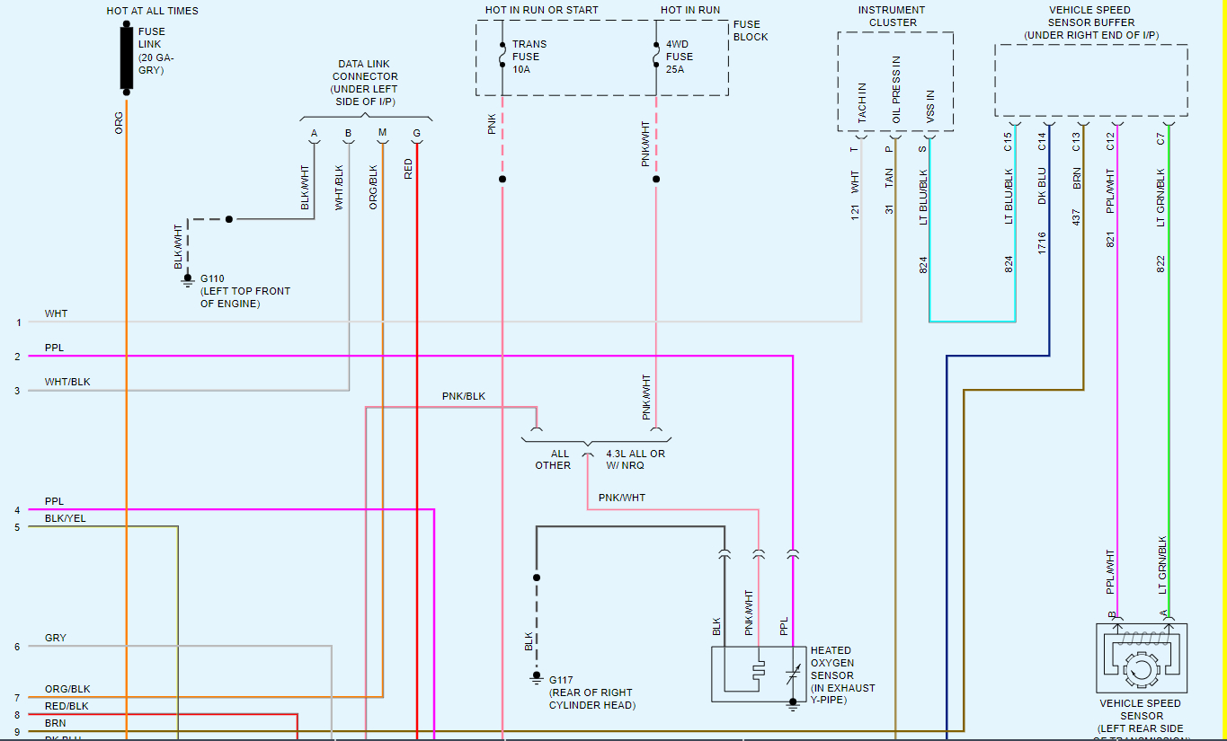

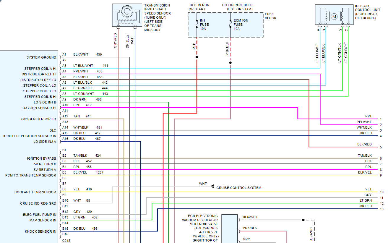

You need to do some testing to see if you need either a coil or module. I attached a wiring diagram for you to follow.
I highlighted a wire and circled it in the diagram. Verify power to the coil at the pink wire with the key on. You should have battery voltage.
If you have voltage, then you need a test light to check the white wire. When cranking, the test light should blink.
