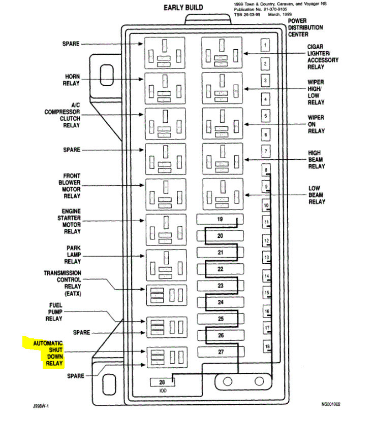

I shut the van off and went to start it and it would crank over but not start. I checked for spark and no spark. I replaced the crankshaft sensor and coil assembly and still no spark but cranks fine. I tried hooking up a scanner but it says there is no communication with the scanner. Please help.
May 7, 2022 at 2:01 PM
  • 110,194 POSTS
The first thing that comes to mind is the ASD relay (auto shut down). It is located in the under-hood fuse box. See pic 1 for location.
Switch that relay with a different one having the same part number to see if it makes a difference. If there isn't one, here is a link that explains how to test it:

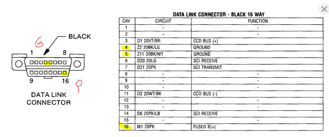

If that checks good, go to the data link connector and check pin 16 for 12v battery power. Also, confirm pins 4 and 5 have continuity to ground. (See pic 2)
Let me know what you find.
