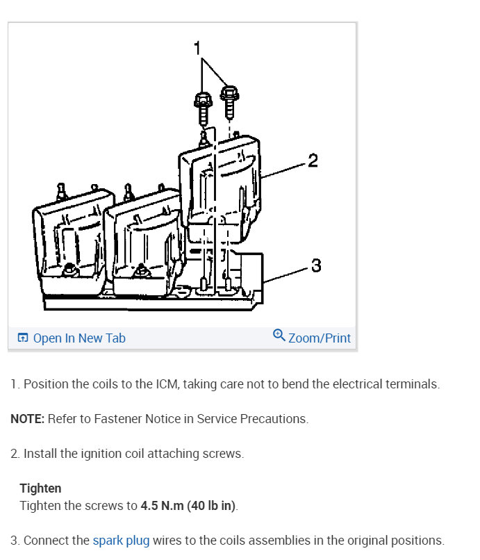

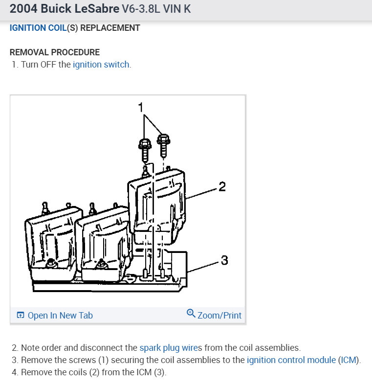

The reason the ICM goes out is because the ignition coils are bad, I would replace the ICM again and all three coils and get new wires and spark plugs. Check out the images (below). Please let us know how it goes.
