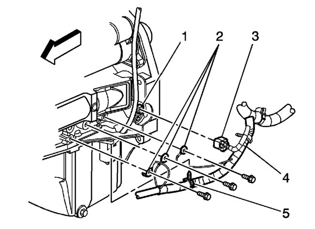

It sounds like the voltage is back feeding. Do you have a good connection for the negative battery cable to the engine block? Also, are there any codes? I would do a CAN scan which can tell you about any problems in the BCM etc. This guide and video will help you see what needs to be done. Also, does the security light blink when the engine will not start? If not, it sounds like the crankshaft sensor could be going out, which won't set a code. Here is the location of the sensor in the diagrams below:
