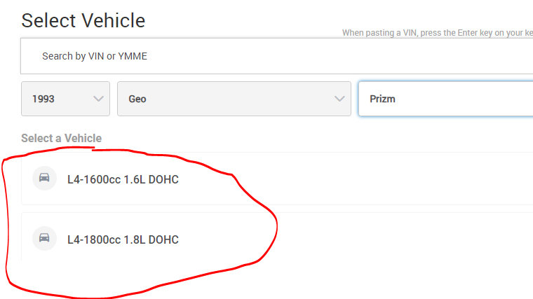

So far, I changed the coolant power stirring fluid and I have the tune-up kit for the spark plugs and wires. I have not installed the spark plug or the wires. The engine Turns over, but the car will not start. I need an under-hood Schematic for diagnostic and troubleshooting.

Mike, to get you schematics that will be helpful, I need to narrow things down. Do me a favor and try this.
See if the engine starts with starting fluid. If it does and then stalls, we know it is a fuel-related issue. If there is no change, I need you to check for spark at the spark plugs.
Here is a link that explains how it's done:
https://www.2carpros.com/articles/how-to-check-for-ignition-spark
Also, I need confirmation on the engine size. It should be either a 1.6L or 1.8L. The engine determines which schematics we need.
See pic below.
