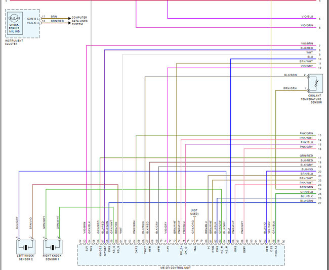

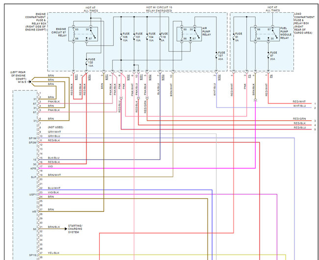

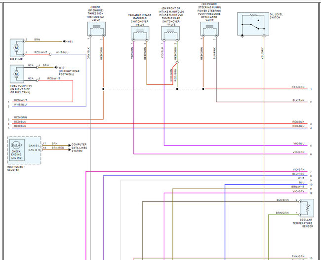

The engine of the vehicle is cranking but not starting, the engine was scanned for diagnostics trouble code, but no code was available. It was observed that fuel is not supplied to the engine. I energies the fuel pump with external battery, the fuel pump was working. However, while cranking the engine power was not available at the fuel pump. If the fuel pump connector is disconnected and probed while cranking, it will display 10v, immediately it is connected no voltage will be available to the fuel pump any longer. Removing the connector to the fuel pump and supply eternal battery voltage, then crank the engine, the vehicle engine will start running.
What could be the problem?
Could I get a wire diagram for it?
All the fuses have been checked and confirmed okay.
Thank you

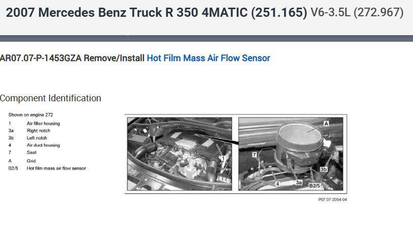

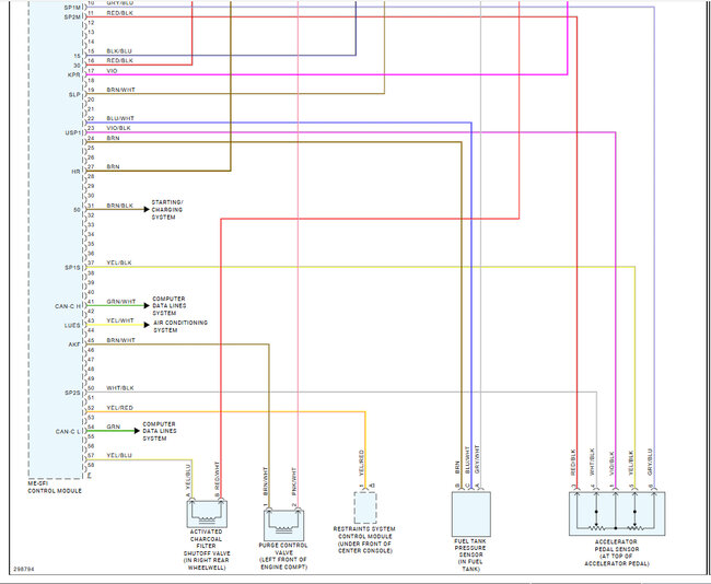

I have seen the MAF sensor failure and cut off the fuel pump for safety. If you unplug it and the engine starts, then you know that is the problem. Here is a video to show you how and I have included the sensor location in the diagrams below.
https://www.youtube.com/watch?v=lXLJbuAZ4CE&t
Here are the fuel pump wiring diagrams as requested. Check out the images (below). Let us know what you find.

The problem was the fuel pump fuse (fuse No 57), I used multimeter to test for continuity while testing the fuse initially and there was continuity. Pulling out the fuse later from the fuse box confirmed that the fuse has heat - up, the terminals even pulls into the fuse box. Replacing the fuse solved the problem, the engine has started and running fine. Does it mean that continuity is not a good way to test for fuse.

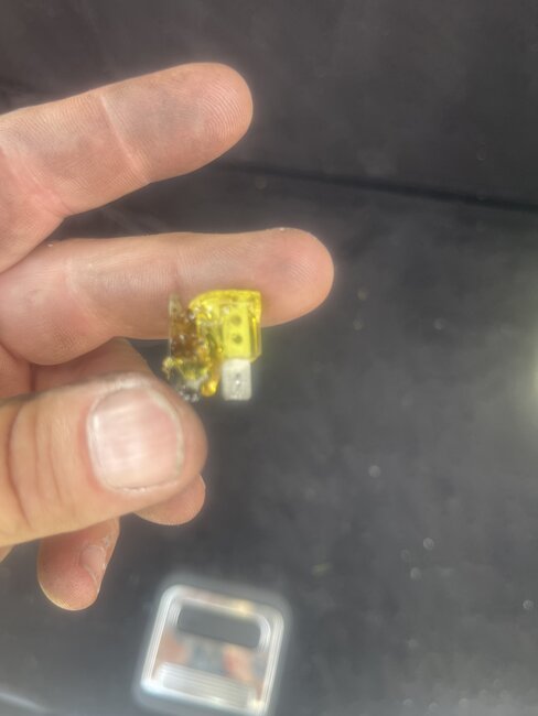

I’m having the same problem, will check fuse 51 & 57 when I get home, MaF is fine pump & filter is new..
Aug 7, 2026 at 8:40 AM
  • 55,797 POSTS
Yep, these fuses can go out and stop the engine from running, let me know what you find.
Aug 7, 2026 at 10:41 AM
TRUTHER
Fuse 57 20 amp was melted, once replaced the new fuel pump and filter worked properly and the car roared back to life. As the charcoal filter 5 amp fuse 51 was on same relay, I also replaced it for good measure after inspection relay O. See image for fuse condition.
Thanks for keeping this post up was the only helpful thing I found on line thanks to Groc AI for find you guys for me.
Aug 8, 2026 at 8:34 AM
