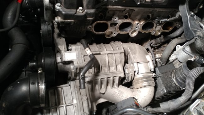

I need to replace the engine crankcase breather hose I have gotten all the way to the supercharger i just need help figuring out how to take the supercharger off and what bolts i need to take off in order to get to that replacement part. All i have to refer to is picture. Please and thank you asap!

There is 3 bolts that hold the super charger in place, 2 in the front of the unit and one in the rear.

Yep I have done this job personally on my wife's car. Poor design but, it just nuts and bolts, can I ask what you are trying to fix? I have been all over this car. By the way make sure you get the rubber tube in the back on correctly and that it is in good shape or you will get a p0075 code which is a whole nother can of worms.
