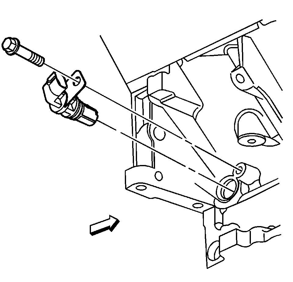

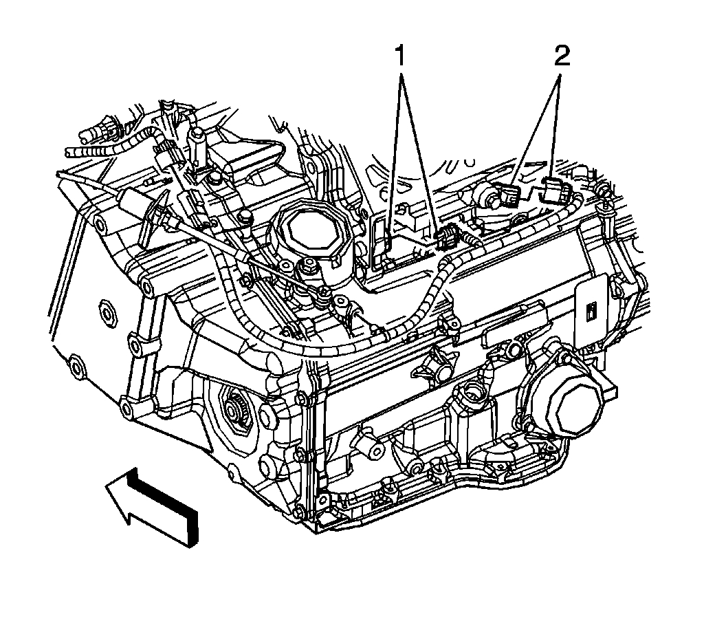

Here are directions specific to your vehicle. The attached pics correlate with these directions. Note that this will require a variation relearn. I will provide the relearn after the directions. However, as I mentioned earlier, it will still run without doing the relearn.
____________________________________________
2006 Chevrolet Monte Carlo V8-5.3L VIN C
Crankshaft Position Sensor Replacement
Vehicle Powertrain Management Sensors and Switches - Powertrain Management Sensors and Switches - Computers and Control Systems Crankshaft Position Sensor Service and Repair Removal and Replacement Crankshaft Position Sensor Replacement
CRANKSHAFT POSITION SENSOR REPLACEMENT
CRANKSHAFT POSITION (CKP) SENSOR REPLACEMENT
REMOVAL PROCEDURE
CAUTION: Refer to Vehicle Lifting Caution in Service Precautions.
pic 1
1. Remove the right exhaust manifold.
2. Disconnect the crankshaft position (CKP) sensor electrical connector (1).
pic 2
3. Remove the CKP sensor bolt.
IMPORTANT: Clean the area around the CKP before removal in order to avoid debris from entering the engine.
4. Remove the CKP sensor.
INSTALLATION PROCEDURE
pic 3
1. Install the CKP sensor.
2. Install the CKP sensor bolt.
NOTE: Refer to Fastener Notice in Service Precautions.
Tighten the bolt to 25 N.m (18 lb ft).
pic 4
3. Connect the CKP sensor electrical connector (1).
4. Install the right exhaust manifold.
5. Perform the CKP system variation learn procedure. Refer to CKP System Variation Learn Procedure.

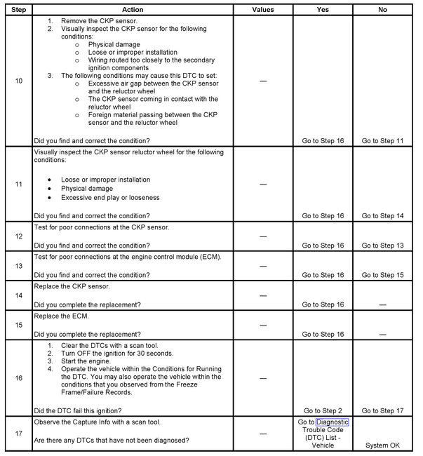

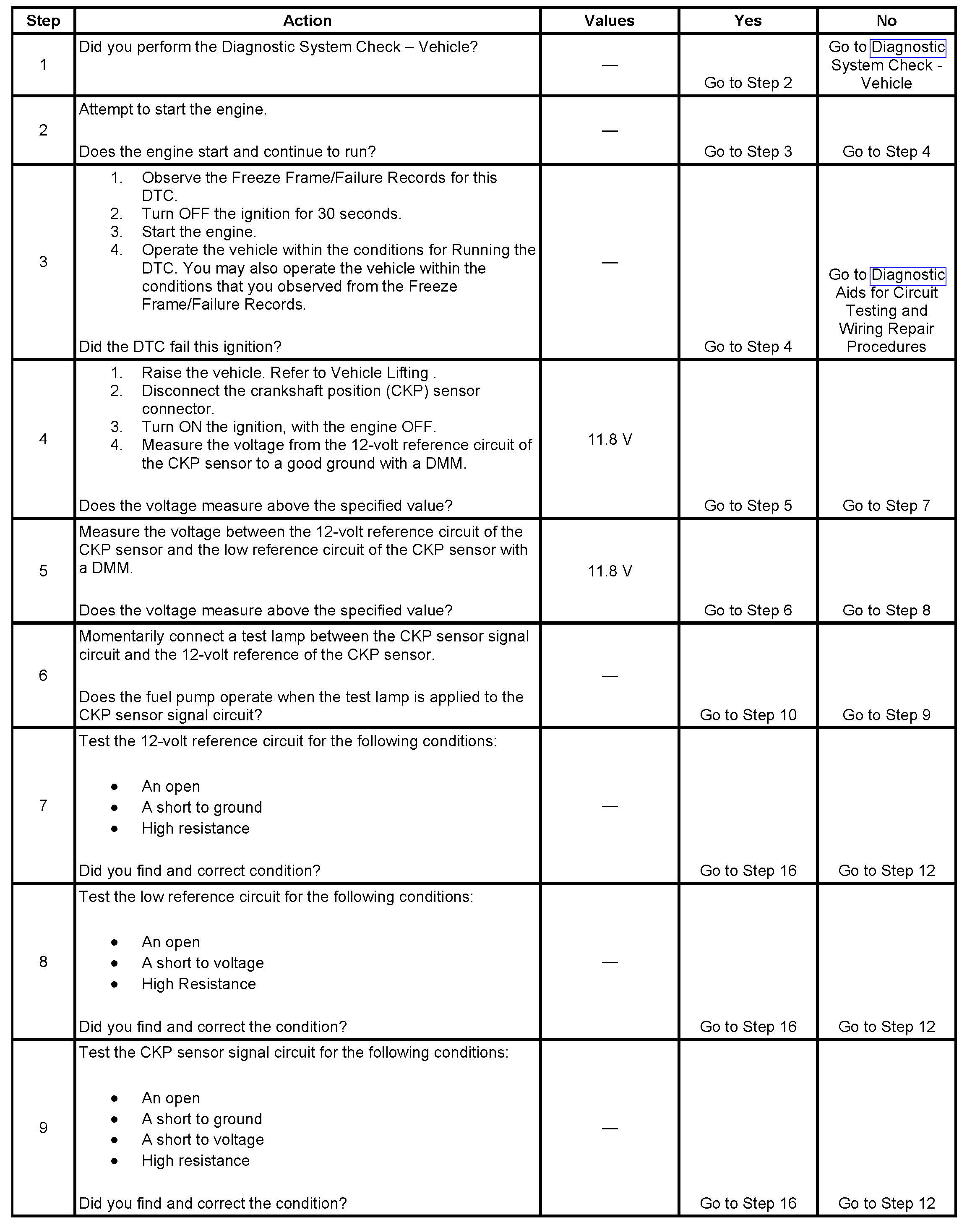

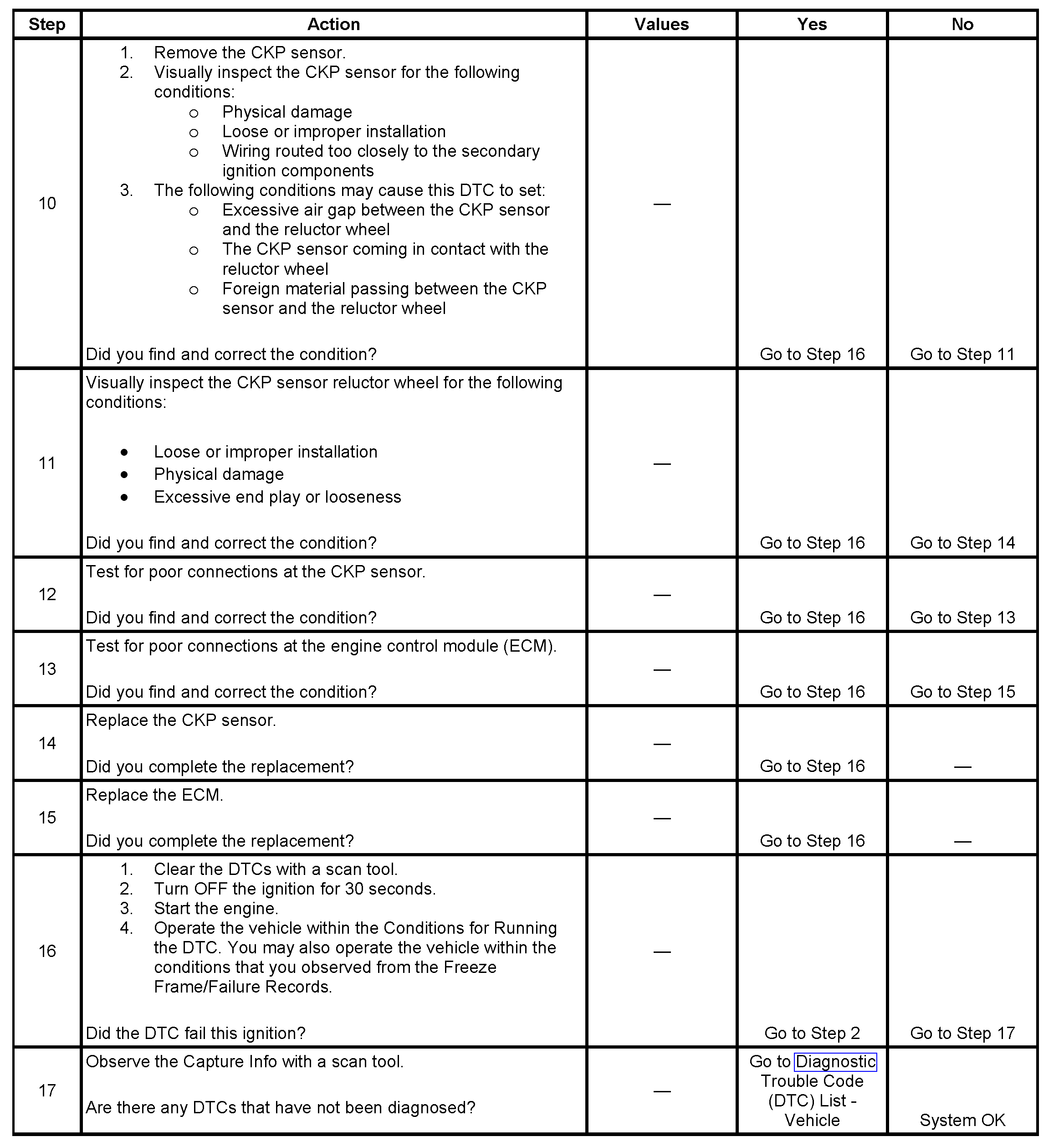

That is likely the issue. I was unaware of that. However, I attached a couple of pics below to check the sensor and circuit. Run through it and see if you find anything not working.
Oct 19, 2020 at 1:15 PM
RONALD DEVOLD
  • 134 POSTS
i'm only getting 5 volts to the 12v reference circuit on crank sensor wiring plug.
And if i unplug the crank/knock sensor harness I"m only getting about .5v coming out the main harness, so the chart leads to the ECU.
Oct 21, 2020 at 11:05 PM
  • 110,236 POSTS
Check the supply wire from start to finish for resistante. The wire itself could be the problem. Or, check to see the voltage right at the ECM.
