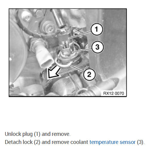

Here is the coolant sensor location in case the readings are off. Check out the images (below). Please let us know what happens.

Did you run the codes? Like I say, I have seen the engine coolant sensor cause a hard starting issue.

I would use a scanner to see the engine temperature and then if it is off change the sensor out.

You might to try swapping the sensor out to see if the reading changes.

Hi Ken, I fitted the new temperature sensor. I haven’t checked the reading yet, but it hasn’t changed the starting issue.
