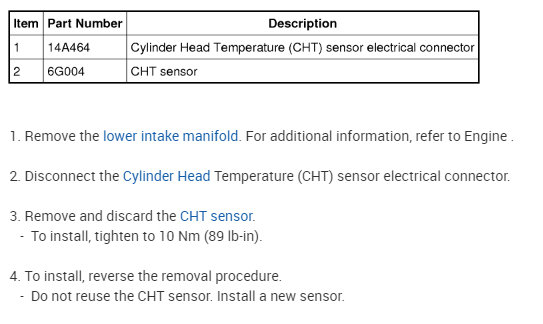

Can you tell me where the engine coolant temperature sensor is located?
Sep 21, 2022 at 3:36 AM
  • 110,240 POSTS

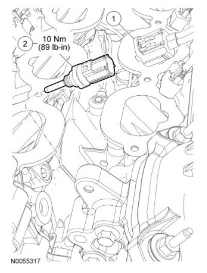

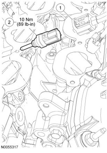

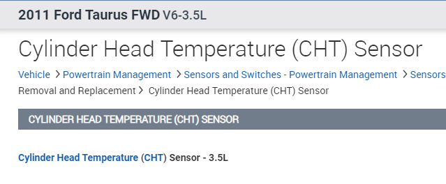

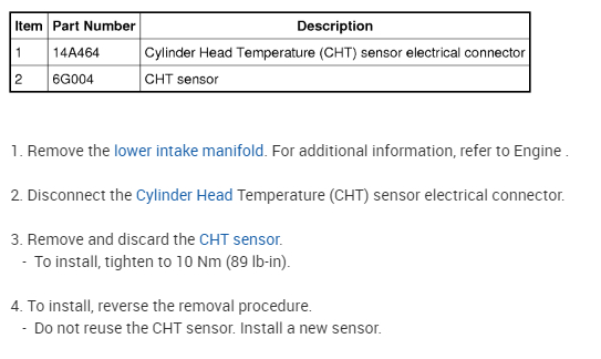

This vehicle doesn't have a traditional coolant temperature sensor. Instead, it has a cylinder head temperature sensor.
This sensor is under the lower intake manifold. See pic 1 below.
The remaining pics are the directions for replacement.
