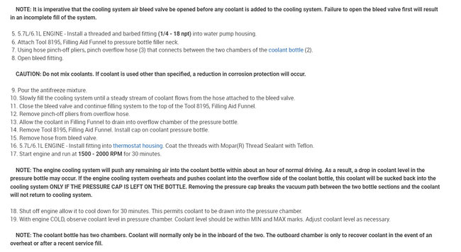

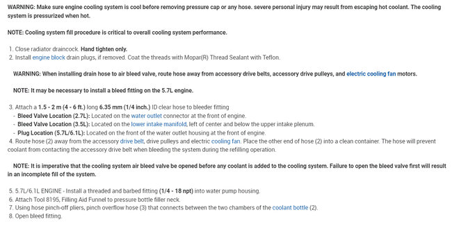

I replaced my water pump because it had a hole in it put everything back together fill it up with antifreeze I'll start it up and it's running but the radiator reservoir the antifreeze is boiling over into it and there's no heat and I replaced the thermostat along with the water pump what should I do
Jan 2, 2022 at 3:03 AM
  • 110,236 POSTS

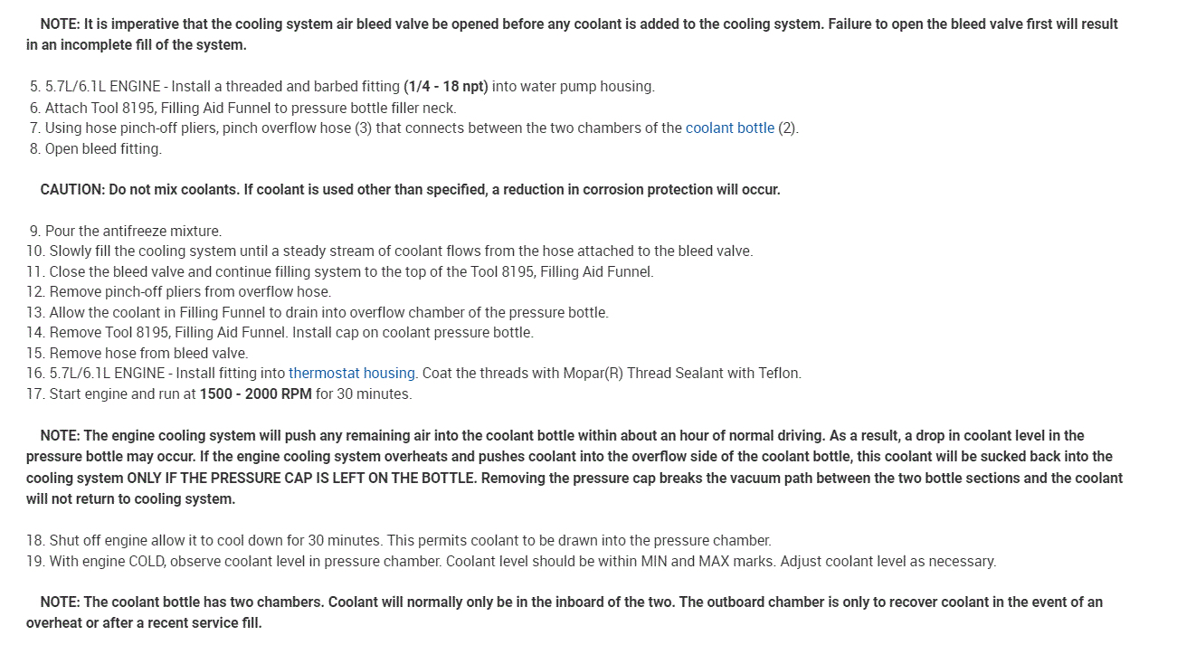

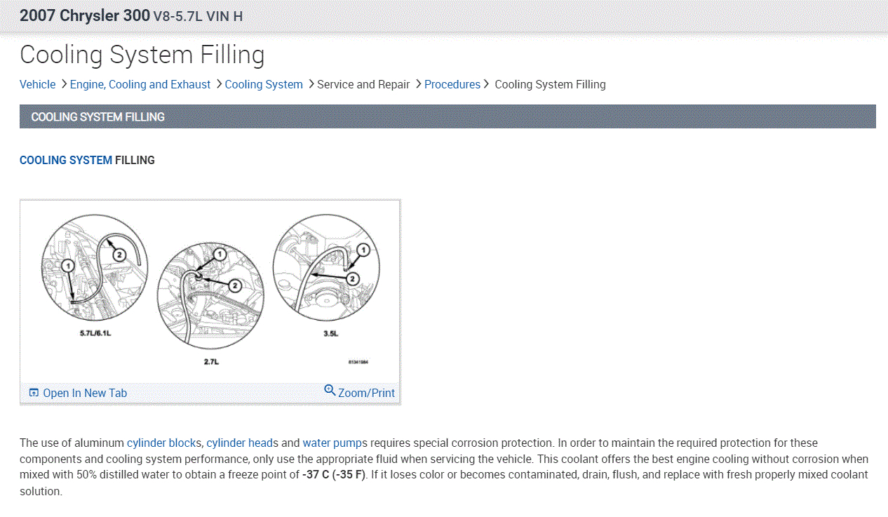

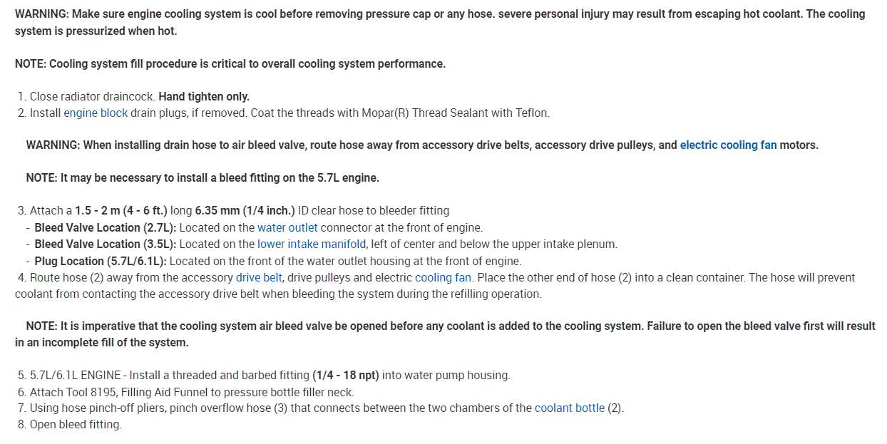

If you have no heat, I suspect there is air in the system. When you refilled the coolant, did you have the bleeder open?
Take a look at the attachments below. They provide the directions for refilling the cooling system. Let me know if that is what was done.
I will watch for your reply.
