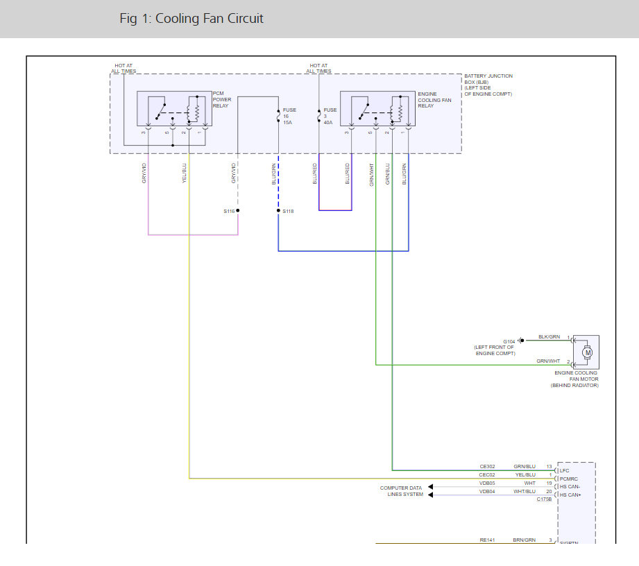

Engine cooling fan not working
2011 FORD FIESTA
120,000 MILES • 1.6L • 4 CYL • 2WD • AUTOMATIC
T41M4DG3

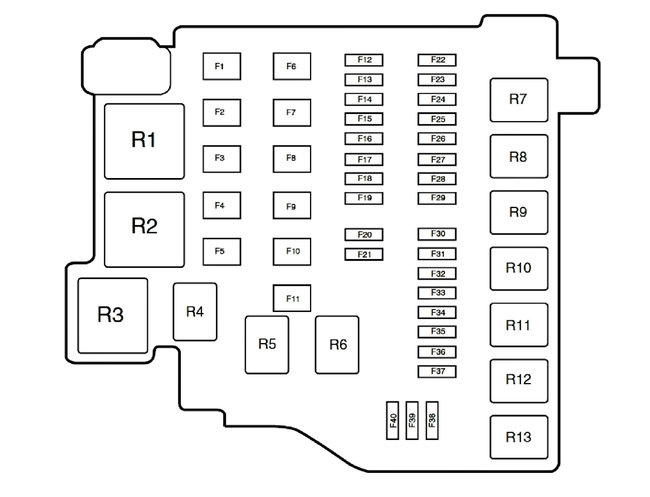

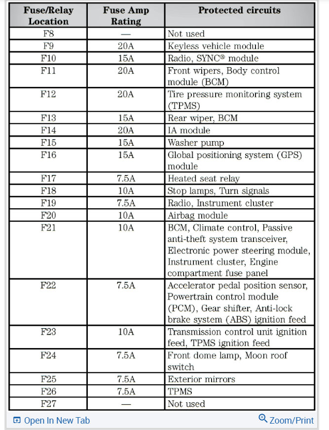

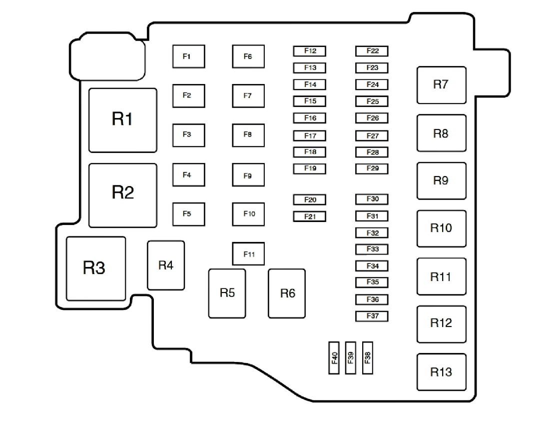

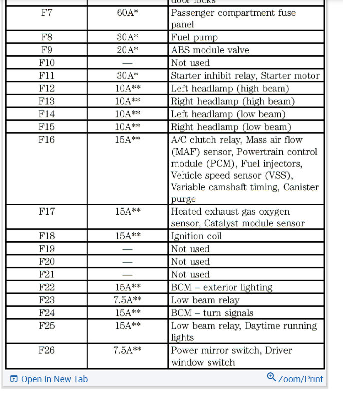

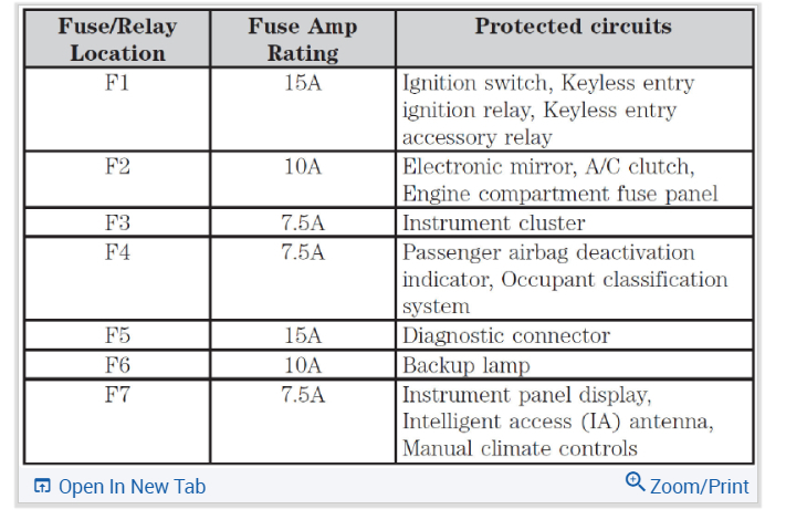

Cooling fan does not come on when A/C is on in turn blows hot air from A/C when not in motion.
Sep 22, 2019 at 5:18 AM
  • 55,433 POSTS

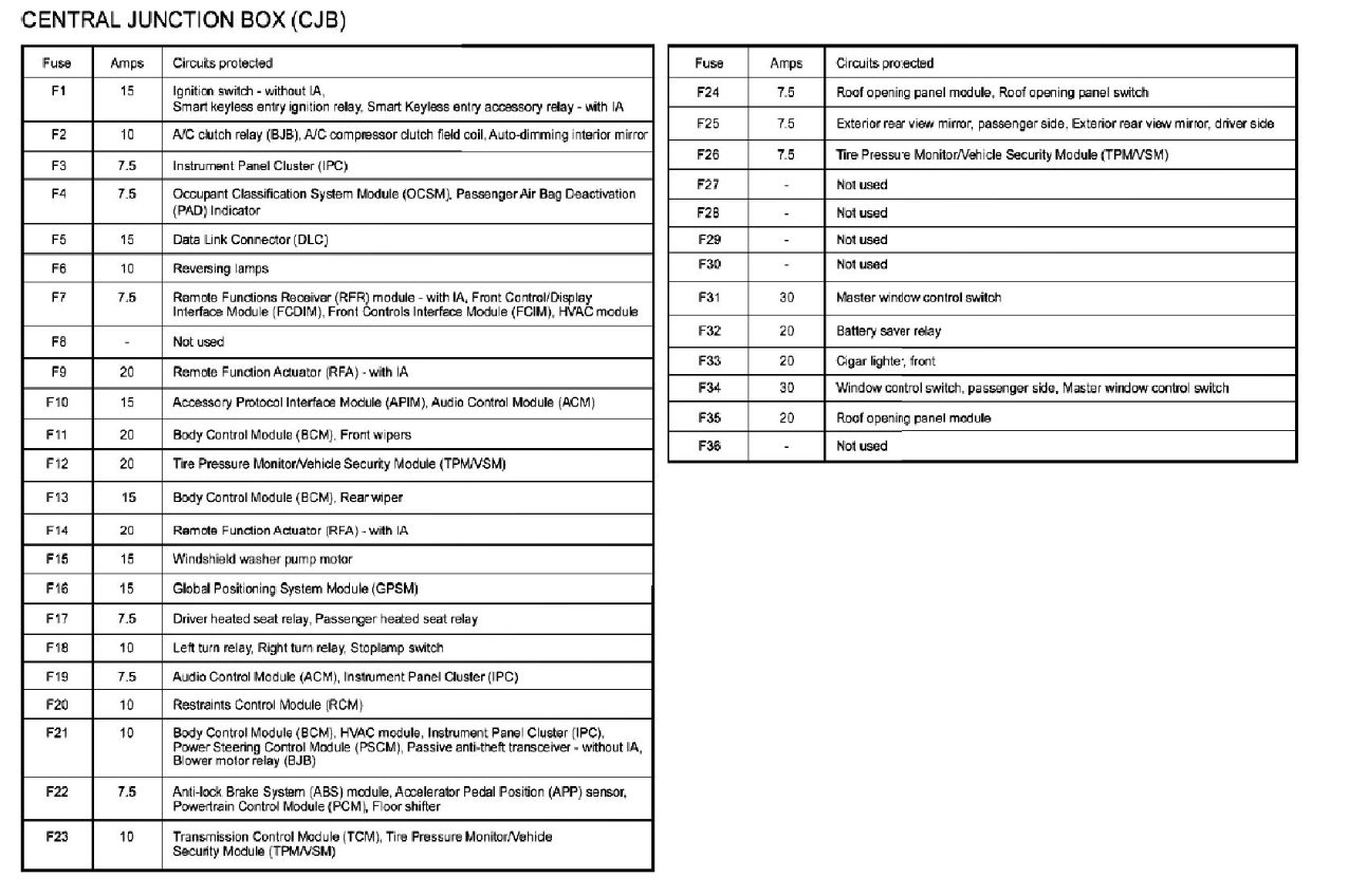

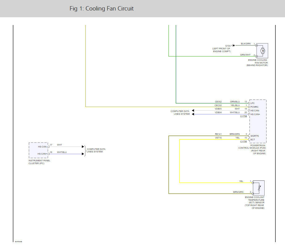

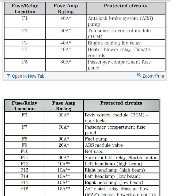

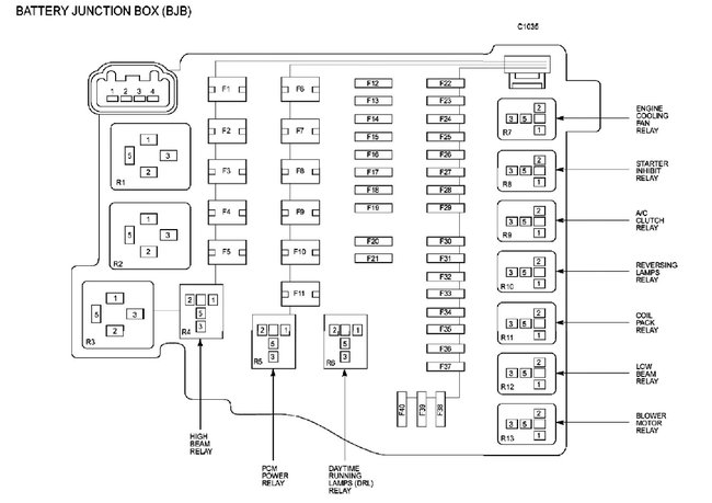

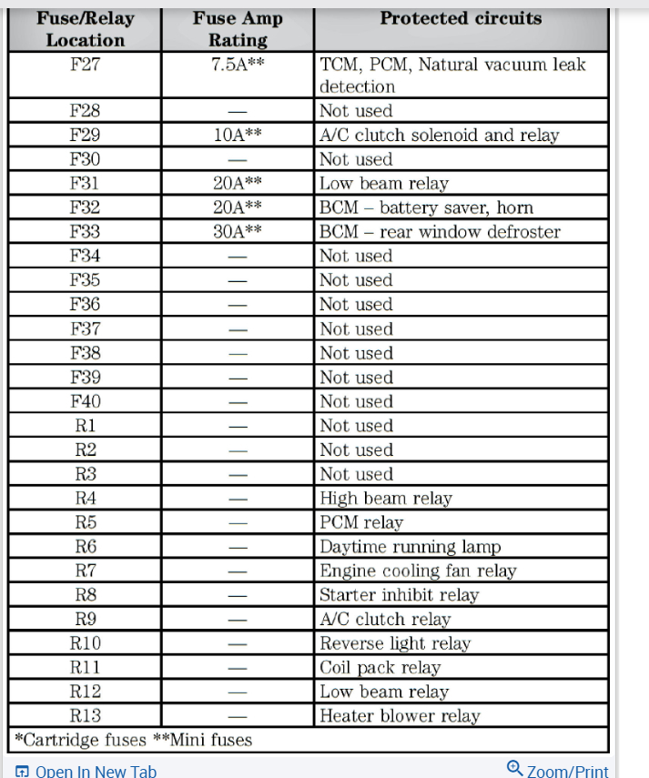

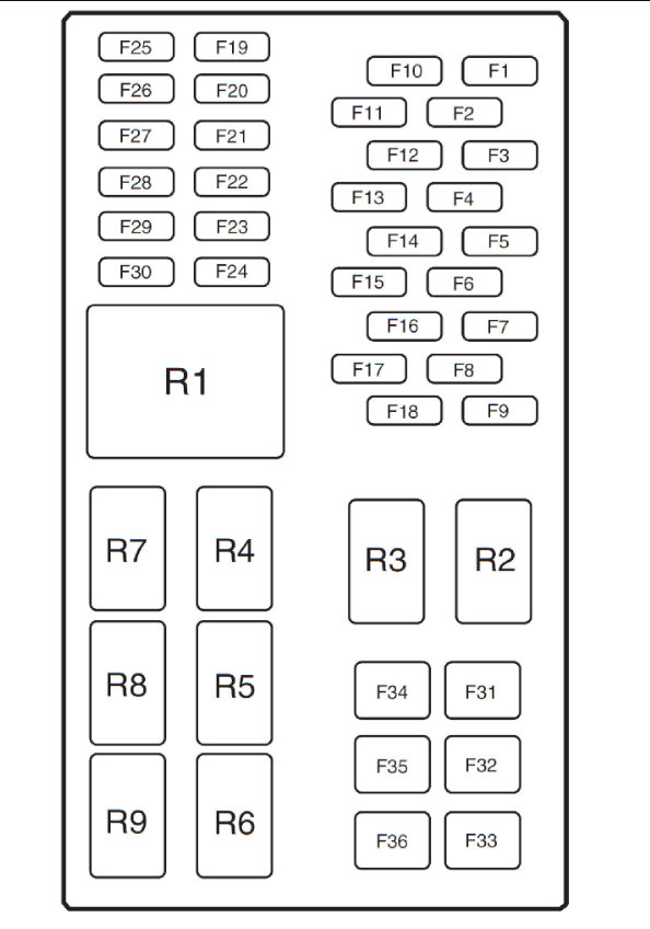

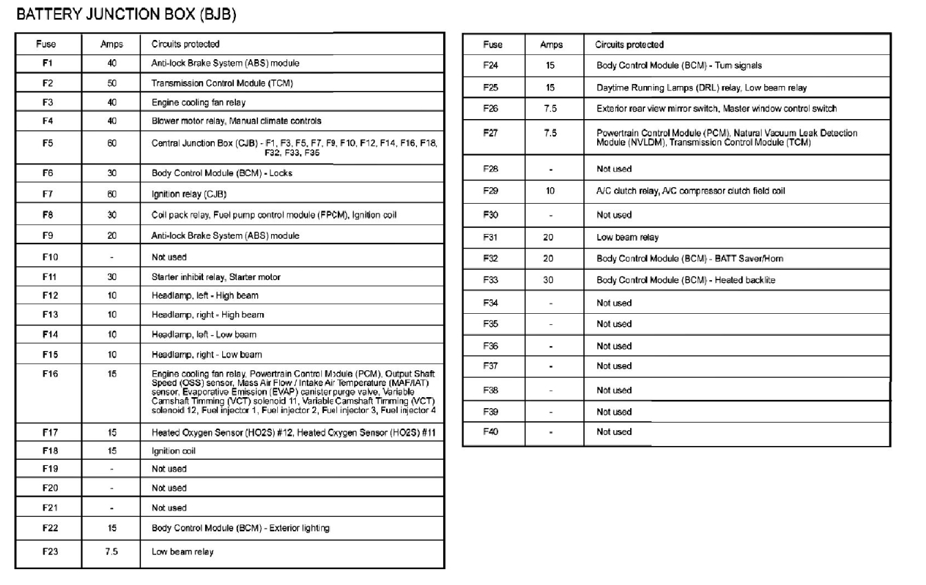

This sounds like the motor or the relay is bad. here are two guides to help us fix the problem with the cooling fan wiring diagrams below with the fuse and relay locations as well with diagrams below to show you your car:
and
https://www.2carpros.com/articles/replace-electric-fan-motor
