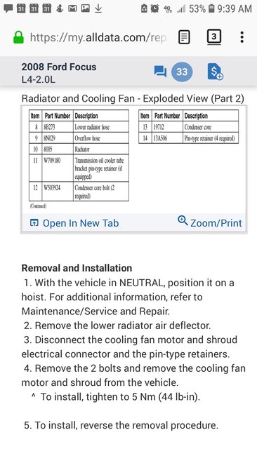

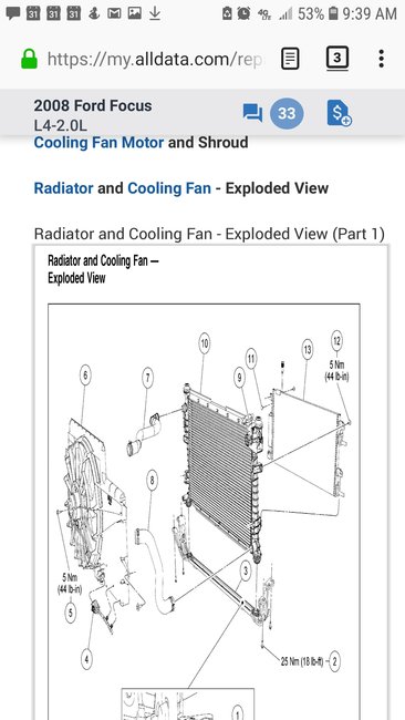

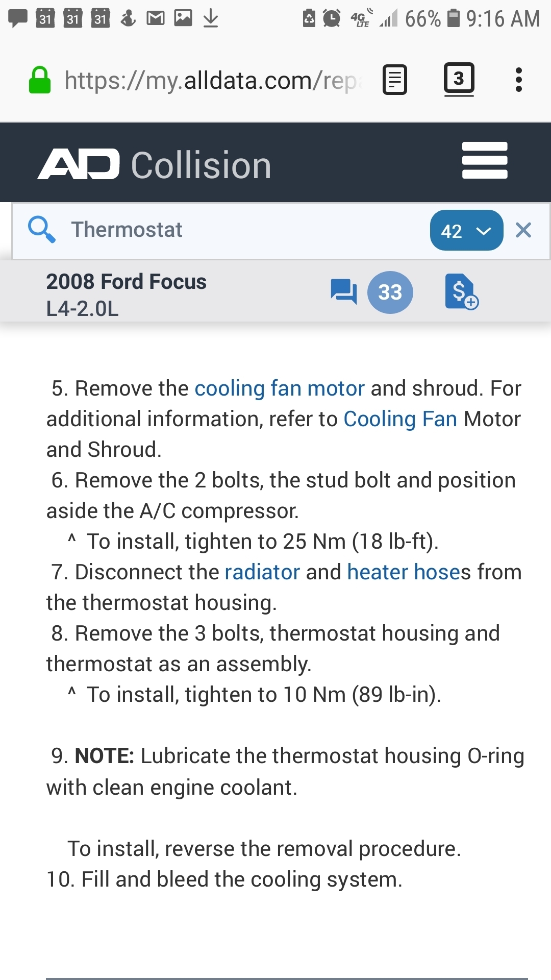

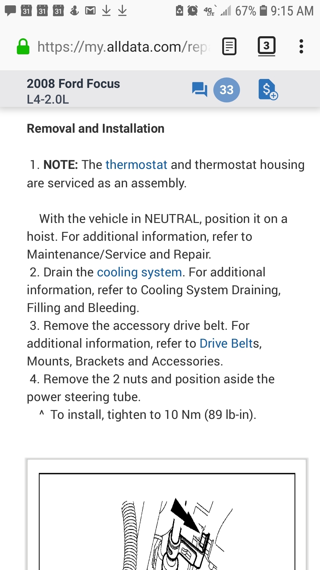

My coolant get boiling then cascade out of the coolant bottle and some vaporized. So I don't know what the real problem is.
Apr 21, 2019 at 9:51 PM
HARRY P
  • 2,292 POSTS

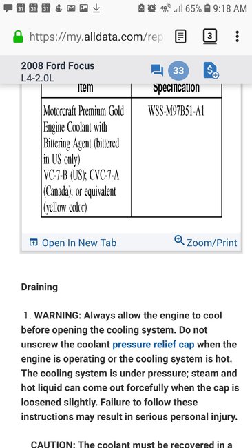

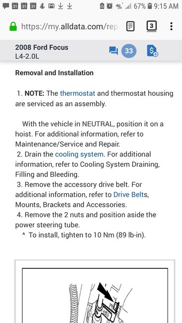

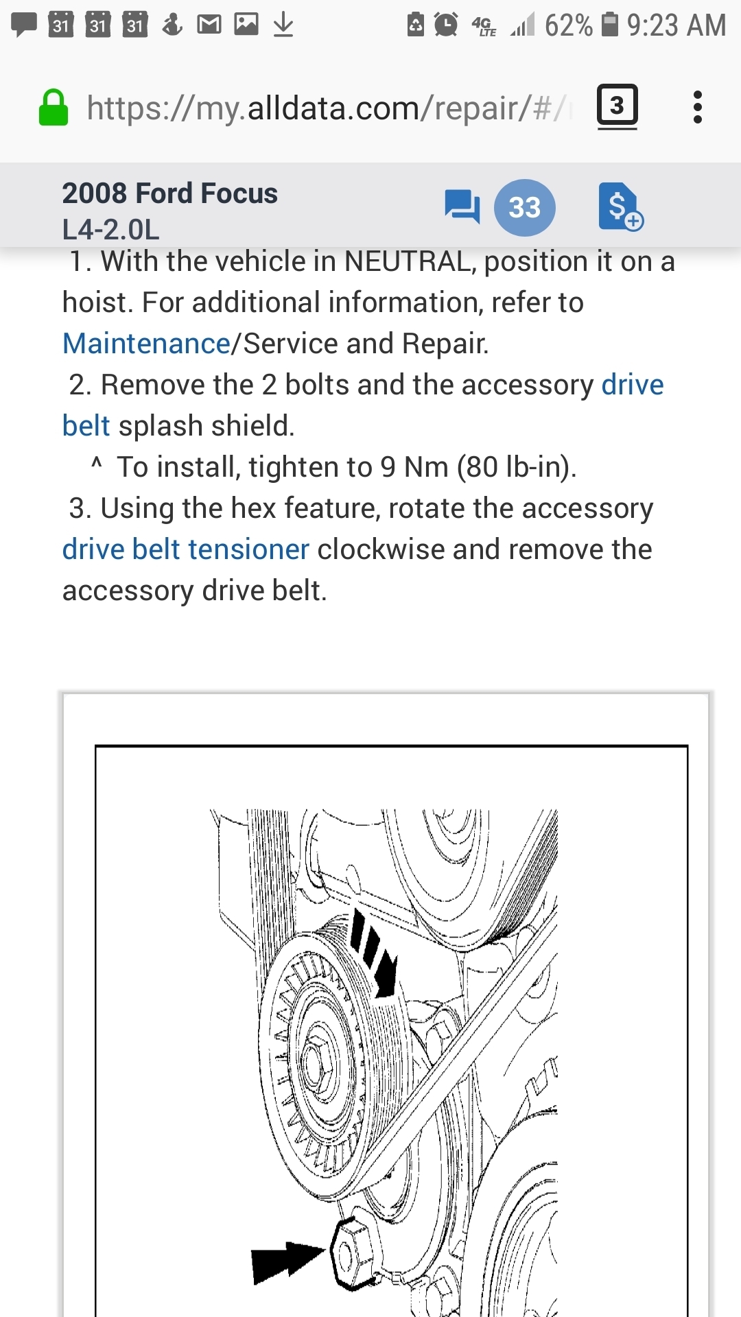

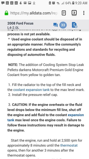

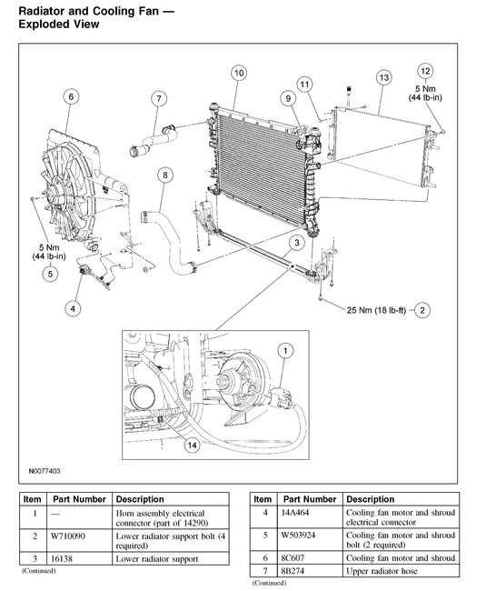

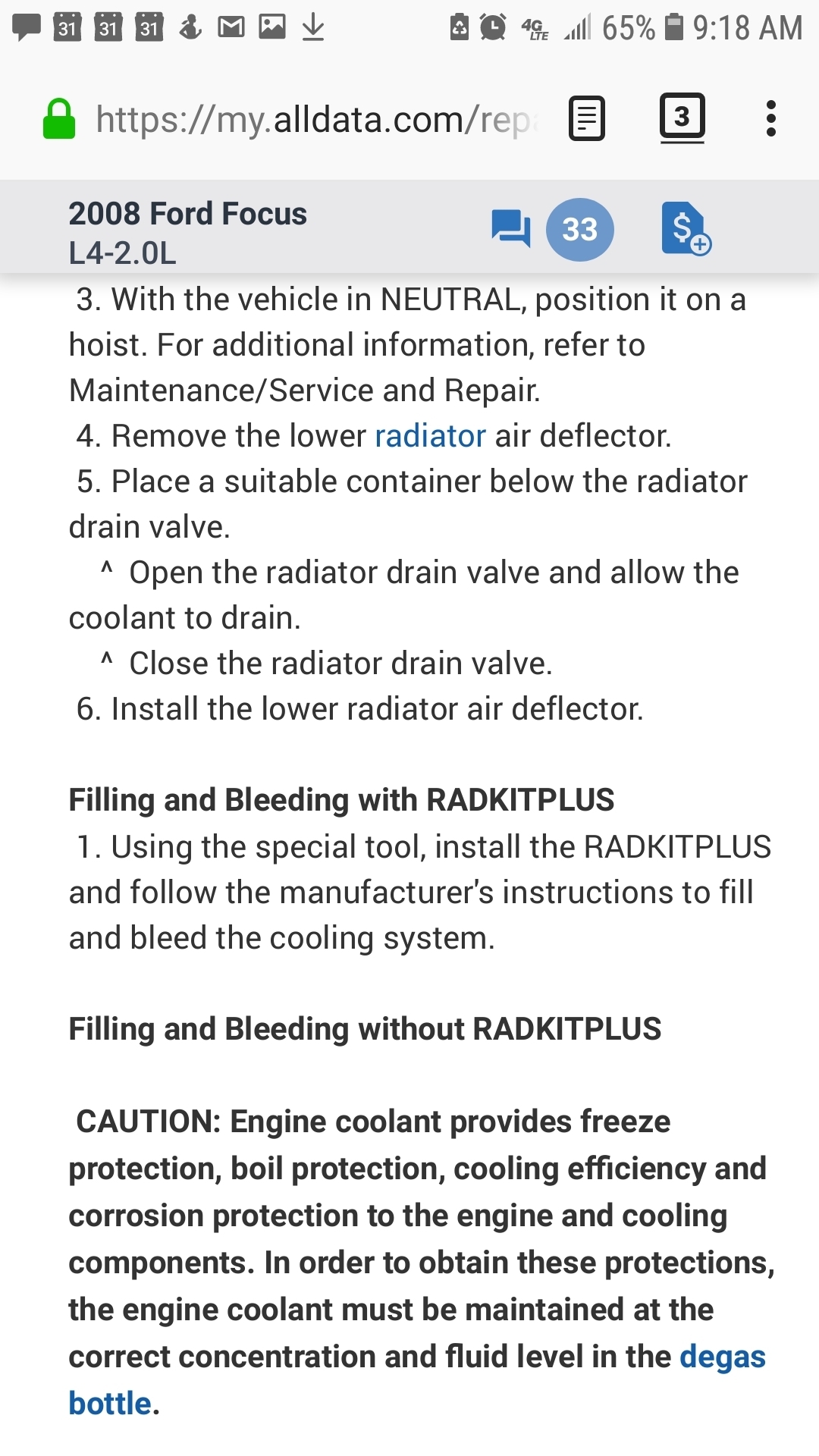

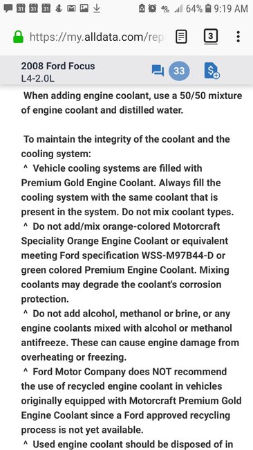

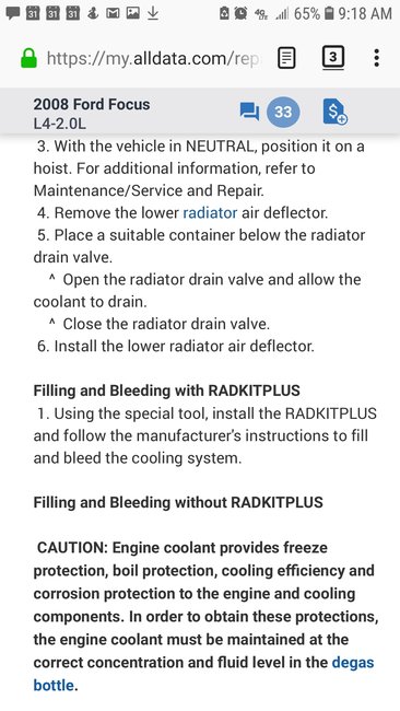

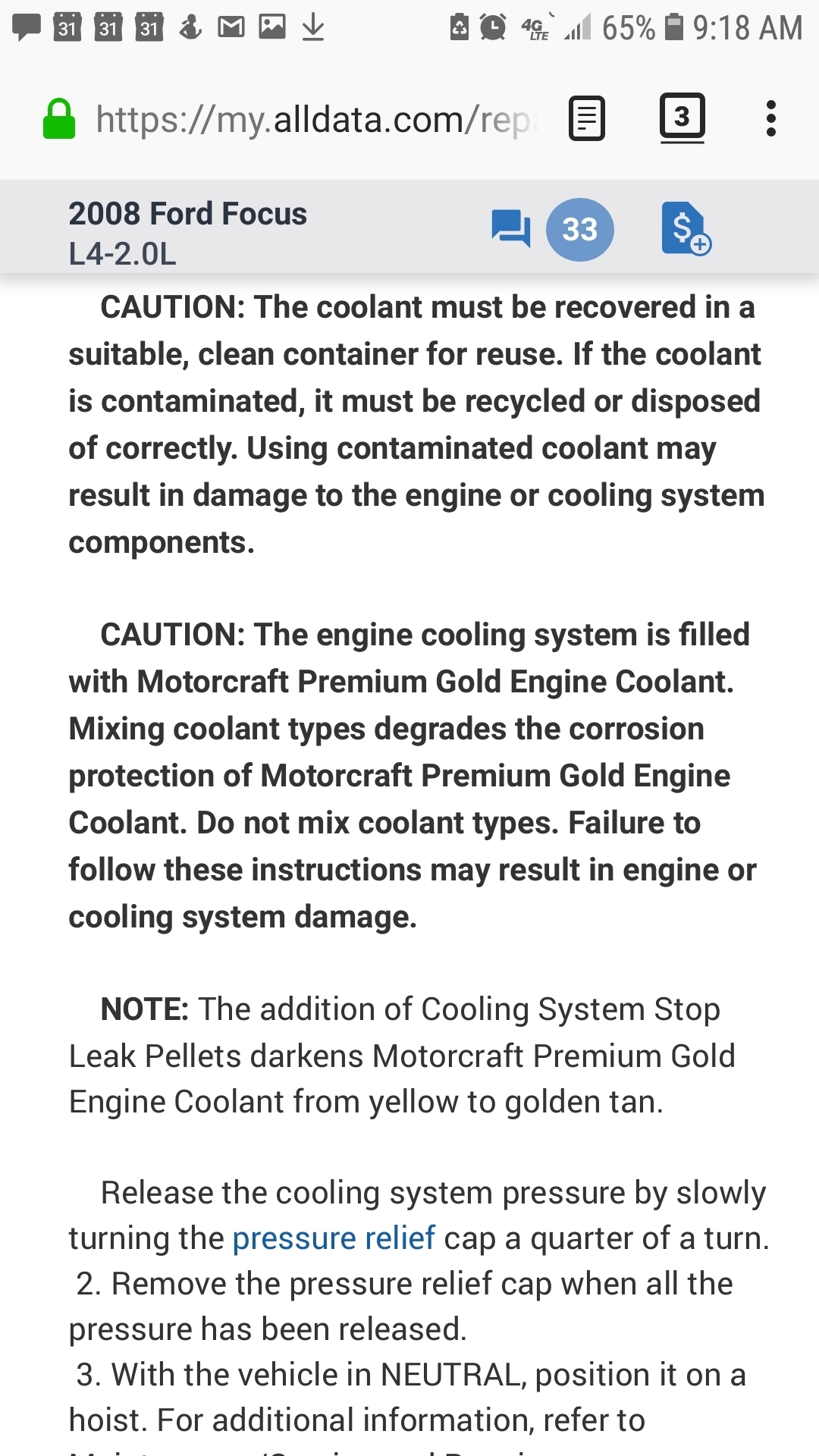

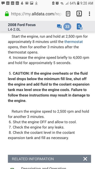

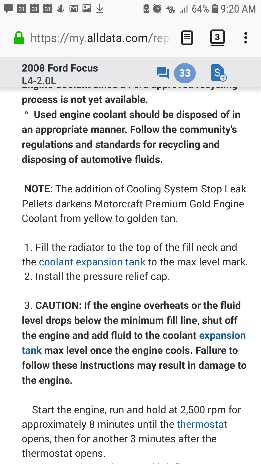

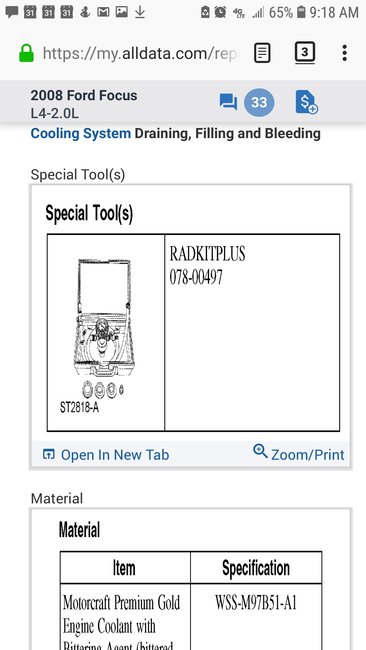

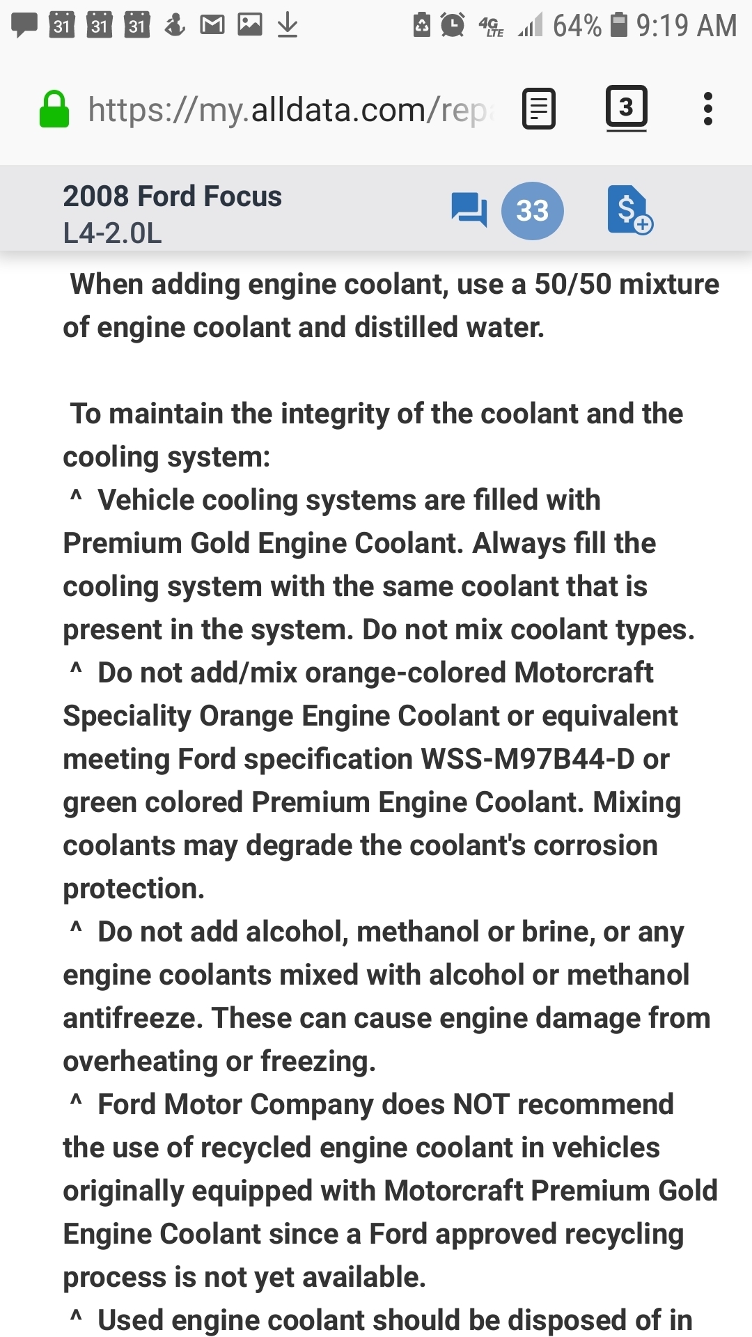

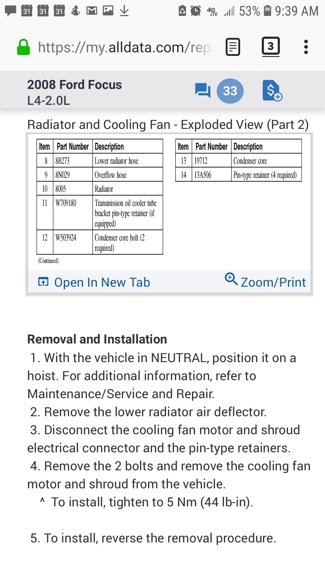

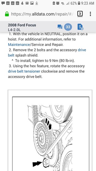

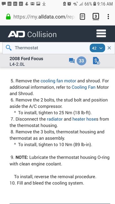

Hello and welcome to 2CarPros. If you can see/hear the electric cooling fan running without the AC running, then I'd bet on a bad thermostat. I'm attaching Alldata's information on how to replace it in the images below. Start there and follow up on this thread and we'll go from there.

I was also think so but why it boiling if it thermostat and both two pipes are hot I mean inlet and outlet pipes

This could be becasue the head gasket is blown lets find out by following these two guides
and
https://www.2carpros.com/articles/engine-overheating-or-running-hot
May 3, 2019 at 6:26 AM
HARRY P
  • 2,292 POSTS
Hmm yes that could be a head gasket issue. Definitely run the test that Ken has laid out. It's easy and cheap enough to do. Also, pull out the oil dipstick and see what the oil looks like. If it looks like a milkshake (muddy,cruddy, whitefish brownish gunk), then you've got either a head gasket issue or an intake manifold gasket issue. This us because when one of those fails, coolant will get by the seals and gaskets and mix in with the oil. If you see this muddy gunk in there, do not drive the car anywhere until it is fixed. Driving it could cause catastrophic engine damage.
