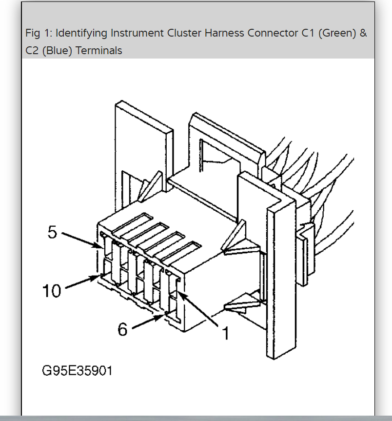

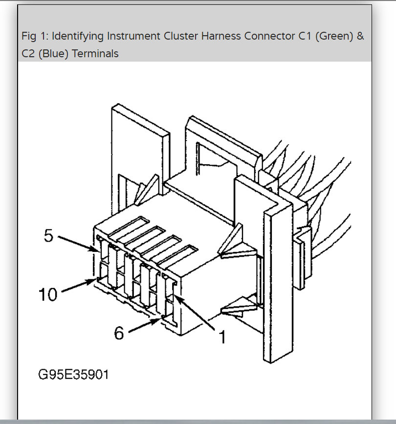

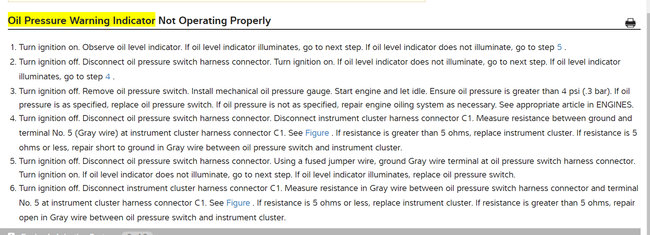

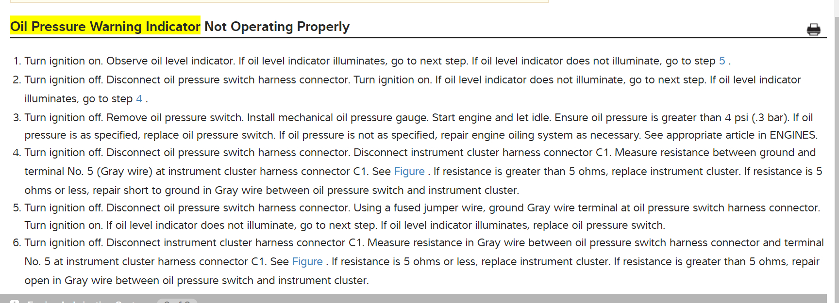

The water in radiator jug boils after I drive a few miles, but carburetor gauge wasn't up past normal. When I stop oil light blinks.
Jul 12, 2019 at 9:58 PM
SCGRANTURISMO
  • 4,897 POSTS
Okay, these might be two separate issue. First I would check to see if your thermostat is opening. Here is a couple of links for you to go to:
https://www.2carpros.com/articles/how-an-engine-thermostat-works
I wouldn't drive until I got these problems diagnosed and fixed. In the diagrams down below I have a factory troubleshooting guide for your vehicle's Oil Pressure Warning Indicator Lamp. Please go through this guide and get back to us with what you are able to find out.
