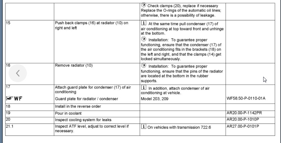

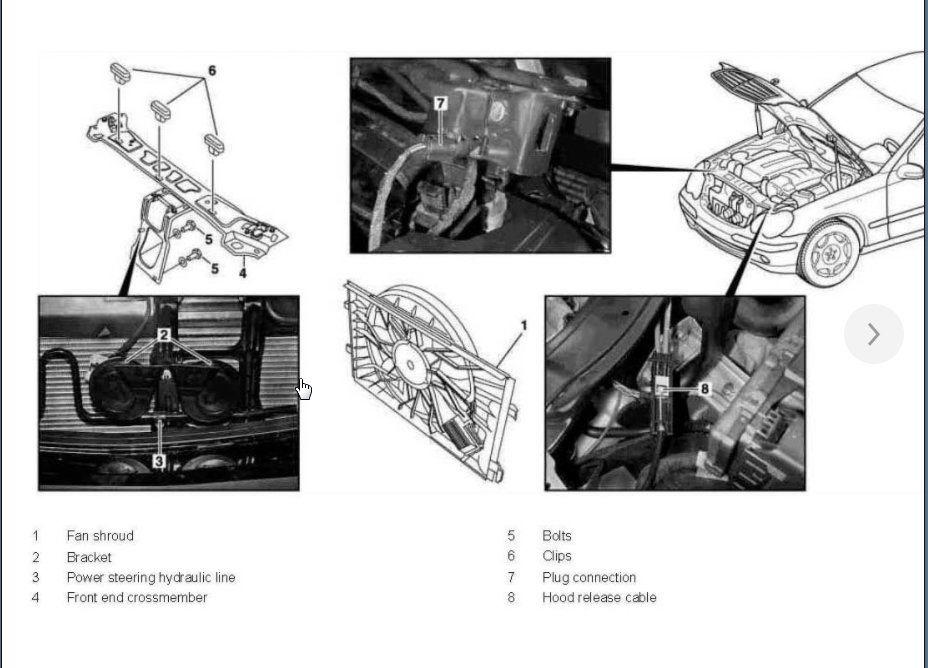

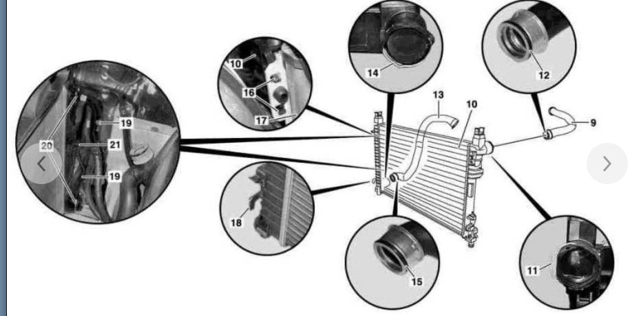

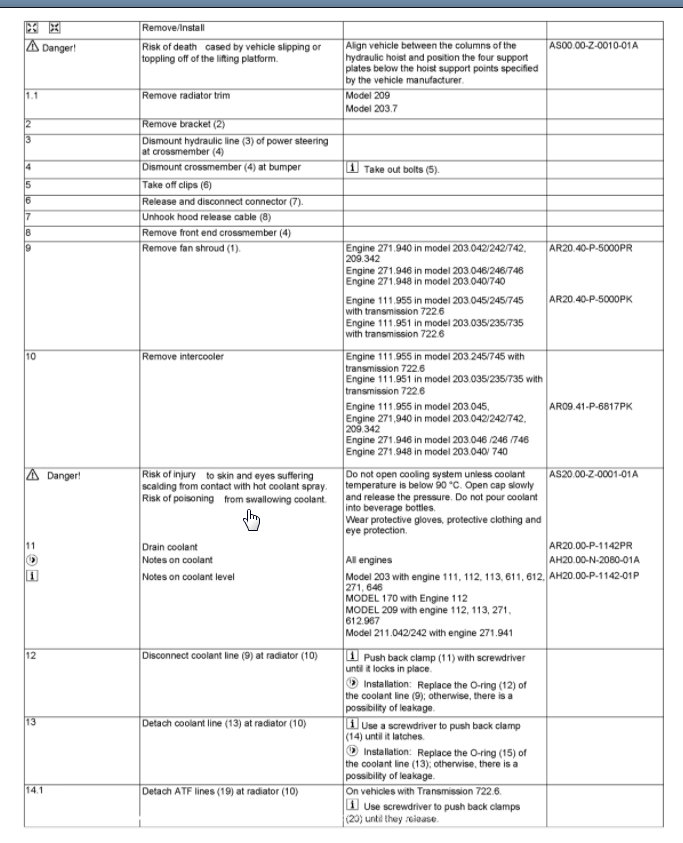

I am attaching the process from the manual on how to install these components and it shows diagrams of how each go together.
Then we need to just fill the system with coolant and start the engine. As it warms up it will pull the coolant into the engine and we will need to top it off. At that point, I would let it cool down and pressure test the cooling system. Here is a guide on how to do that:
https://youtu.be/W8kra65m15c
Once we know there are no leaks we need to run the engine again and make sure the coolant is topped off and you should be good to go.
Let us know if there are other issues. Thanks
