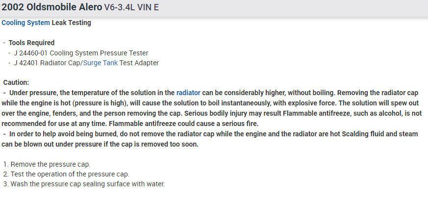

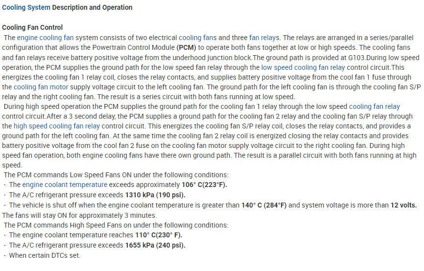

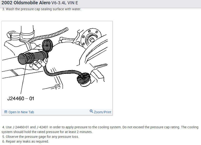

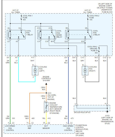

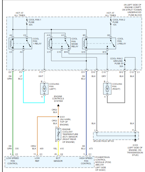

It almost sounds like the cooling fan might not be operating properly. That's why when you are at a stop light air does not flow thru the radiator, then when you get moving it cools back down.
When the car is running check to see if both of the fan come on. Sometimes one fan failure can cause the engine to overheat.
You might also want to make sure the radiator cap is in good condition.
You might find this article helpful:
https://www.2carpros.com/articles/engine-overheating-or-running-hot
I have also attached the cooling fan diagram for your reference.

I noticed overflow cap getting hard to get off, hard to turn.
Oct 26, 2021 at 2:14 AM
SQM
  • 6,383 POSTS
Is it leaking coolant? Many times a bad cap will make the coolant to come out.

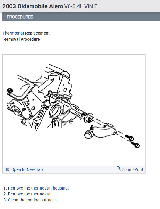

Not running hot but no heat, maybe thermostat?
Nov 24, 2021 at 7:19 AM
SQM
  • 6,383 POSTS

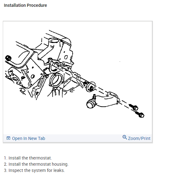

A stuck open thermostat is one of the possibilities. If it is the thermostat then the engine will not reach the operating temperature. Usually, it will show on the temperature gauge.
It can also be due to a clog in the heater core.
Take a look at this article, it has some very helpful information:

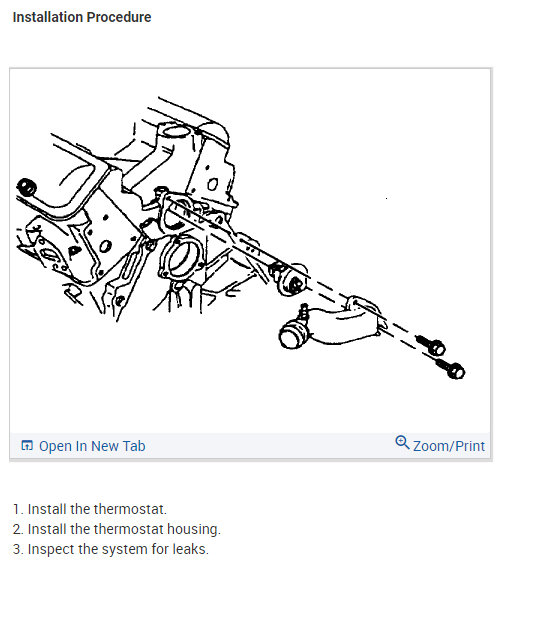

Are you able to confirm if the cooling fan is turning on?
This could be a faulty thermostat. Which can lead to the heat not working. Also, this will create a temperature difference between the upper and lower radiator hose.
So, check the hoses for temperature difference. It is easier if you have an infrared thermostat.
https://www.2carpros.com/articles/how-to-use-an-infrared-temperature-meter
Without checking off a few items off of the list, it will be impossible to know the root cause of the problem.
Jan 23, 2022 at 6:36 AM
MOLLYDAD
  • 28 POSTS
Cooling fans are coming on, don't have Infared thermometer.
Jan 23, 2022 at 6:45 AM
SQM
  • 6,383 POSTS
It is good that the fan is working. But the next step for you would be to check and see if the thermostat is functioning properly. Without knowing that it will be difficult to take the next step.
