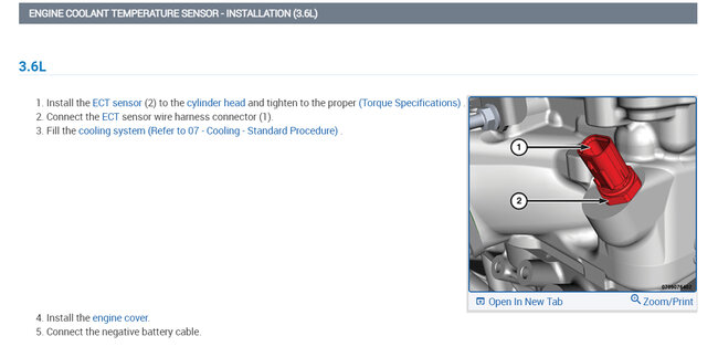

Where is the Engine Coolant Temperature Sensors located?

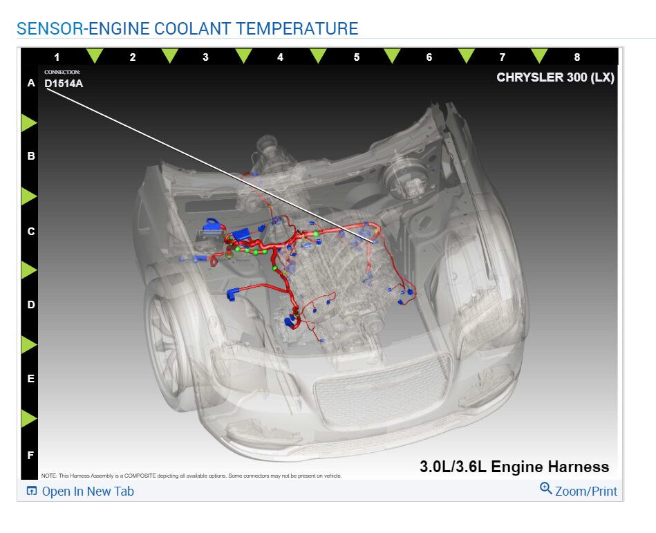

I have the car listed above 300S AWD 8-speed automatic transmission. How do I locate the two Engine Coolant Temperature Sensors?

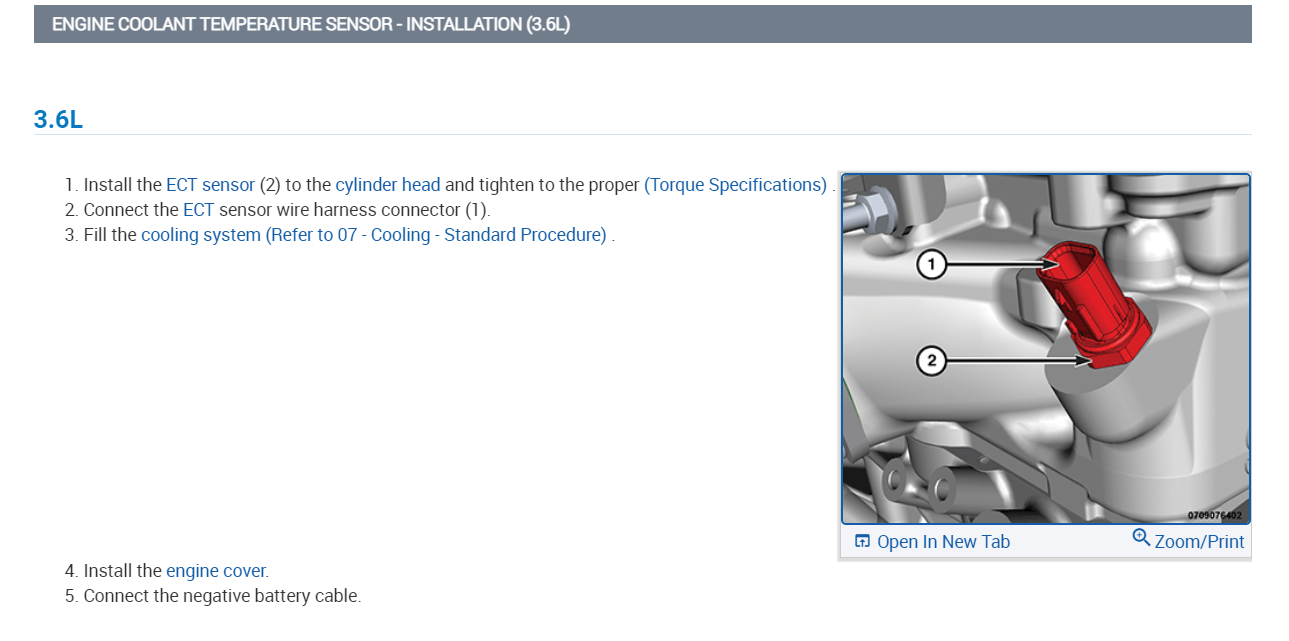

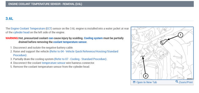

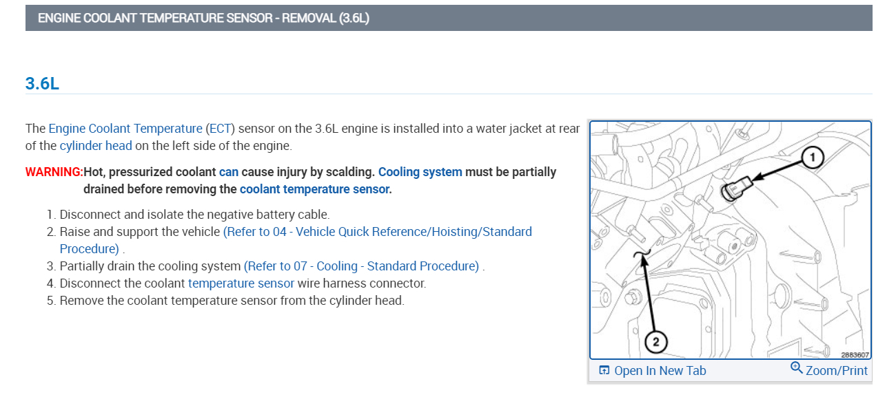

It looks like there is only one engine coolant sensor which is on the left side of the engine toward the rear of the cylinder head. here are the instructions and the location of the sensor in the images below. Please let us know if you need anything else to get the problem fixed.
