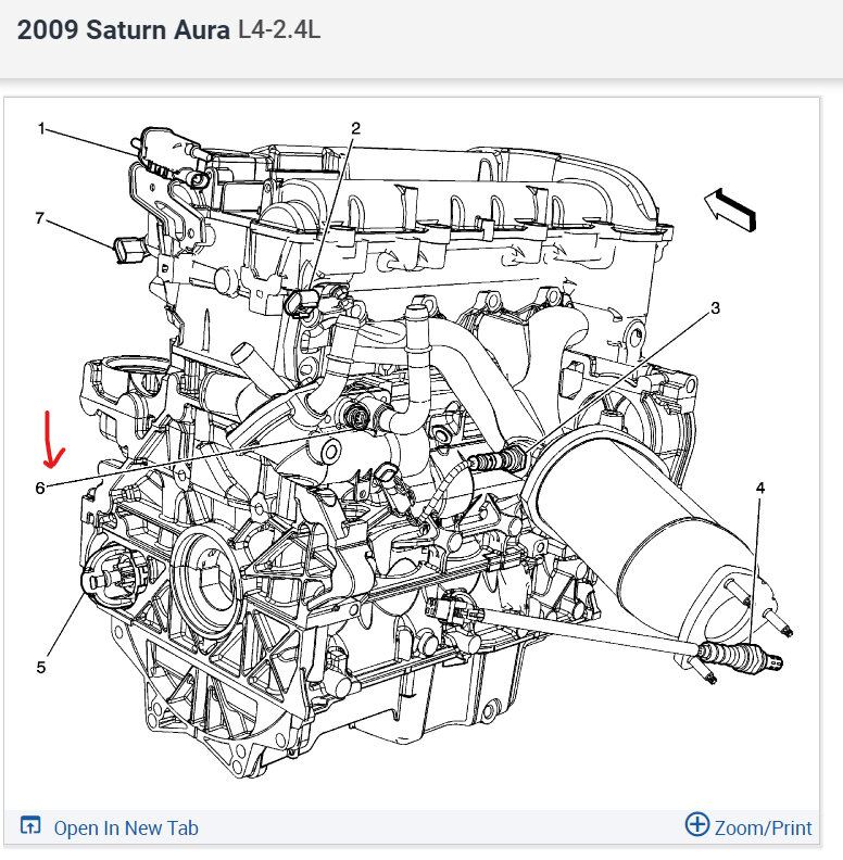

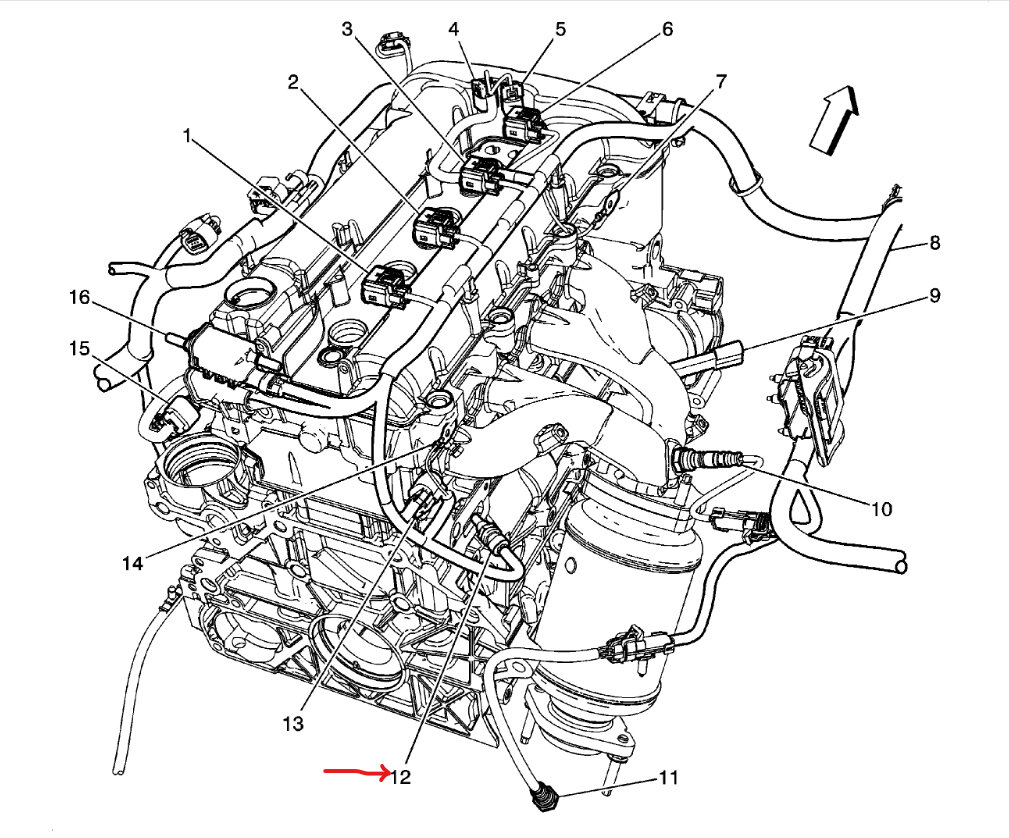

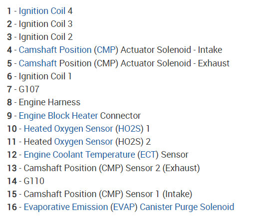

Where is the engine coolant temperature sensor located?
2009 SATURN AURA
9,996 MILES • 2.4L • 4 CYL • 2WD • AUTOMATIC
BDESGM
Received P0128 obdII code. Dec. 2023 installed new motor.
Oct 5, 2024 at 3:09 AM
  • 55,395 POSTS
This could be a bad thermostat, stuck open all the time FYI.
The P0128 code on your 2009 Saturn Aura indicates that the engine coolant temperature is below the thermostat regulating temperature.
Here is the location of the engine coolant temperature sensor. Check out the images (below). Let us know how it goes.
