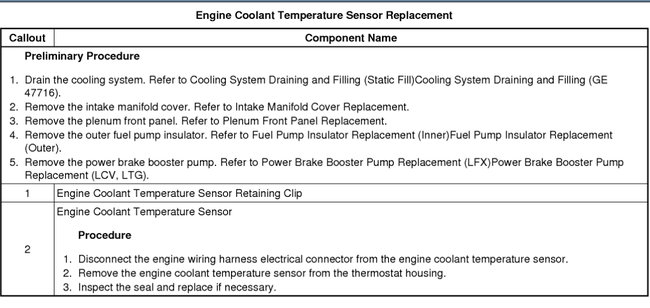

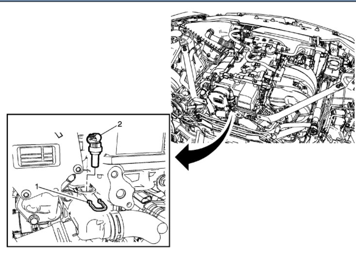

Just replaced thermostat on the car listed above on 12/4/2020. Getting no reading on the dash gauge, and the needle remains on cold setting under normal driving conditions. However, getting a dash warning the A/C is turned off due to hot engine. The fan runs for about 5-10 minutes even after a 3-minute drive. Could this be an engine coolant temperature sensor failure?

Yes, that sounds like you could be having an issue with the coolant temperature sensor. Here is a tutorial for you to view on the sensors replacement:
https://www.2carpros.com/articles/symptoms-of-a-bad-coolant-temperature-sensor
https://www.2carpros.com/articles/coolant-temperature-sensor-cts-replacement
I've attached 2 pictures below of the location and steps for replacement for your car. Hope this helps and thanks for using 2CarPros.
