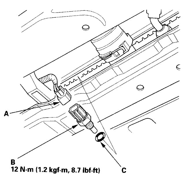

Engine Coolant Temperature sending unit location
137,000 MILES • 4 CYL • 2WD • AUTOMATIC
ALEX11303
Replaced thermostat. You can see fluid shooting out the backside.
Oct 14, 2019 at 3:06 AM
DANNY L
  • 5,648 POSTS
Hello, I'm Danny.
The coolant temperature sensor is located in the radiator.See picture attached below. Are saying the leak is from the thermostat housing or were you just looking for the coolant temperature sensor?Hope this helps and thanks for using 2CarPros.
