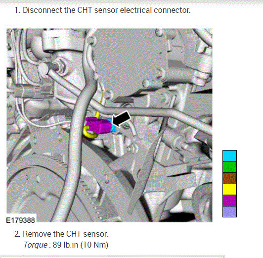

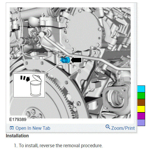

overheat problem.
i needs know location of engine coolant temperature sensor.
Aug 13, 2021 at 12:37 PM
Experienced Mechanic
110,246 POSTS

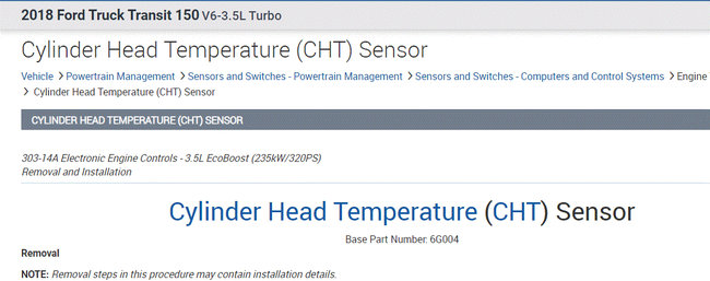

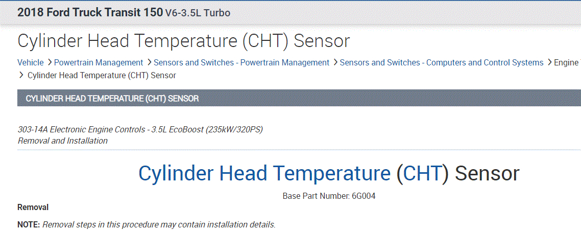

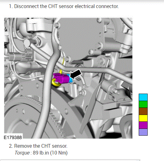

This vehicle has a cylinder head temperature sensor (CHT). The sensor is located on the rear of the right cylinder head.
If you look at the attachments below, they provide the directions for removal and replacement.
