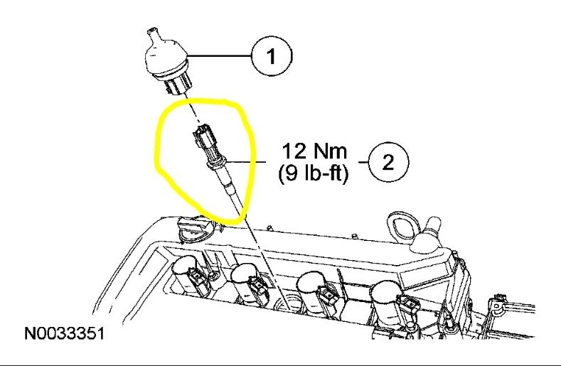

Where is the engine coolant temperature sensor location on the car listed above with a 2.0 tdci?
Dec 15, 2019 at 12:34 AM
Experienced Mechanic
110,248 POSTS
The sensor is on top of the head. See the attached picture for location. Here is a link to help with replacing an coolant temperature sensor:
https://www.2carpros.com/articles/coolant-temperature-sensor-cts-replacement
Let me know if this helps.
