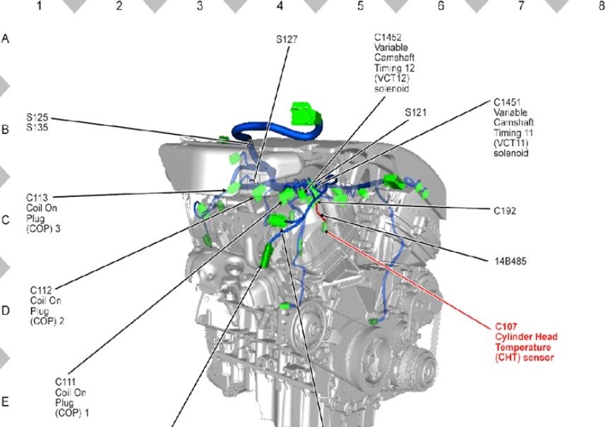

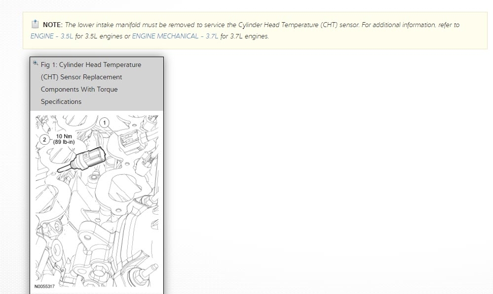

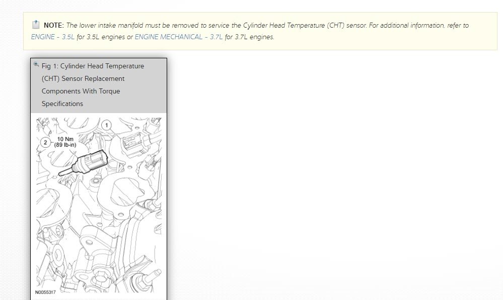

I need the engine coolant sensor location . Also need replacement instructions.

The intake must be removed to access the sensor, I've attached some illustrations that should help you out. Check out the diagrams (Below). Please let us know if you need anything else to get the problem fixed.
