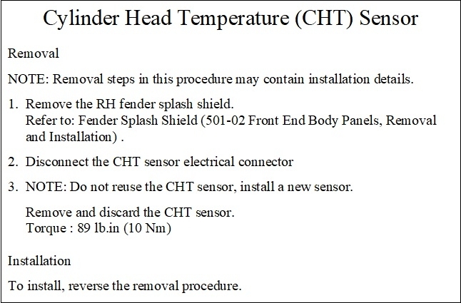

Where is the engine coolant sensor location for a 2020 Lincoln Nautilus reserve?
The engine coolant over temperature light is coming on but the car was not on prior for it to be overheating.

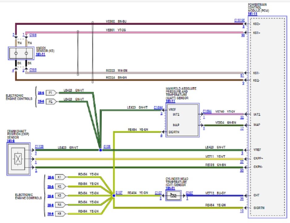

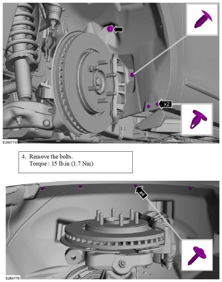

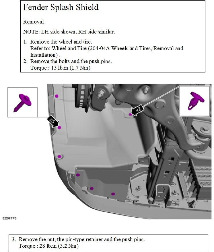

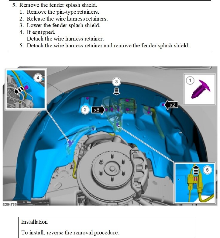

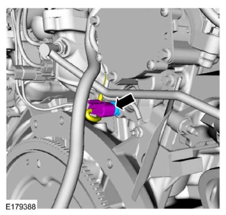

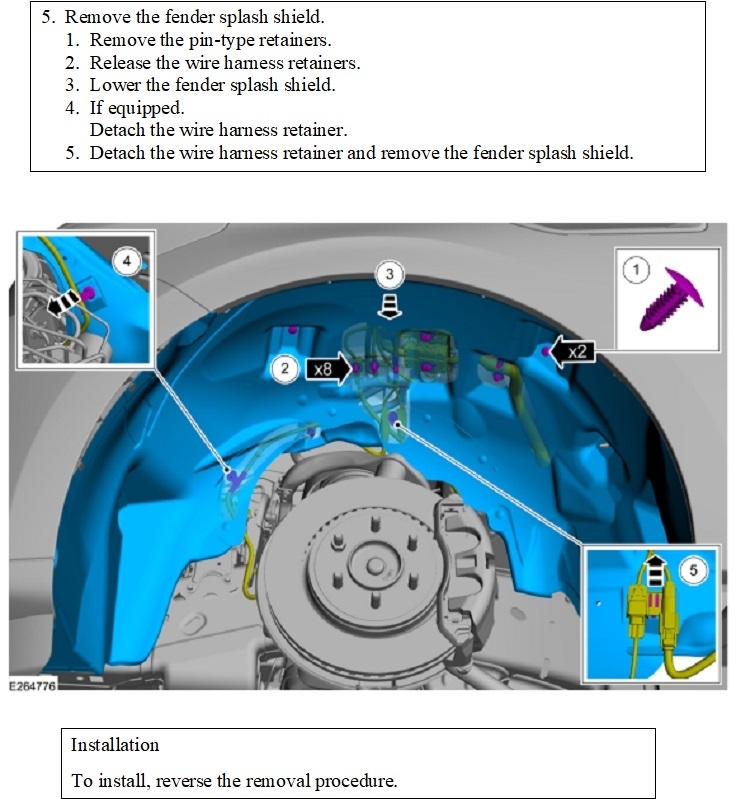

Ford no longer uses a coolant temperature sensor. Here's the procedure for the cylinder head temperature sensor for a 3.5L engine.
