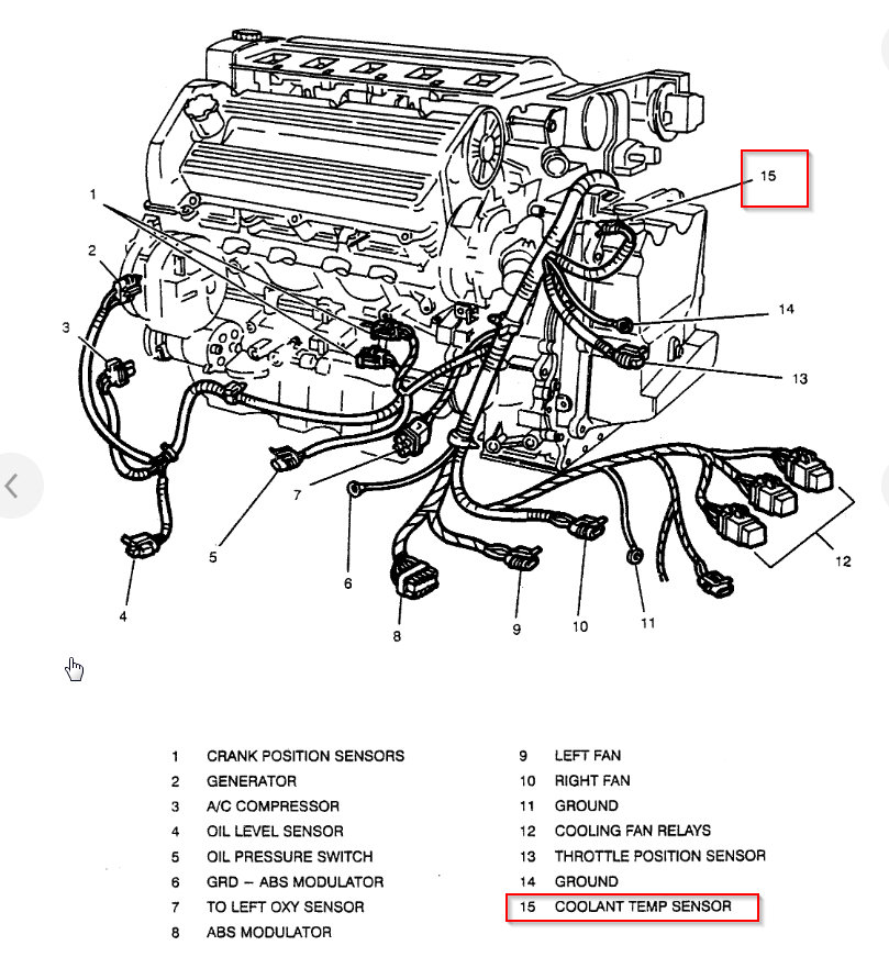

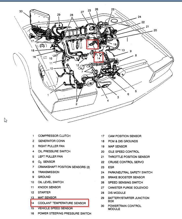

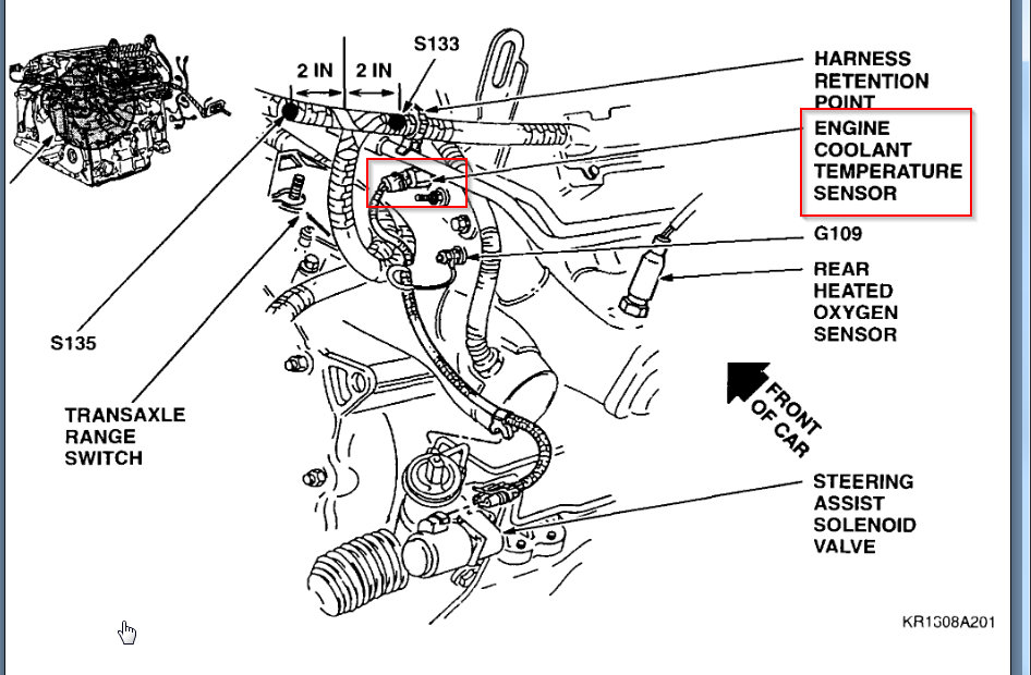

engine coolant sensor location
1994 CADILLAC STS
160,000 MILES • 4.6L • V8 • 2WD • AUTOMATIC
ROBERTAUTRYWHITMORE
I need location of engine coolant sensor.
Apr 19, 2020 at 12:38 PM
I attached a couple of views of it. Looks like it is just under the throttle body on the front of the engine. Let me know if you still can't find it and we can see about getting more detail. Thanks
