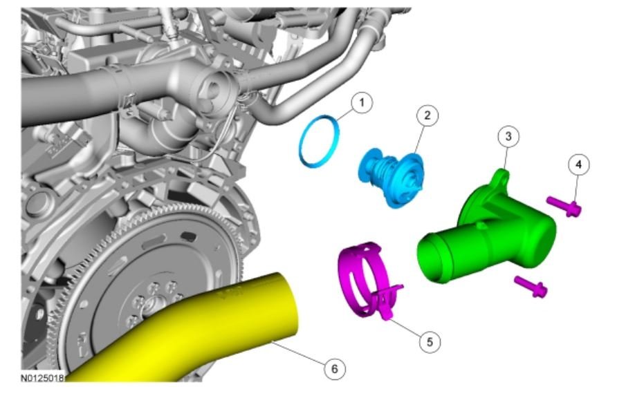

My vehicle has not consistently blown heat for about a month. Today the "engine coolant over temperature " displayed. There are no visible leaks.

Good evening,
If the coolant is full and is overheating then a good chance the thermostat is is bad and needs to be replaced.
https://www.2carpros.com/articles/engine-overheating-or-running-hot
Removal
image WARNING: Before beginning any service procedure in this section, refer to Safety Warnings in Section 100-00 . Failure to follow this instruction may result in serious personal injury.
NOTICE: Use Motorcraft® Orange Antifreeze/Coolant. Do not mix coolant types. Mixing coolant types degrades the coolant corrosion protection and may damage the engine or cooling system.
NOTE: During normal vehicle operation, Motorcraft® Orange Antifreeze/Coolant may change color from orange to pink or light red. As long as the engine coolant is clear and uncontaminated, this color change does not indicate the engine coolant has degraded nor does it require the engine coolant to be drained, the system to be flushed, or the engine coolant to be replaced.
Drain the cooling system. Refer to Cooling System Draining, Filling and Bleeding .
Remove the ACL outlet pipe. REFER to Section 303-12, Intake Air System Components - Exploded View .
Remove the 2 bolts and position the coolant inlet connection aside.
Remove the thermostat and the O-ring seal.
Discard the O-ring seal.
Installation
Install a new O-ring seal and the thermostat.
Lubricate the O-ring seal with clean engine coolant.
Position the coolant inlet connector and install the 2 bolts.
10 Nm (89 lb-in).
Install the ACL outlet pipe. REFER to Section 303-12, Intake Air System Components - Exploded View .
Fill and bleed the cooling system. Refer to Cooling System Draining, Filling and Bleeding .
