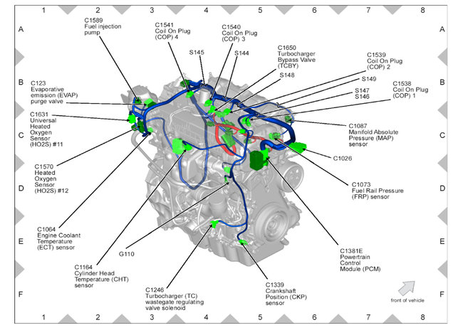

I recently replaced my alternator and when I start the car it runs fine for the first two or three minutes. Then I receive an error that my coolant temperature is too high and the car shuts off. It starts right back up and runs or a minute or two again then shuts off. I checked the belt, its ran properly, all the pulleys are moving properly. Could it be the coolant temperature sensor? I just ordered and OBDII scan tool should be here Friday so I don't have any codes yet.

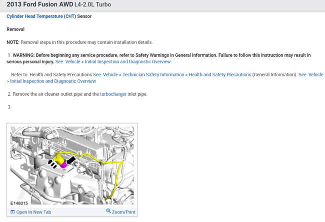

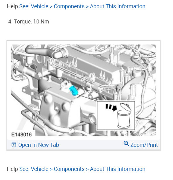

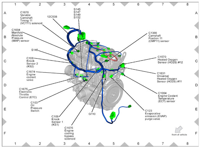

It sounds like the temperature sensor has gone bad. Here is guide to walk you through the steps of changing it and the sensor location for your car and instructions below:
https://www.2carpros.com/articles/coolant-temperature-sensor-cts-replacement
