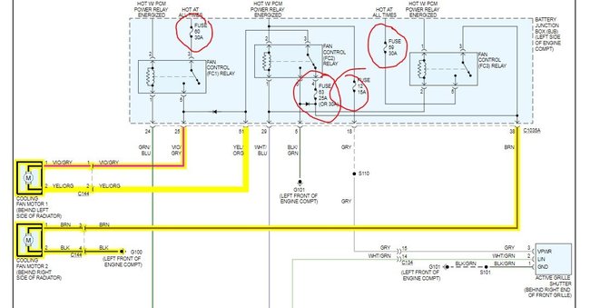

Okay, does the cooling fan come on when it gets hot? It should come on at 208 degrees.
I attached a wiring diagram of the fan for you. Check the fuse for the fan and also check for voltage to the fan when it gets hot.
