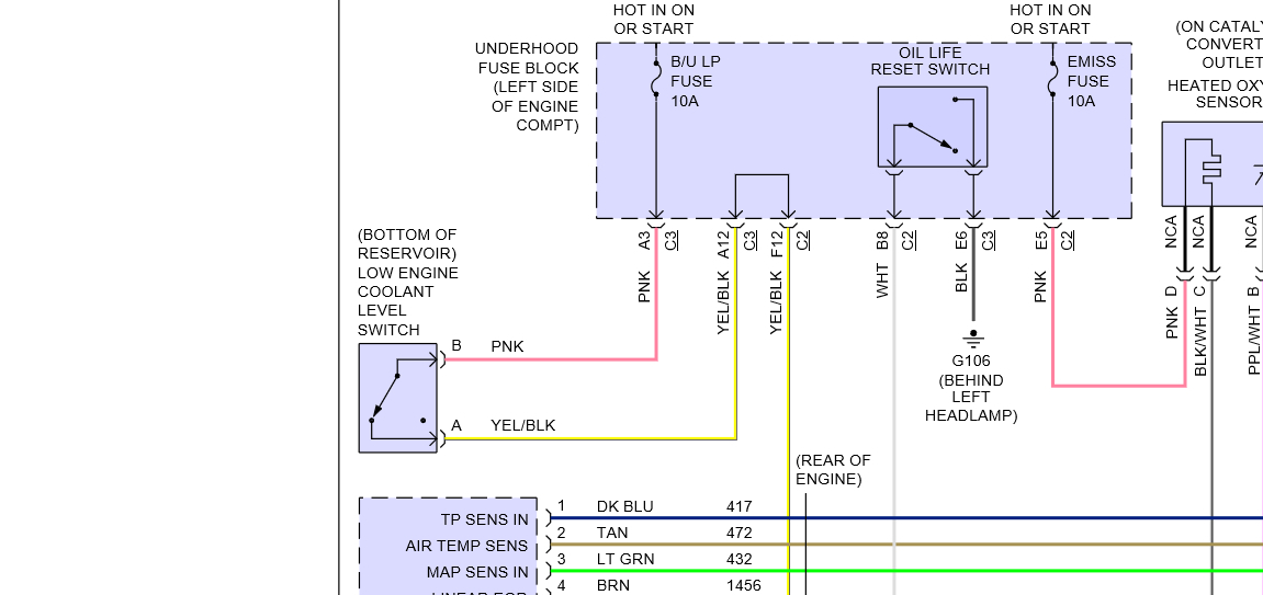

my engine coolant light is staying on. The reservoir is full. What can some of the causes be?

The switch for the coolant level is actually at the bottom of the coolant reservoir. So you may want to take a look at the bottom of the tank and see if the harness plug either fell off or if there is a wiring problem down there. The pink wire at the plug for the level switch is the power wire and the yellow/black wire is the wire that signals the ECM that the switch is closed and the reservoir is full. here is a wiring diagram to help to identify the harness plug down there. Should be very easy to find.

The car is not overheating correct?

There is probably air pockets in the radiator and engine block, run the engine with the radiator cap off until the thermostat opens and you will see the coolant in the radiator drop, the add more until it is full. You have to get all the air out, there also may be a bleeder near the thermostat housing that you can unscrew to allow air to escape. The coolant sensor will not read air only fluid, I am not sure which light you have on, the level sensor or the actual coolant temperature sensor.
