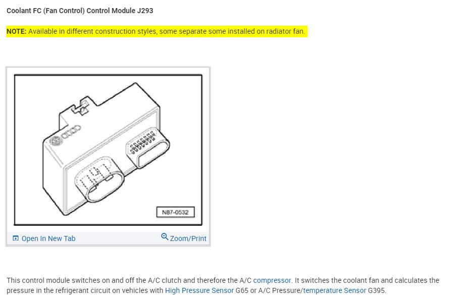

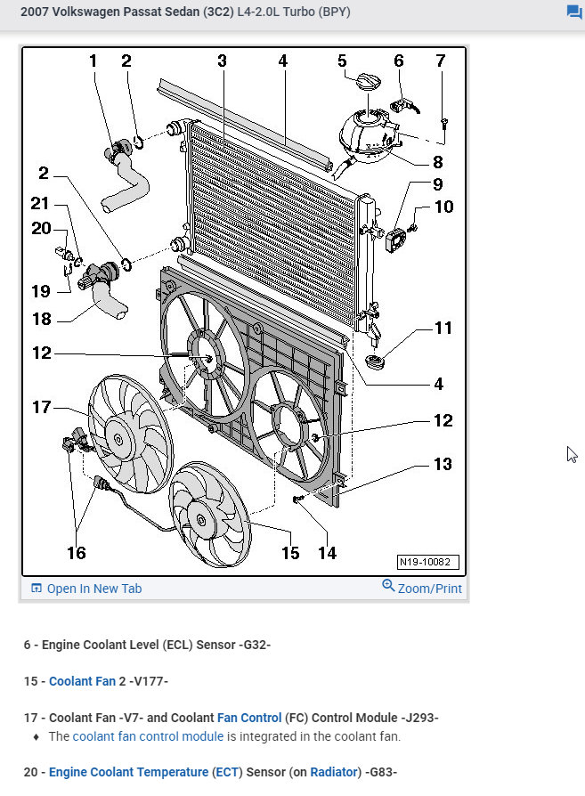

Where is it located?
Aug 25, 2019 at 1:56 AM
Experienced Mechanic
18,907 POSTS
Hi Treveor,
Please see the attached information for the location of this module. Let me know if you need anything else. Thanks
