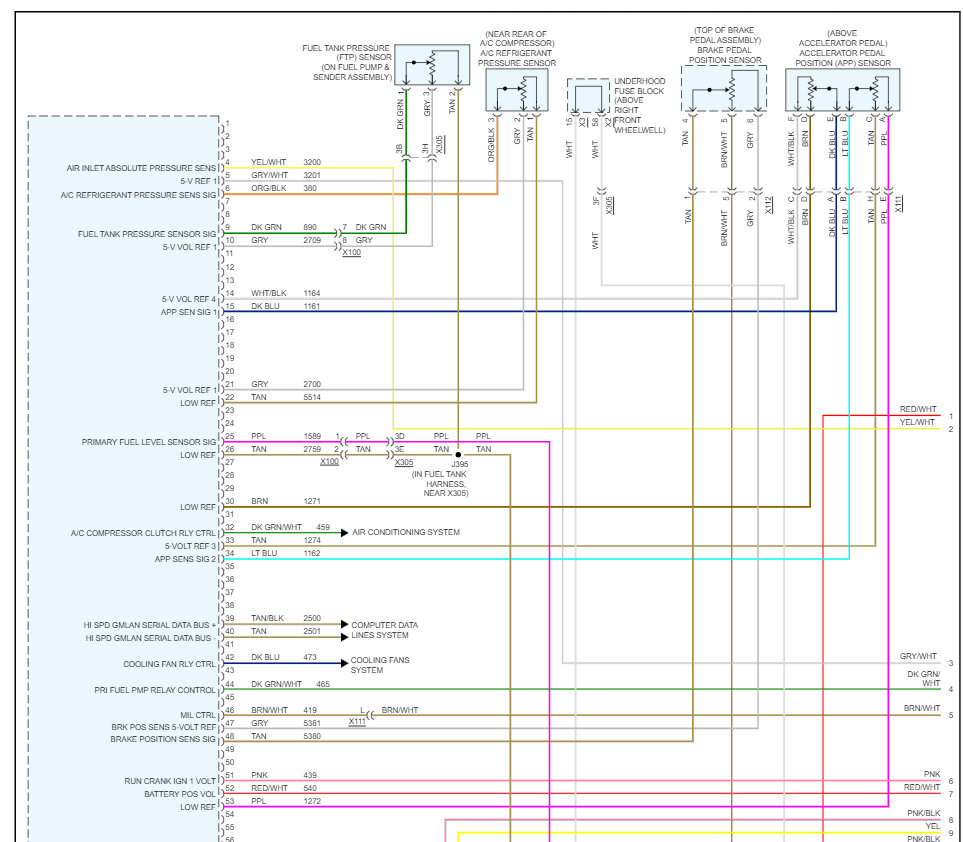

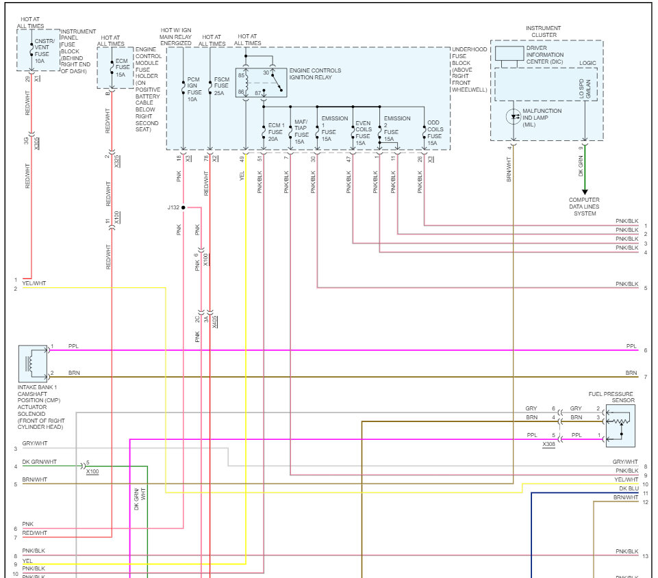

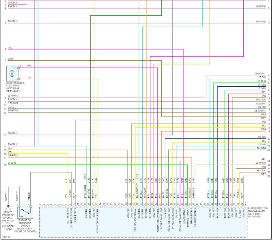

Please can I have the power and ground input to the ECU. The ECU fuse keeps blowing each time I cycle the key to ACC position. I need the ECU diagram for power and ground which are responsible for powering the ECU.
Jun 15, 2023 at 9:13 AM
  • 55,381 POSTS

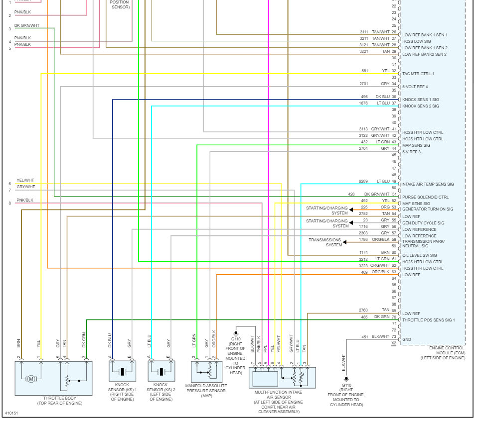

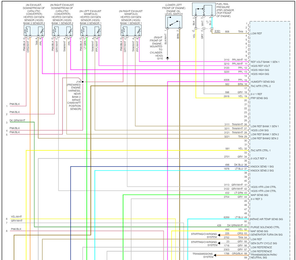

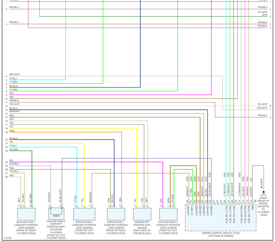

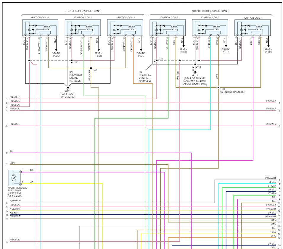

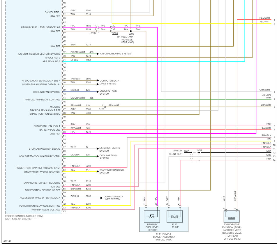

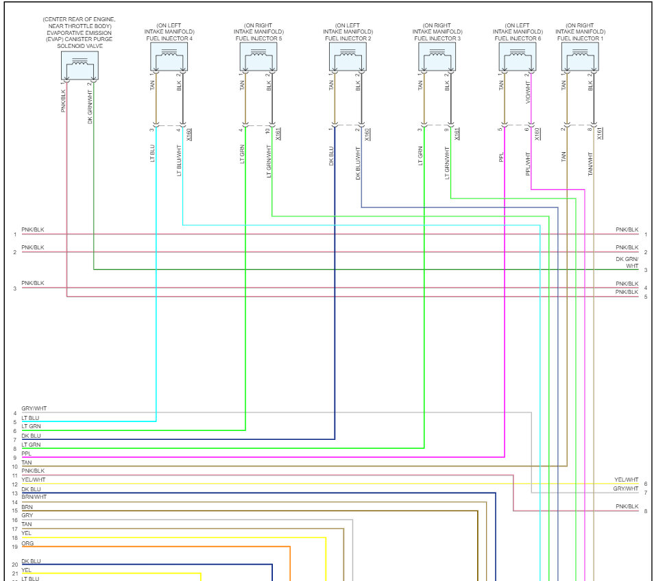

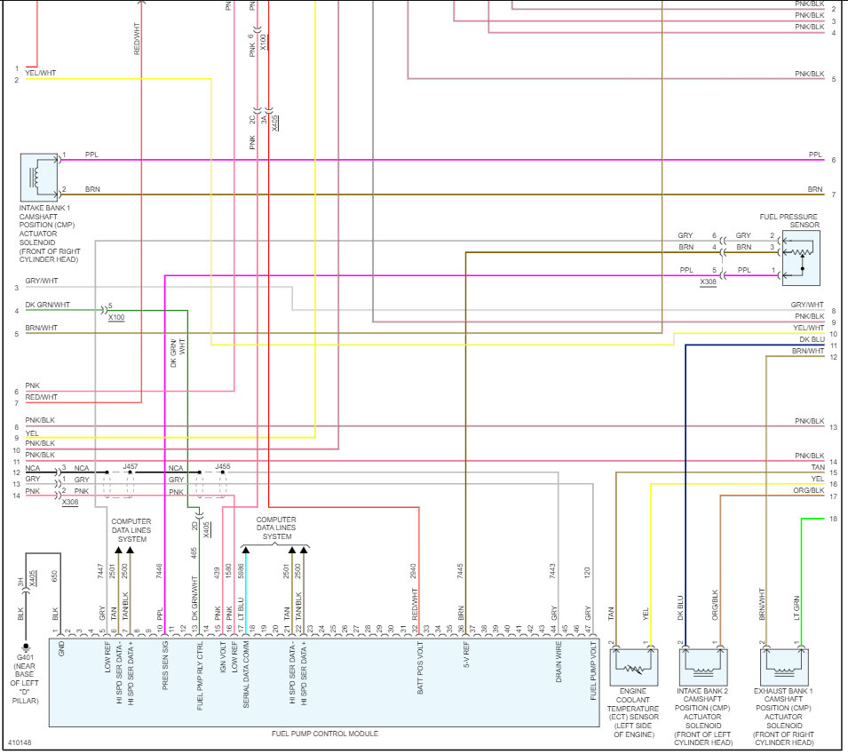

I have seen a shorted ignition coil; fuel injector or oxygen sensor cause this problem FYI. Here is a guide to help you check the wiring and I have included the PCM and engine wiring diagrams so you can run the test and see how the system works.

Actually, if I had just directly the ground and power diagram input of the ECU, it’s easy for me to work my way around.

No problem they are in the PCM wiring diagrams above.

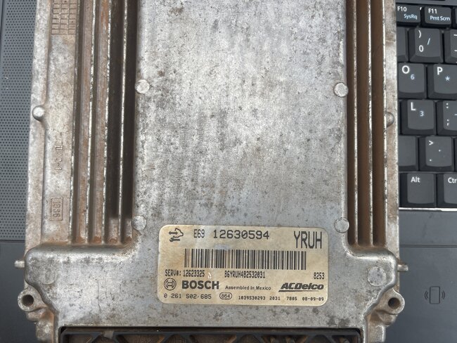

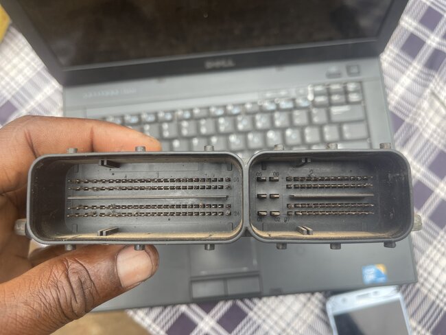

My friend Ken, please check well and see if it’s diagram for the ecu I am referring to. Let me send you an image of the ECU and its connectors. I have taken a good look and the exam diagram, not very sure it is for my PCM.

  • 55,381 POSTS
Yep, those are the correct wiring diagrams I double checked. I do see a tiny bit of corrosion on a couple of the terminals on the PCM though which can cause the issue. Can you double check the power and grounds? Also, I would check the sensor wires to see if one is melted to ground.
