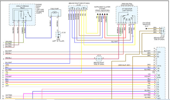

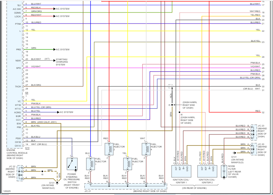

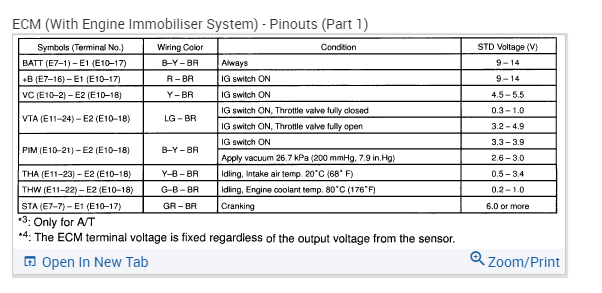

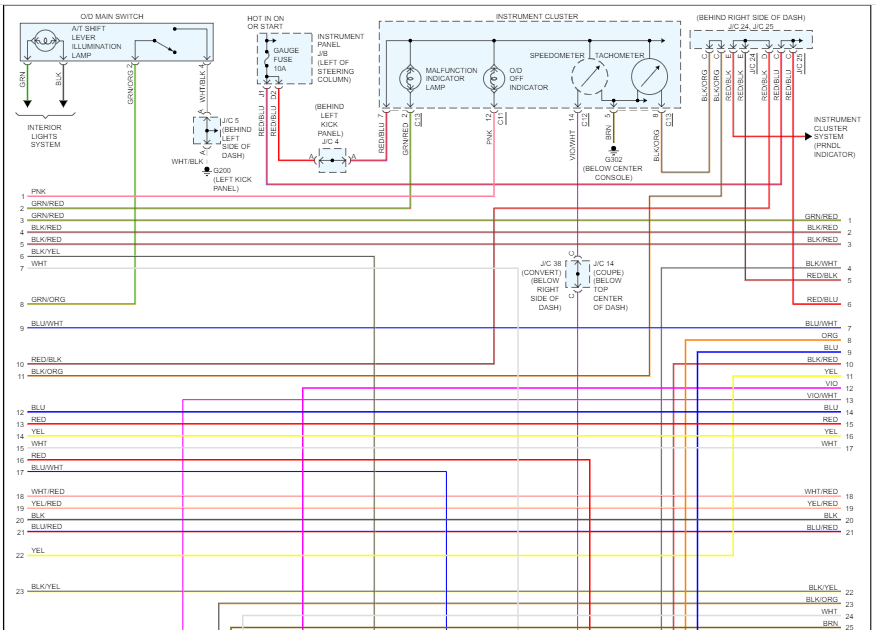

Hello guys,
First of all, I appreciate what you are doing, sharing valuable information and knowledge with us car enthusiasts.
I am trying to install the Bee-R rev limiter to my car listed above. However, I am not able to identify the Ignition cut wire and the NE+ crank wire. Does somebody perhaps have the 5S-FE ECM Pin Out or Know the color of these two wire and their Pin position? I will highly appreciate your help.
Thanks much!

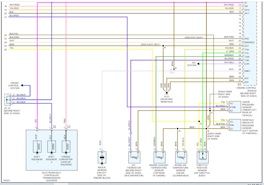

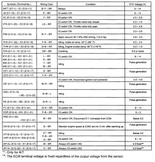

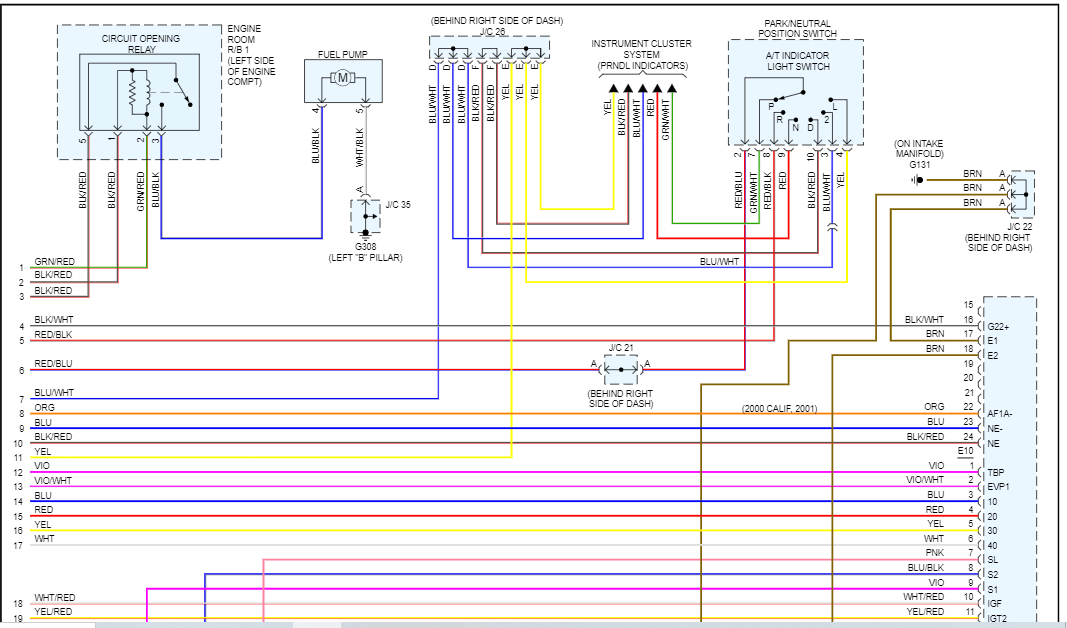

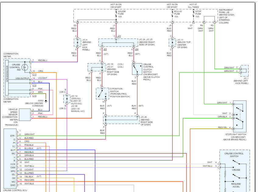

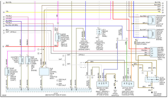

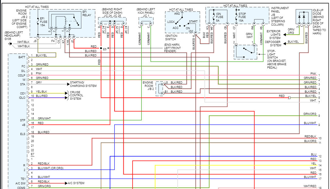

Because of the model year, my schematics are a little limited. So, I attached the powertrain management wiring schematics below which show the modules.
Now, this is for a vehicle without a factory immobilizer. If that is incorrect, let me know.
Let me know if this helps.
Note: I cut each pic in half to make them readable. I overlap them so you can follow from one to the next.
Nov 30, 2022 at 12:56 PM

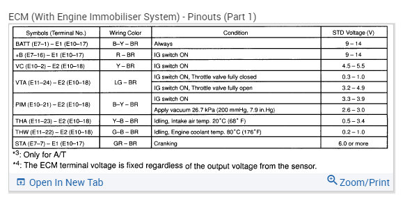

Hi Joe,
Yes indeed, mine has no factory immobilizer. The wiring schematics will for sure be more than helpful. I already have the pin out of the 5S-FE engine control, now I'll be able to double check with the colors because the pin position seems to slightly vary off of my car's connectors.

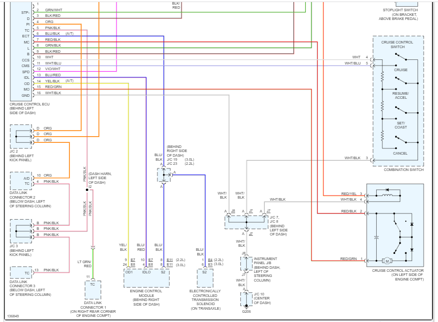

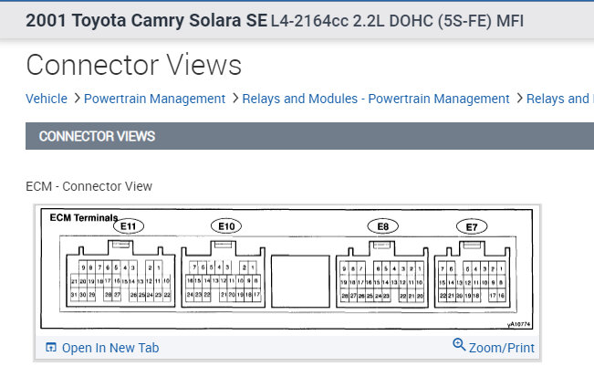

First off I gotta tell you the Pin Out sent earlier were accurate for the Solara 2001 4cyl. Thanks again for that. I specifically need schematics of the cruise control system. However, I would like to have the schematics that involve the E7 and E8 plug off of the ECM as well.
Thanks in advance!

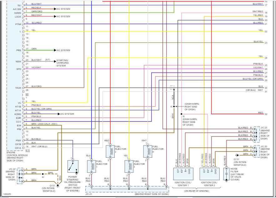

If you look at pics 1 and 2, that is the schematic for the cruise control circuits.

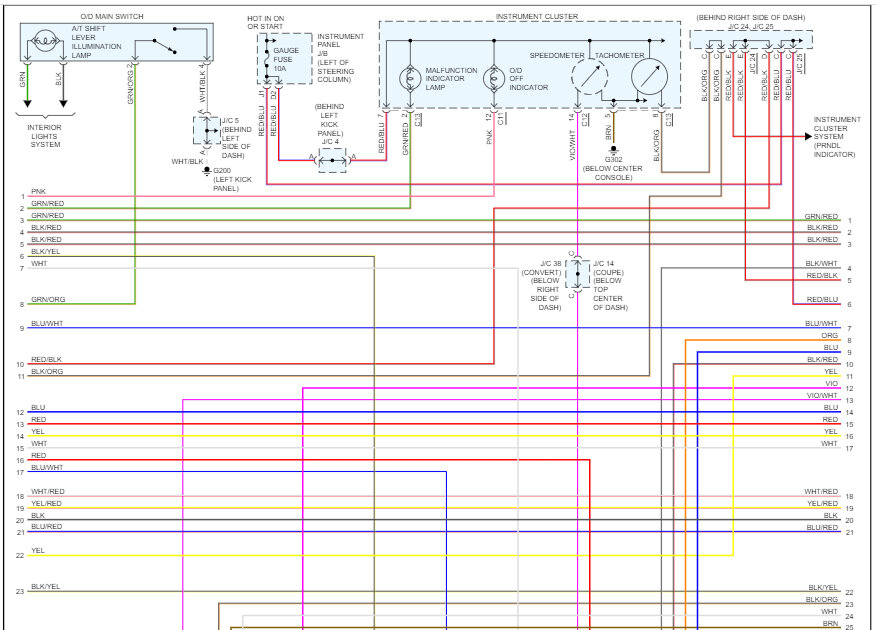

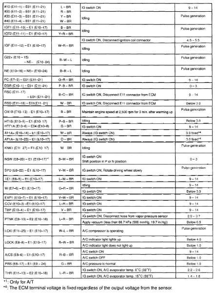

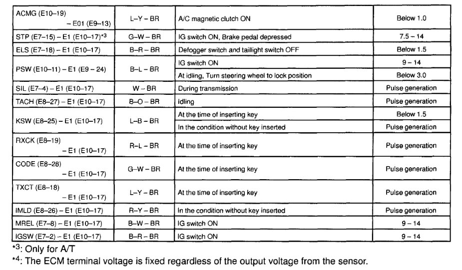

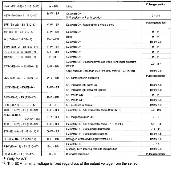

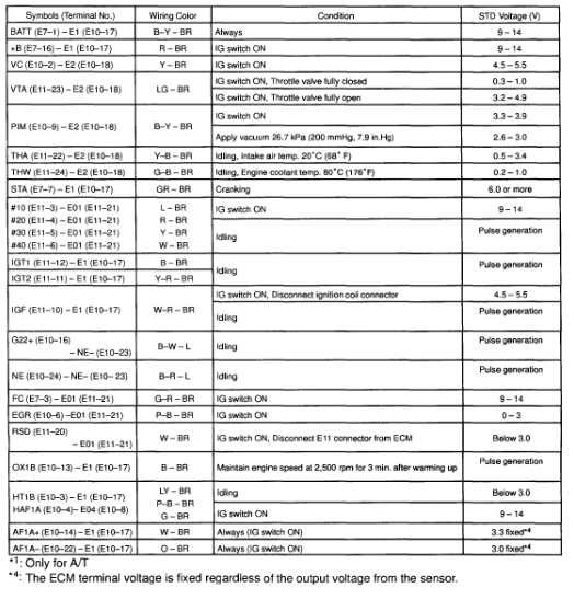

Guess what I found. The ECM pin outs. The remaining pics are all connectors including c7 and c8.
