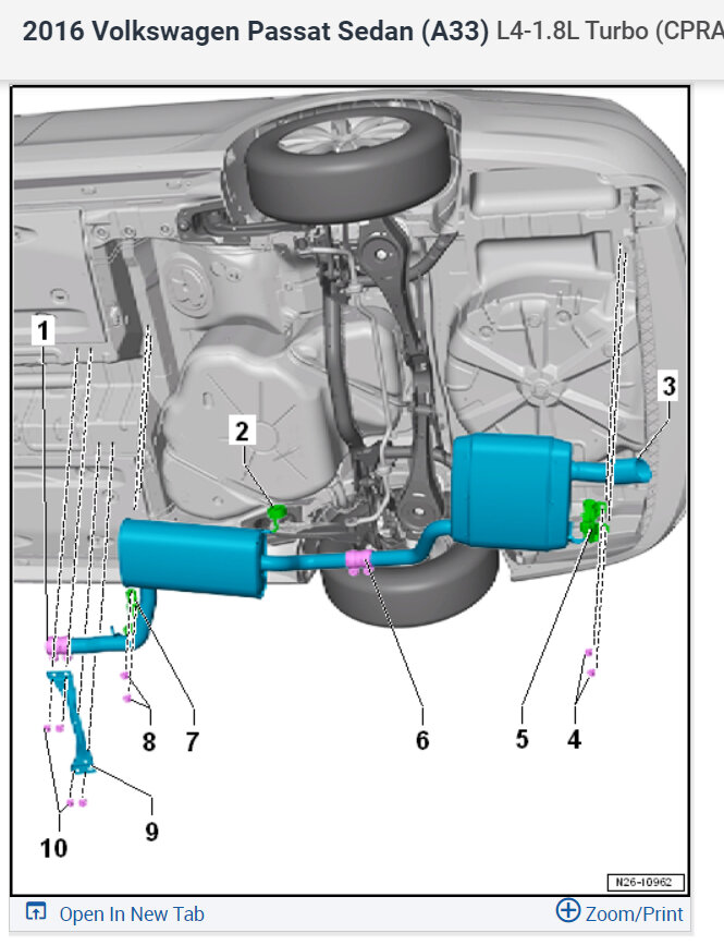

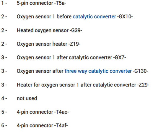

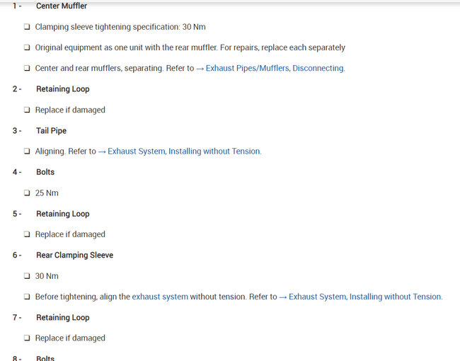

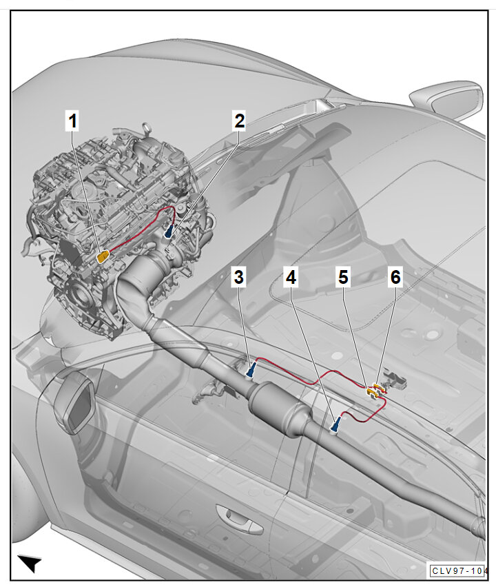

Most of the time this kind of noise will be associated with the exhaust system, like a heat shield or the catalytic converter that has come apart internally. I would wait until the engine is cold and then tap the exhaust system with a rubber mallet. This should help you find out where the noise is coming from. Can you please shoot a quick video with your phone so I can hear the noise? That way I can tell for sure what's going on.
Here is a guide to help with an engine rattle problem:
https://www.2carpros.com/articles/rattle-noise
Check out the images (below). Please upload pictures or videos in your response of any problems so we can see what to help you with.
