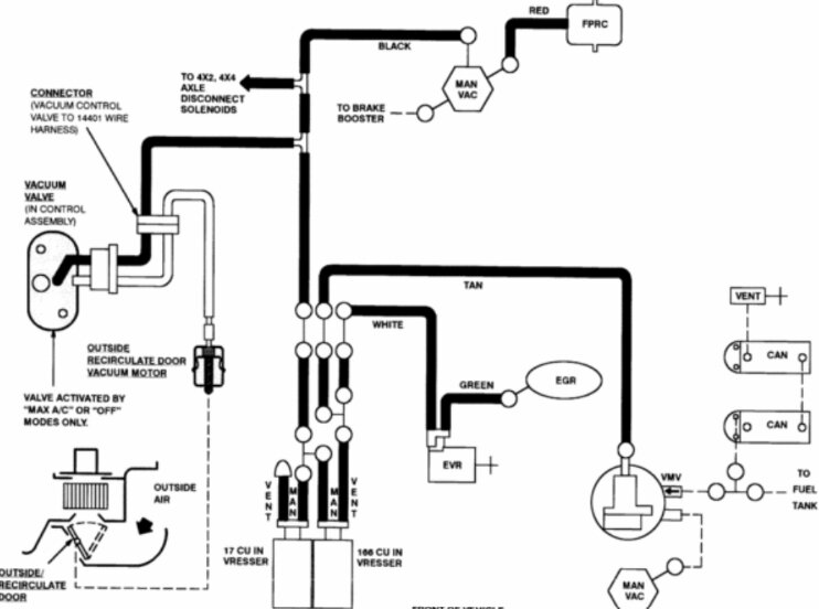

I need the vacuum hose/line routing diagram in detail for my truck listed above XLT model, 5.4 3v 4x4 flexible. I'm having difficulty ensuring that I have hooked up all vacuum lines correctly to Intake, booster, iwe, and evap purge solenoid.

Hello, and thanks for your question!
I have found a diagram and attached it below. I hope it helps, and please let us know if you need anything else!
