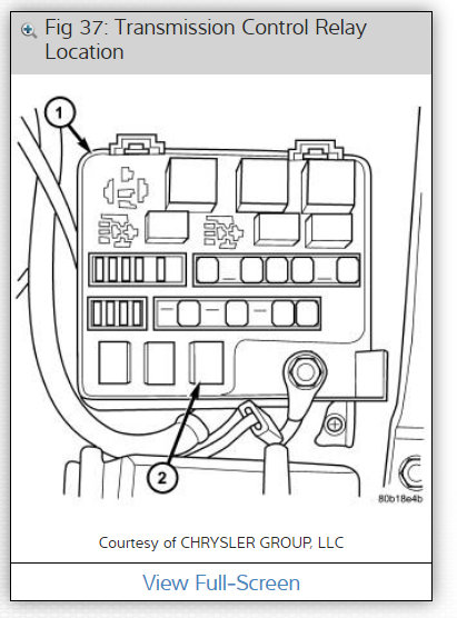

I had the check engine light come on. After checking with a scanner the codes U1467 and U0001 both came on, twice each. What are these codes representative of?
Jan 21, 2018 at 11:07 PM
  • 55,423 POSTS

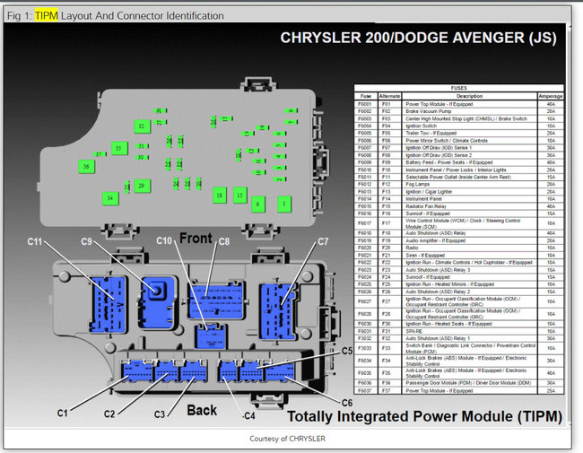

These are CAN codes letting you know the computers are not talking to each other so one is not working. The most common cause for this is a blown fuse not powering one of the computers. I would start by checking all fuses.
Here are the fuse locations and diagrams (below).
