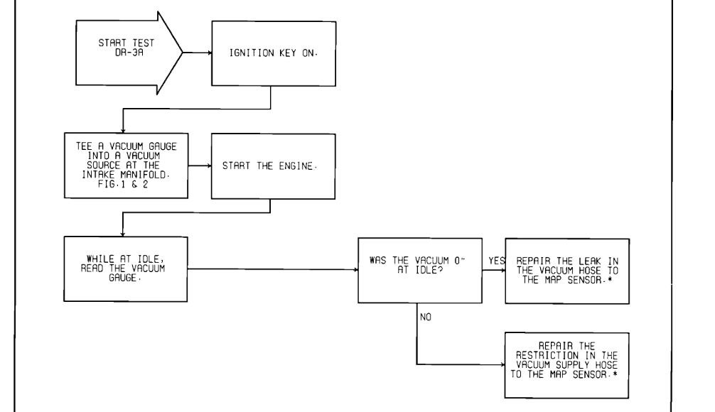

What is the difference between obd1 codes and import codes? My engine code is 3 5 5.

Good afternoon.
Did you do this with the key off and on three times and count the blinks?
If you did, 55 is end of the sequence and three would be the code.

Yes. What is code 3?

It is usually a two digit code, like one is missing.
Do it again. Key on and off three times. Then count the blinks. 55 is end of codes and not a code.
Image (Click to make bigger)
