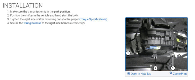

This vehicle is my daughters, and it was acting funny shifting and stuff. I put my OBD Scanner on it and came up with a P0820, which confirms a shifting issue to me. To address this kind of repair, is it something that I can get into?
Aug 1, 2023 at 12:02 PM
  • 55,770 POSTS

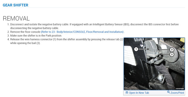

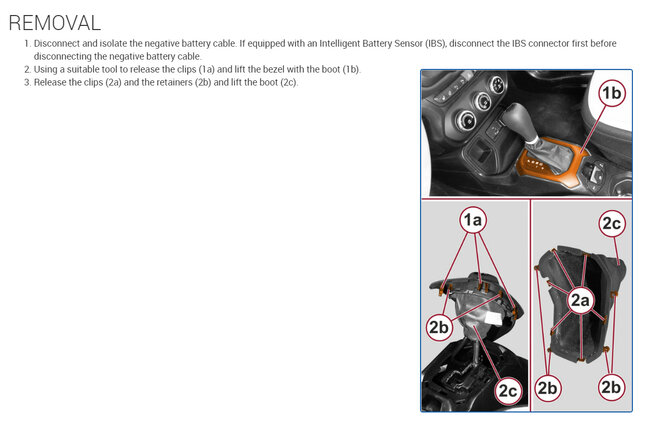

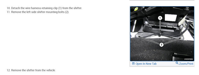

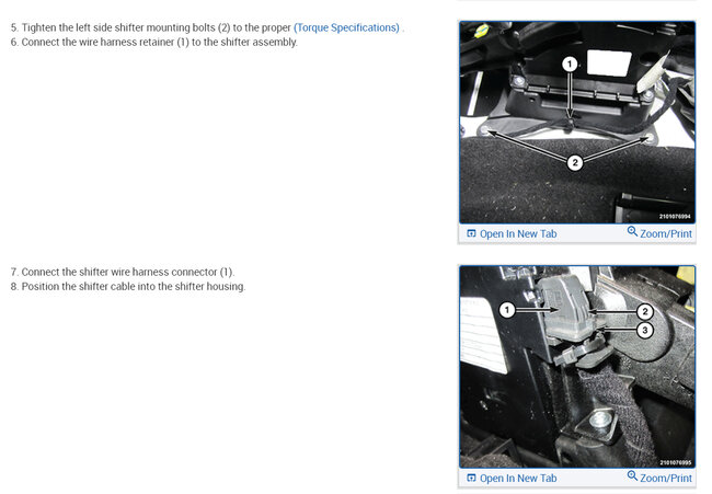

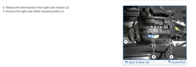

It sounds like the Transmission Range Sensor is not working, I have included the location and instructions on how to replace it in the images below.
The P0820 code in your 2017 Jeep Renegade indicates a potential issue with the Transmission Range Sensor/Switch Circuit.
Check out the images (below). Please let us know how it goes.
