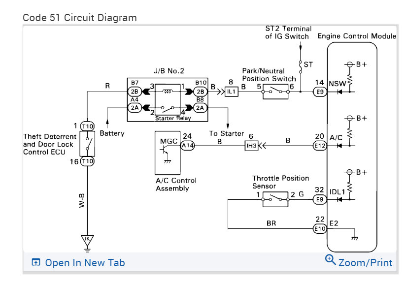

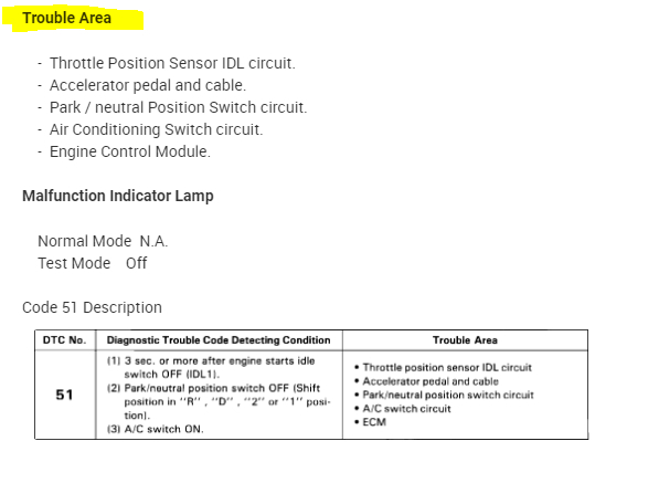

I checked the codes and found DTC 13 (rpm signal #2), DTC 51 (knock sensor #1), and DTC 55 (knock sensor #2). I changed 1 knock sensor, both cam sensors and crankshaft sensor. I rebuilt the heads a while back due to them being warped and causing overheating issues. What could be the source of the codes? I checked timing and it is on time.

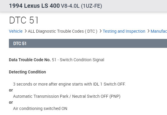

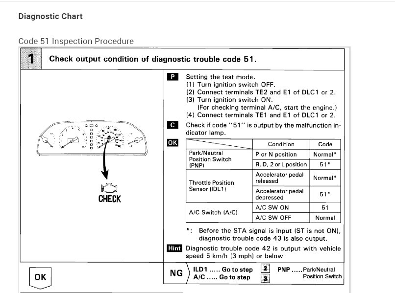

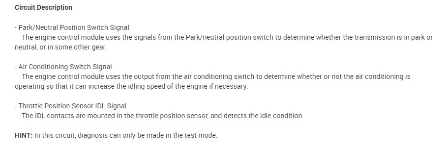

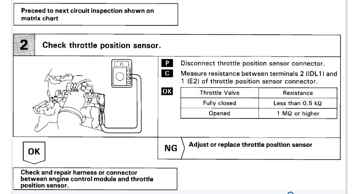

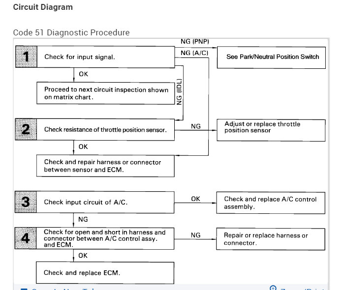

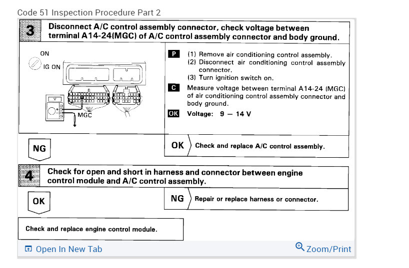

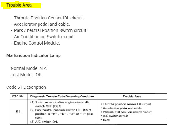

Also, according to my manual, DTC51 is a switching-related issue. I attached the information below along with diagnostics. Let me know if you are finding something different.
