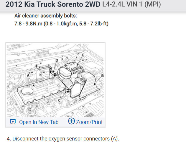

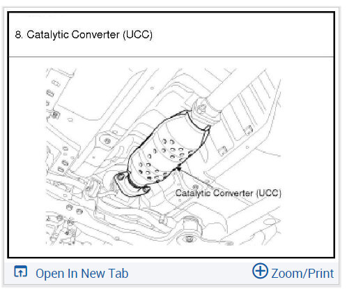

I would check the engine oil to make sure it is full and clean. The top two codes can cause the engine to run poorly. Here is how to check the catalytic converter.
P0076: This code indicates a problem with the intake valve control solenoid circuit, specifically a low voltage situation.
P0079: This code also relates to the intake valve control system but indicates a low circuit in the exhaust valve control solenoid.
P0031: This code points to an issue with the heater control circuit of the oxygen sensor.
P0445: This code indicates a problem with the evaporative emission control system, specifically with the purge control valve circuit.
P0037: Similar to P0031, this code is related to the oxygen sensor heater control circuit but specifically refers to the sensor located in bank 1, sensor 2.

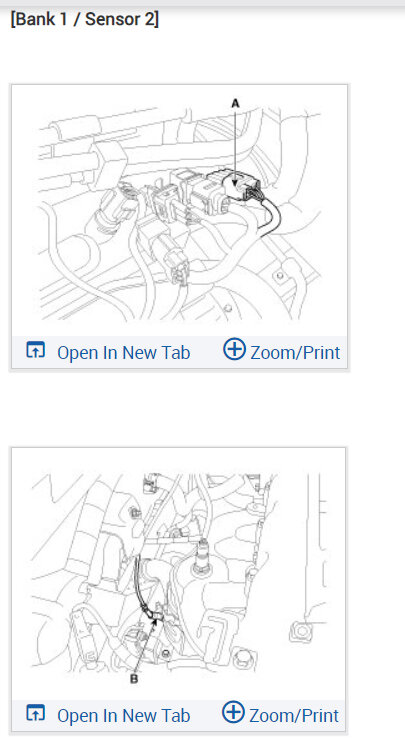

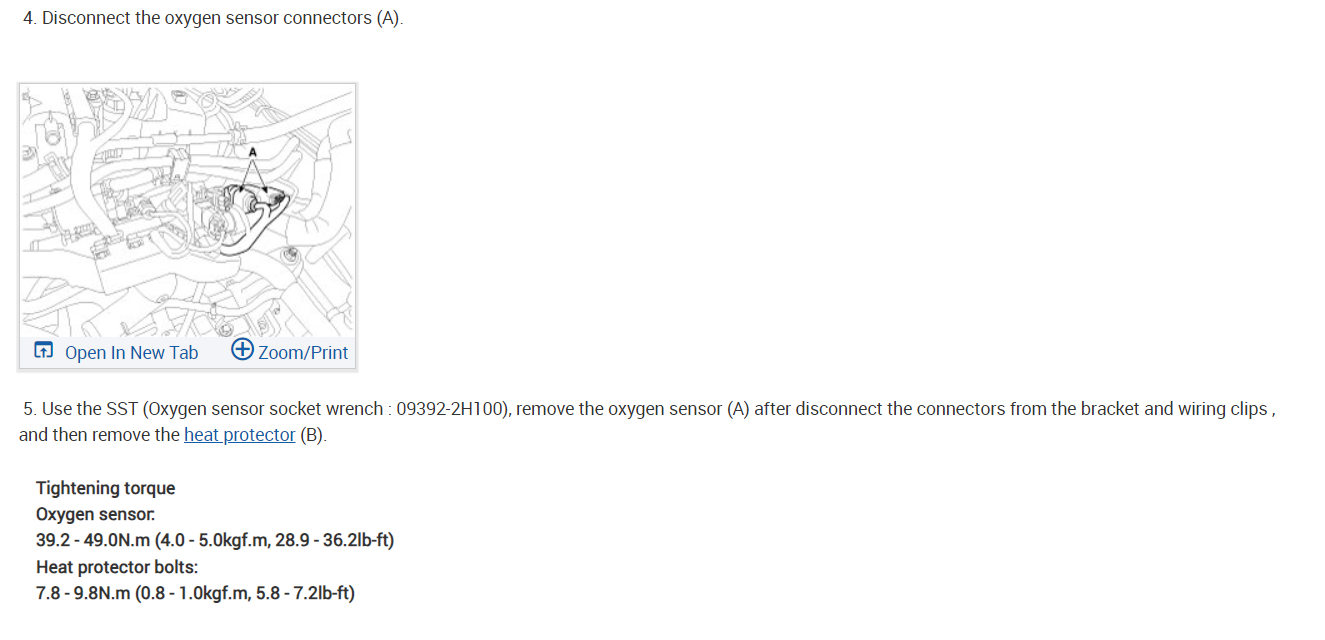

Please start a new question for the P0445 code. Here is the location of the oxygen sensor so you can swap that out. Usually the honeycomb inside the cat falls apart and plugs the outlet fyi. Check out the images (below). Please upload pictures or videos of the problem so we can see what's going on.

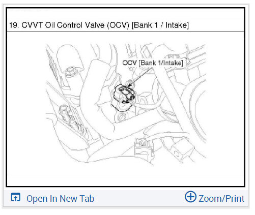

Here is the location of the intake oil control solenoid so you can swap it out as well.

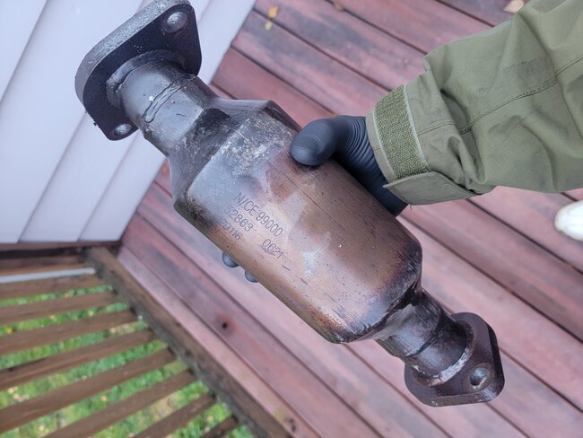

Finally got the cat off. Failed the light test. Ordered the replacement and will go from there.
Dec 10, 2023 at 5:39 AM
  • 55,433 POSTS

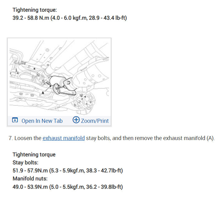

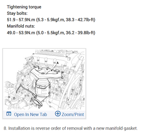

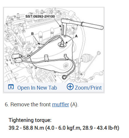

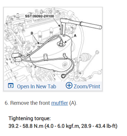

Good work, but that looks like the secondary cat, did you check the primary cat? The primary cat is part of the exhaust manifold. Please go over the diagrams above. Please let me know what you find.
Dec 11, 2023 at 1:47 AM
MCSWANSON11
  • 31 POSTS

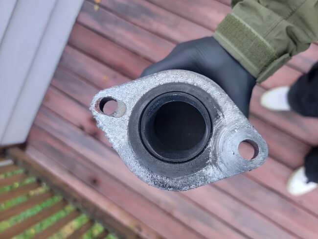

Good morning, I was able to remove the exhaust manifold. Primary cat was dirty as well. Waiting for that part to be delivered to replace it along with a new gasket and downstream 02 sensor.
Jan 4, 2024 at 1:12 AM
  • 55,433 POSTS
Yep, that will cause a problem, can you see down inside the inlet to tell if the catalyst material is melted or broken?
Jan 5, 2024 at 12:44 AM
MCSWANSON11
  • 31 POSTS
I can see inside the exit inlet, and it is solid black with faint lines of the cat filter screen. I will post a picture when I get home from work this afternoon.
