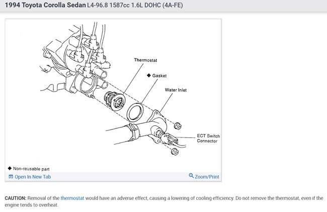

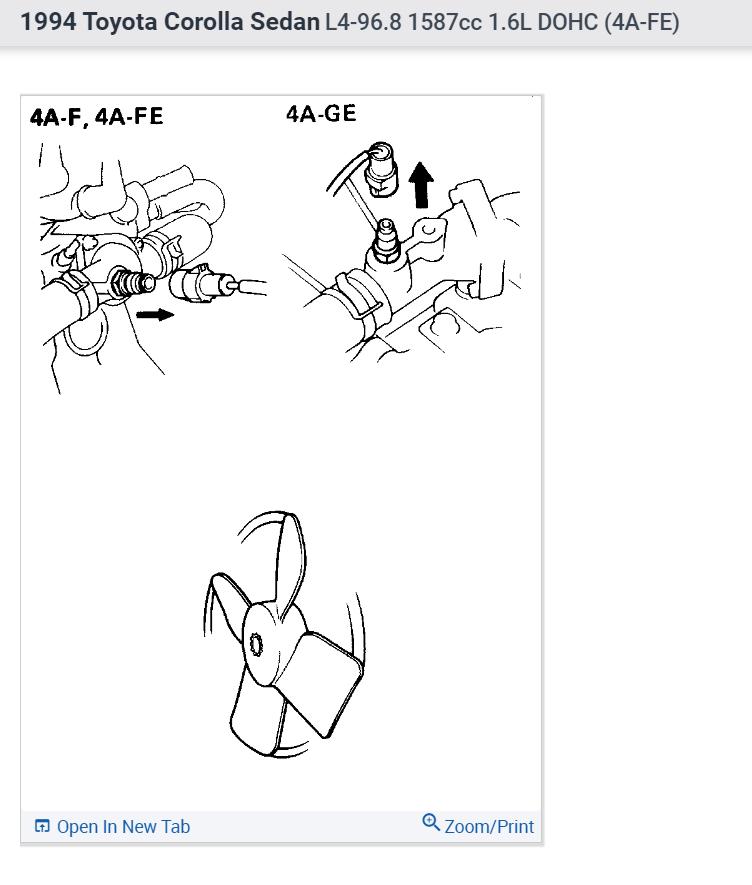

Yeah, the temperature gauge doesn't work all that well, constantly reads as just above cold. I'm worried that means the radiator fans won't switch on.
Dec 19, 2022 at 8:37 AM
  • 55,464 POSTS

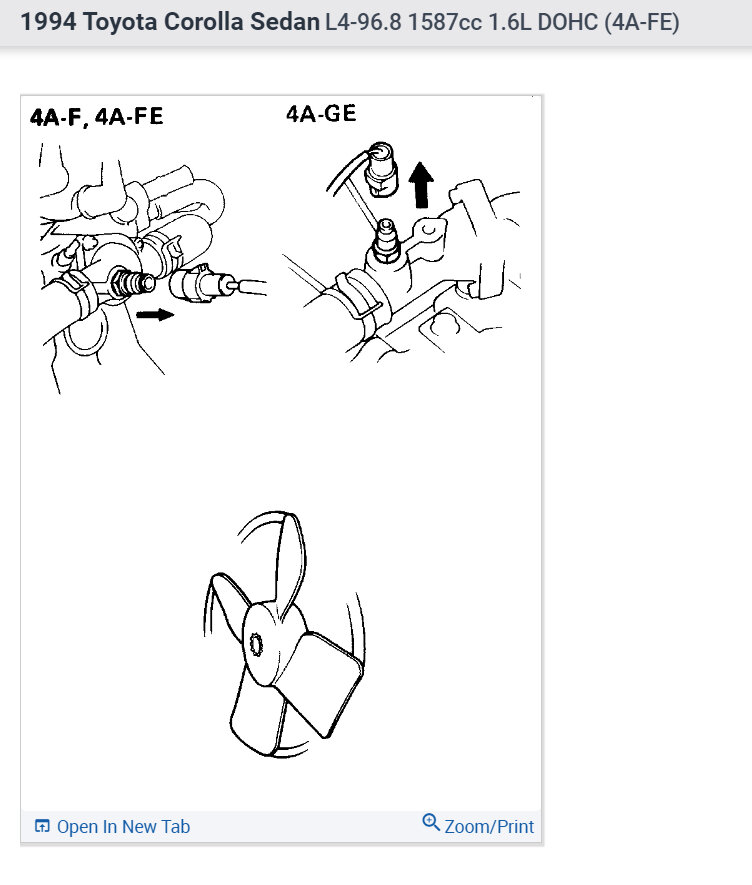

Yep, I would replace the engine coolant sensor which should fix the gauge and allow the cooling fans to come on. Here is the location of the sensor below. Please let us know what happens.
Dec 20, 2022 at 2:58 AM
BRETT HALEY

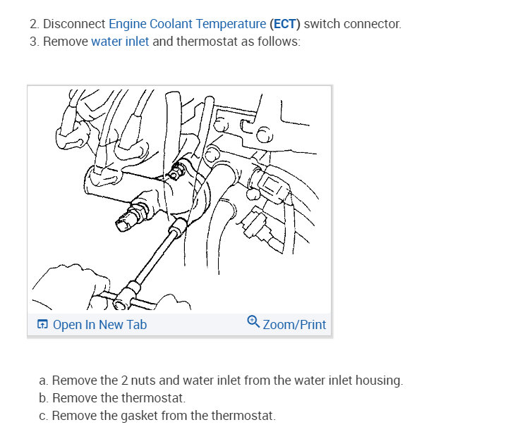

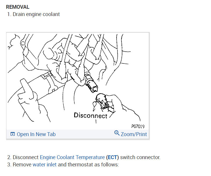

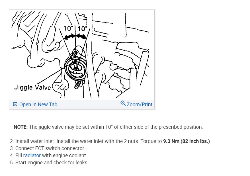

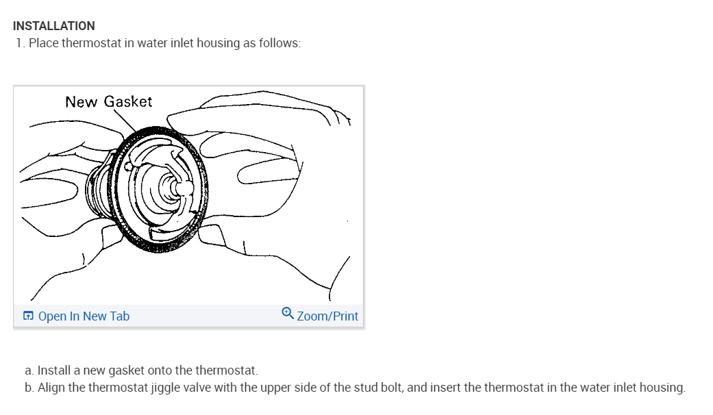

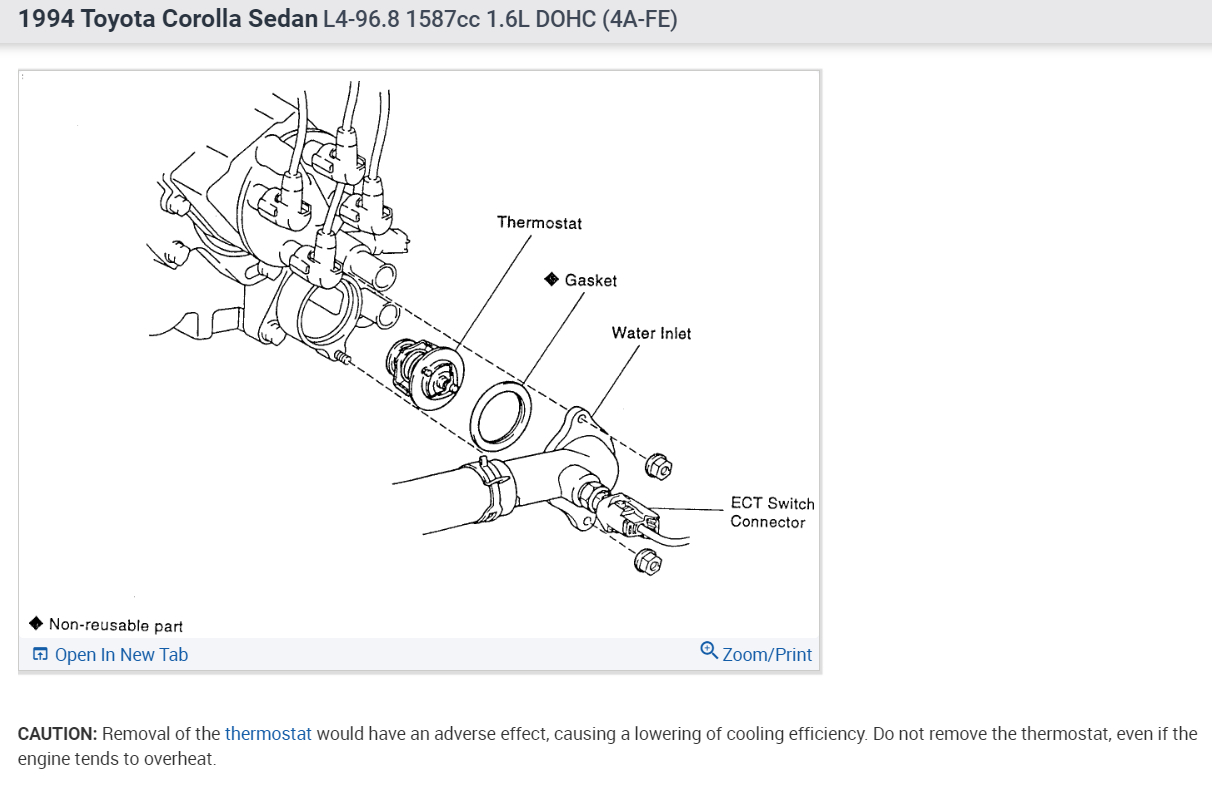

Okay, so, I replaced the coolant temperature sensor, and it made it a little better, but the temperature gauge is still sitting low (just above cold) and I'm wondering if I need to replace the thermostat, your input would be much appreciated.
Dec 21, 2022 at 7:14 AM
  • 55,464 POSTS

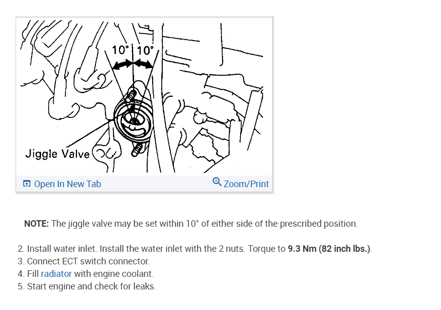

Yep, it sounds like it may be stuck open. here is a generic guide to help you through the steps and the thermostat location and how to replace it in the images below:
