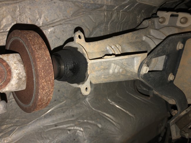

I am having a chirping noise I can’t seem to figure out. I have replaced the belt and the tensioner pulley. While the belt was off I spun the other pulley's and did not feel or hear any issues. I would like to fix it but it has been hard diagnosing where it’s coming from. Any ideas on what else it could be? When I get under the truck while it’s running it is much louder. Not sure if that would help. Any advice would be great. The more I listen to it it more sounds like it’s coming from the back of the engine or even below the truck altogether.

Did you check the torque converter bolts for being loose? Look up there as well and see if the flywheel is cracked. It gives off a noise just like this.

How do I check the flywheel?
Jan 23, 2019 at 4:00 AM
Look around the area at the flywheel and see if there are any rust lines. That indicates a crack in the flywheel.
If you are not sure, have someone check it for you to be sure.
