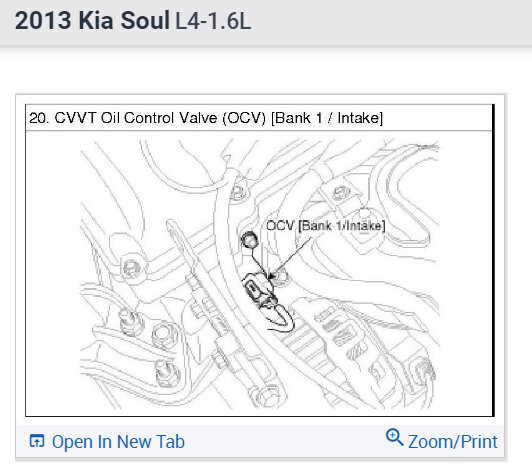

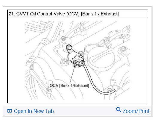

This happens when the oil pressure is low, or the cam phasers are worn out. Can you give me the codes number so I can tell you how to fix it? I would make sure the engine oil is clean and full. Just to be sure these are the valve you changed out. Check out the images (below). Let us know what happens and please upload pictures or videos of the problem so we can see what's going on.

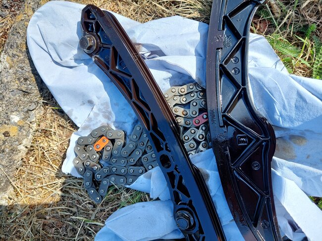

Okay, will get some photos of the old timing chain tensioners and sprockets before he changes them.

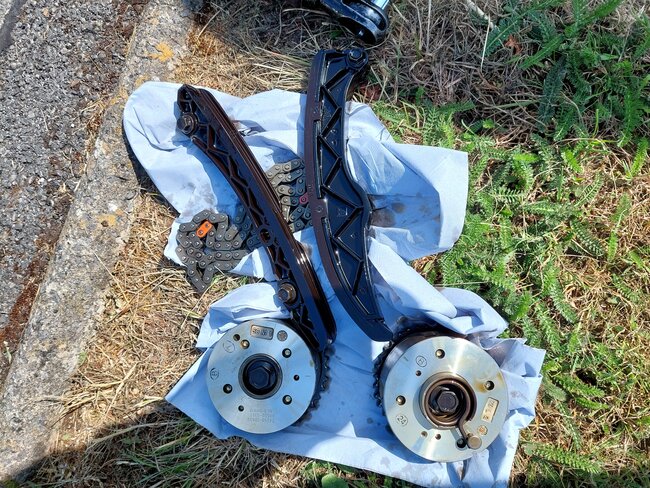

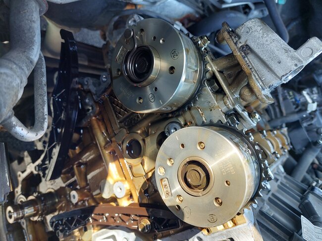

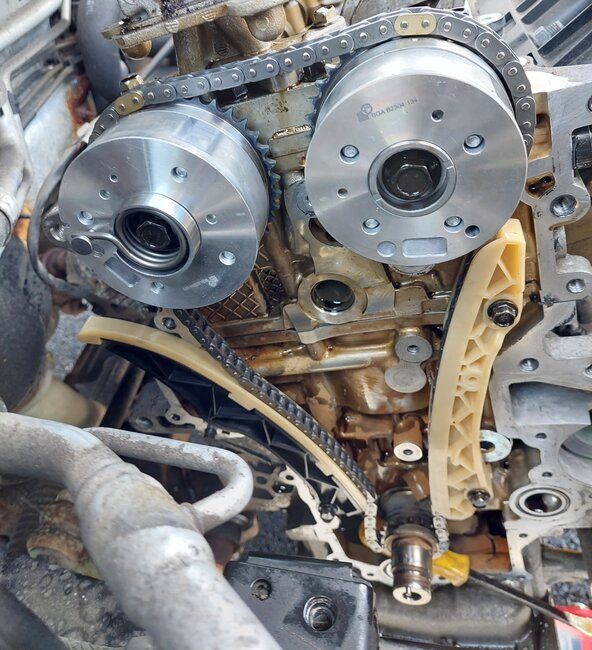

Old and New.

Nice work, it looks like the engine has been well taken care of. The new actuators should fix the problem, make sure to change the oil and filter, clear the codes when the repair is completed. Let me know what happens please.

There were a few worn teeth on the sprockets which would cause the engine check light to come on. The mechanic said the cam lobes/lifters were like new and didn't look like they had covered 80,000 miles.
