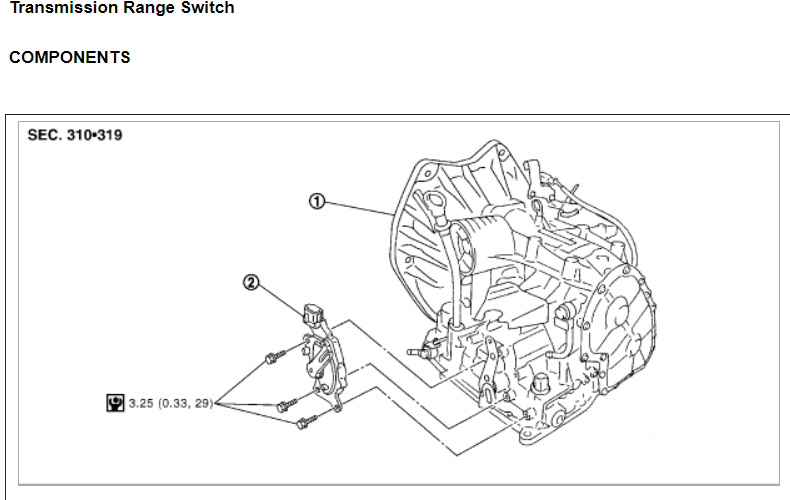

Sometimes when I try to put the car in drive mode or just moving the shift any at all its tough and the sport mode button doesn't work??
Dec 18, 2017 at 11:39 AM
  • 54,832 POSTS
Yes it sounds like the transmission range sensor is out and needs to be replaced. Here is a guide to help you test to confirm the failure.

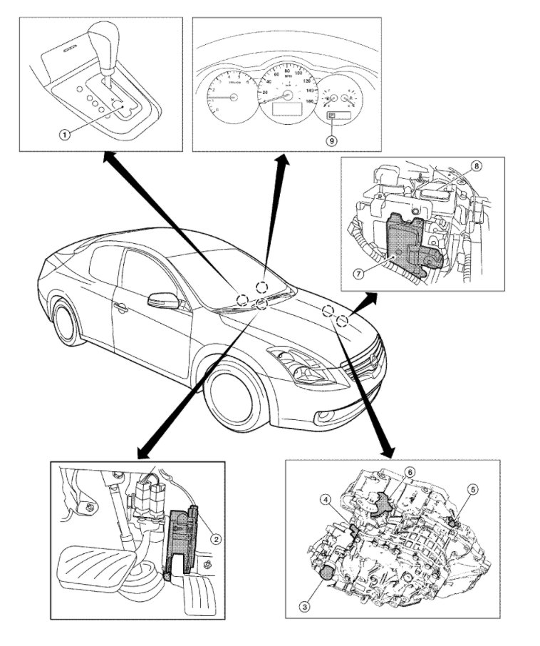

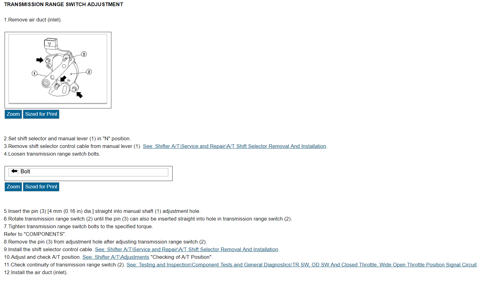

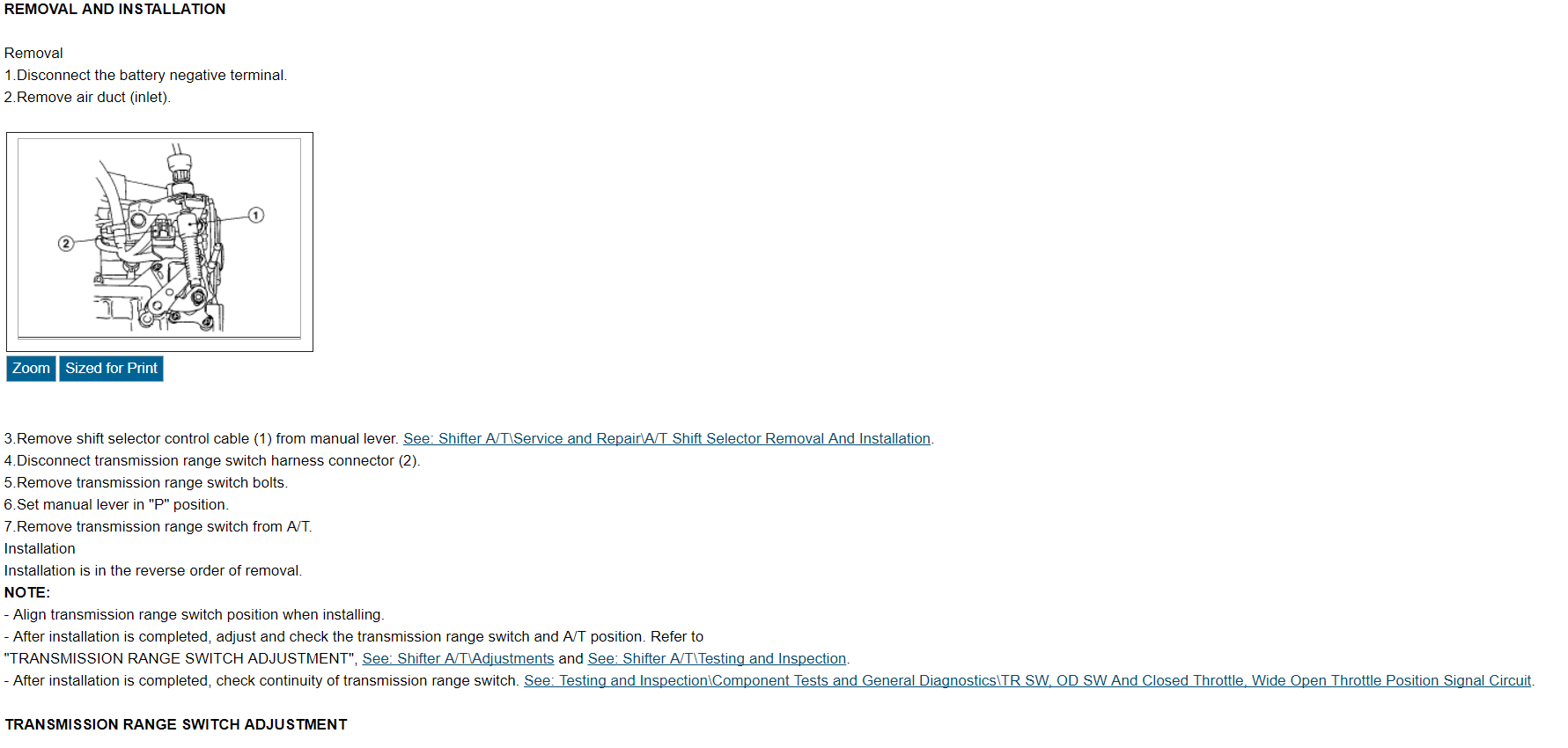

  • 54,832 POSTS
Yes the RPM and range sensors are not the same thing. I found another transmission diagram to help us get the problem fixed. (Check it out below)
