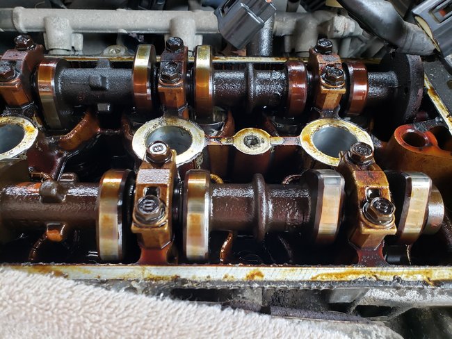

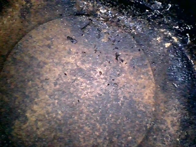

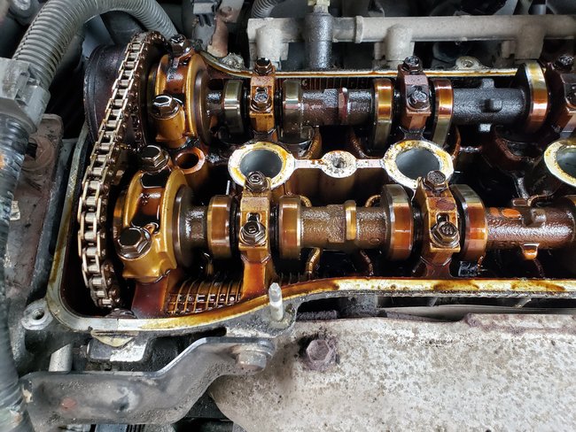

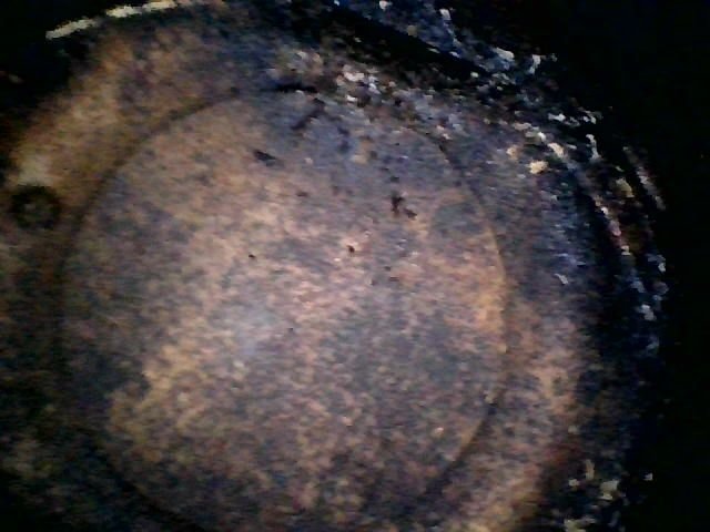

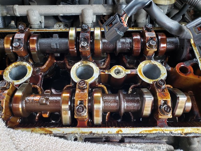

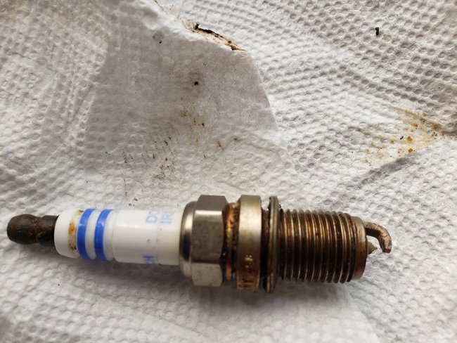

I replaced the valve cover gasket on the car listed above.
Based on the pictures I attached, would you tell me if I have to do anything to prolong engine life?

Based on the mileage and what I see, all I can say is keep doing what you have been doing. It looks clean, especially for the mileage.
The one ticket is keeping the engine oil changed on a regular basis and using a quality oil filter. Also, make sure to keep the PCV clean and operating and the air filter clean.
