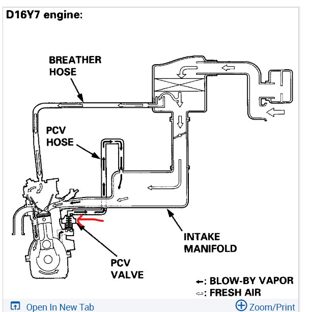

What would cause engine to burn oil and how do I fix?

Most of the time when the engine starts burning oil it will be the PCV system, I would change the valve out to see if it helps, (the spring breaks inside the valve). Check out the images (below). Please let us know what happens.
