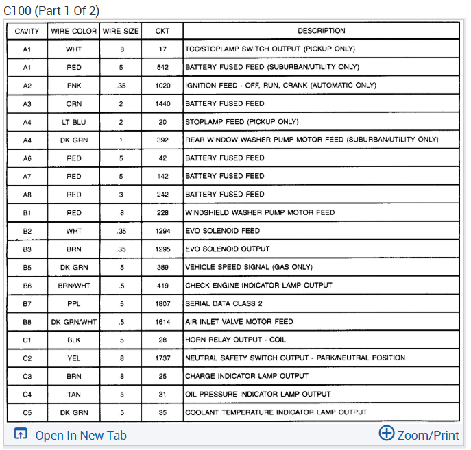

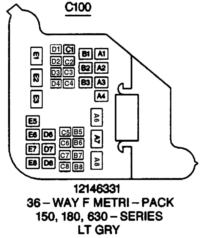

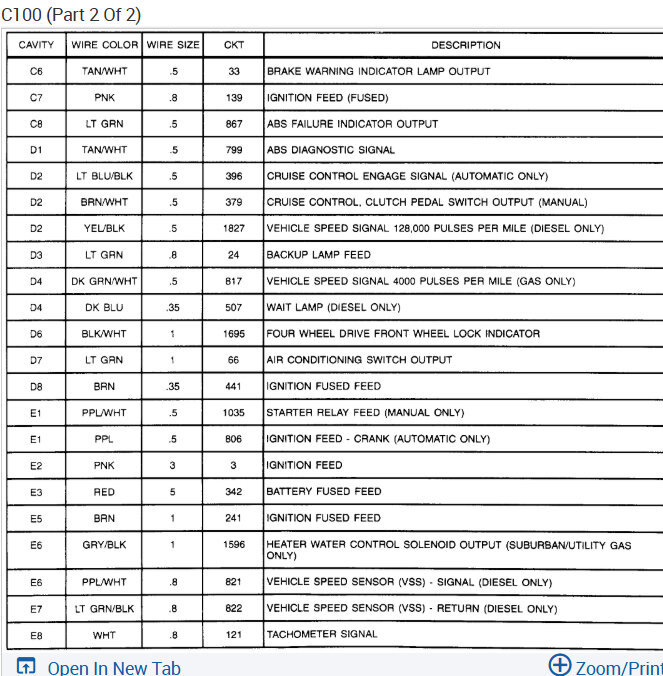

I need the diagram for the wire pin out for the engine bulkhead connector from the engine bay
Sep 21, 2025 at 1:16 AM
Experienced Mechanic
55,612 POSTS
Sure, here you go! have a good Sunday. Check out the images (below). Let us know if you need anything else.
