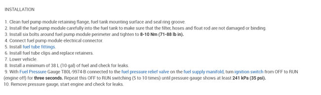

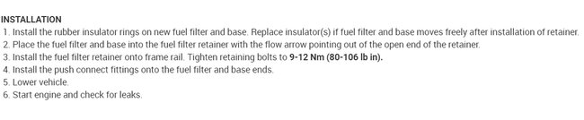

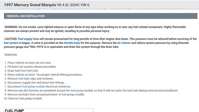

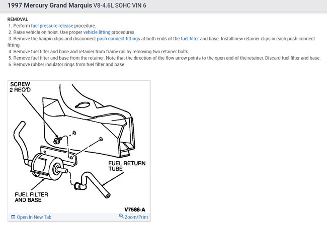

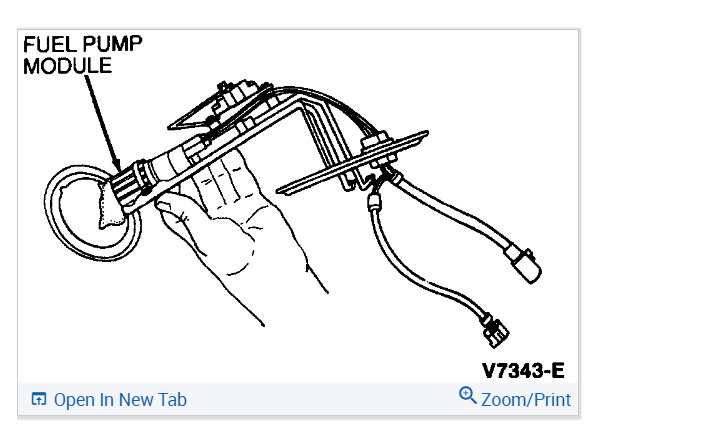

Yep, this sounds like a typical fuel pump failure, but I would start by changing out the fuel filter, here is the location so you can change it out. I have also included how to change the fuel pump out in case you need it.
