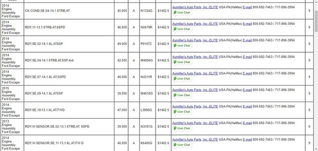

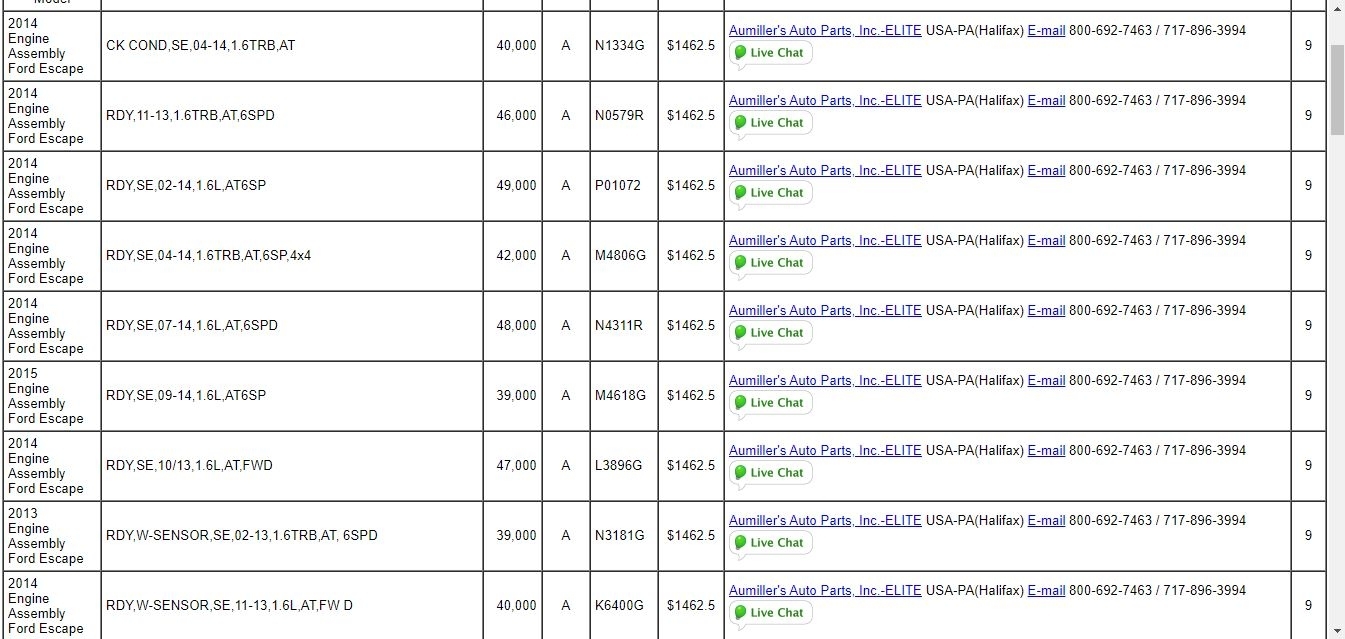

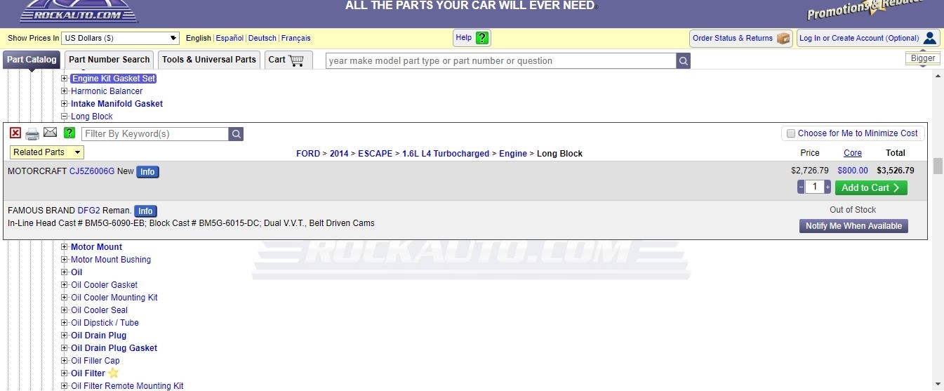

Okay, I have found a couple options.
1. A used engine under 40k for about 1600 plus installation. Plan on about 3k or more.
2. rebuilt unit. The engine is around 3k plus installation. Plan on about 5k.
I found the used engine at www.car-part.co.
Rebuilt at rockauto.com.

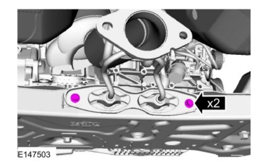

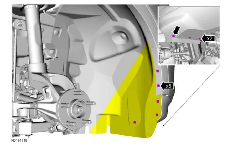

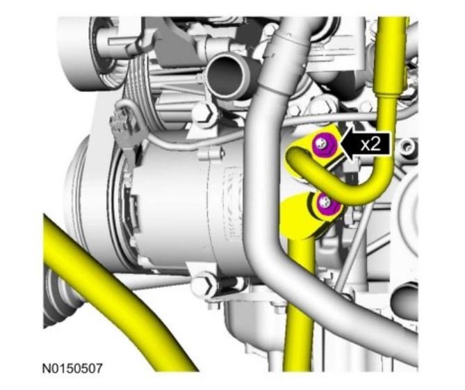

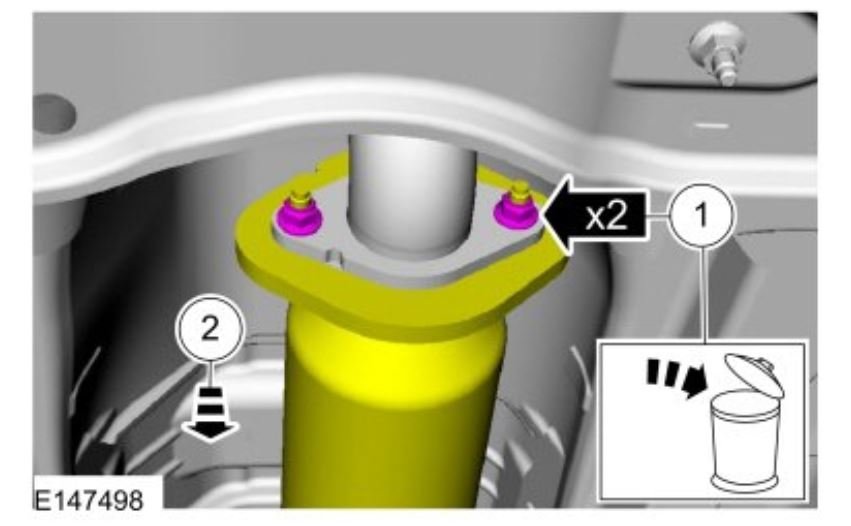

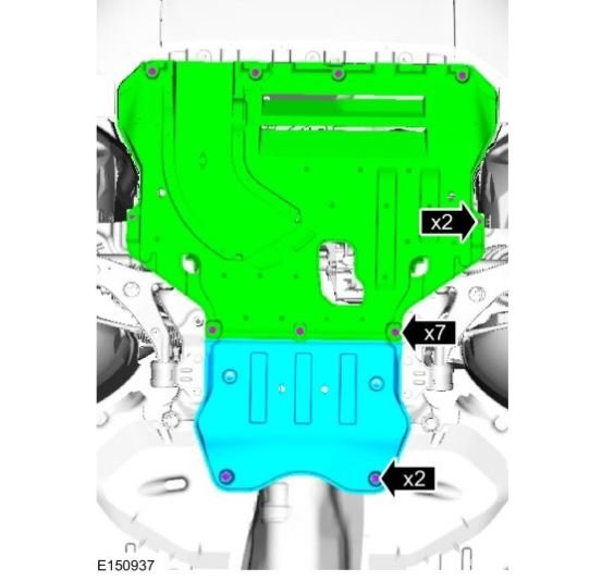

Removal procedure is below for you.
All vehicles
1. Refer to: Jacking and Lifting - Overview See: Vehicle Lifting > Procedures > Jacking and Lifting (100-02 Jacking and Lifting, Description and Operation).
2. Refer to: Fuel System Pressure Release See: Fuel Pressure Release > Procedures > Fuel System Pressure Release (310-00A Fuel System - General Information - 1.6L EcoBoost (110kW/150PS)- Sigma, General Procedures).
3. Refer to: Air Conditioning (A/C) System Recovery, Evacuation and Charging See: Heating and Air Conditioning > Procedures > Air Conditioning (A/C) System Recovery, Evacuation and Charging (412-00 Climate Control System - General Information, General Procedures).

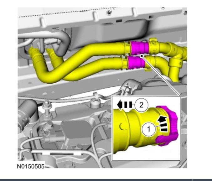

4.
5. Refer to: Cooling System Draining and Vacuum Filling See: Cooling System > Procedures Cooling System Draining and Vacuum Filling (303-03A Engine Cooling - 1.6L EcoBoost (132kW/180PS)- Sigma, General Procedures).

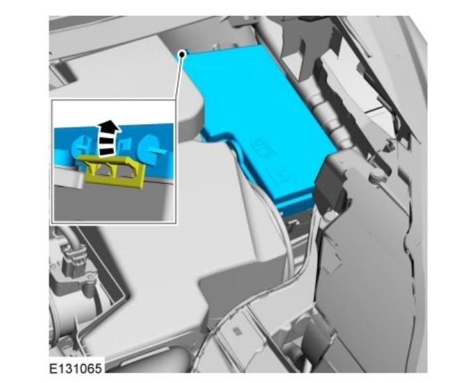

6. Refer to: Cowl Panel See: Cowl > Removal and Replacement > Cowl Panel (501-02 Front End Body Panels, Removal and Installation).
7.
8.
9.
10.

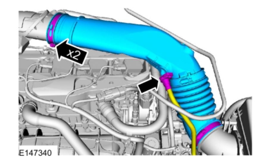

11. Refer to: Air Cleaner See: Air Filter Element > Removal and Replacement > Air Cleaner (303-12A Intake Air Distribution and Filtering - 1.6L EcoBoost (132kW/180PS)- Sigma, Removal and Installation).
12. NOTE: If equipped with block heater.
13.
14.
15.
16. Refer to: Battery Tray See: Battery Tray > Removal and Replacement > Battery Tray (414-01 Battery, Mounting and Cables, Removal and Installation).
17.
18.
19.
20.
21.
22.
23. NOTE: Always wrap the fuel line connection with a towel before disconnecting it.
Refer to: Spring Lock Couplings See: Fuel Line Coupler > Procedures > Spring Lock Couplings (310-00A Fuel System - General Information - 1.6L EcoBoost (110kW/150PS)- Sigma, General Procedures).
Use Special Service Tool: 310-250 Disconnect Tool, Fuel Line.
24.
25. Use the General Equipment: Hose Clamp Remover/Installer
26.
27.
28.

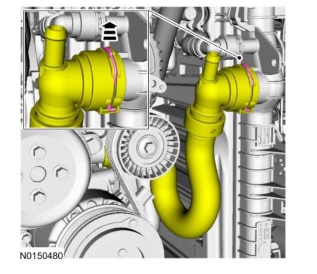

29. Refer to: Degas Bottle See: Coolant Reservoir > Removal and Replacement > Degas Bottle (303-03A Engine Cooling - 1.6L EcoBoost (132kW/180PS)- Sigma, Removal and Installation).
30. Use the General Equipment: Hose Clamp Remover/Installer
31.
32.
33.
34.
35.

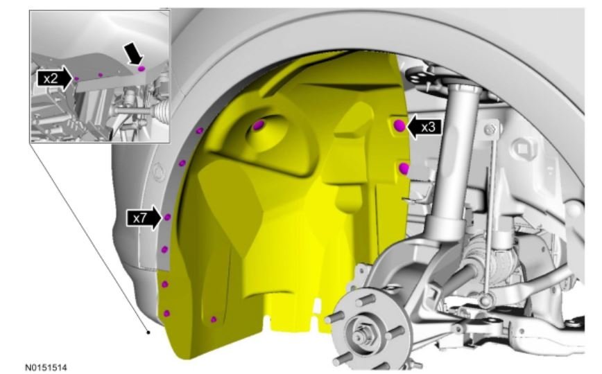

36. Remove the front wheels and tires.
Refer to: Wheel and Tire See: Wheels and Tires > Removal and Replacement > Wheel and Tire (204-04A Wheels and Tires, Removal and Installation).
37.
38.
Remove the drain plug and drain the engine oil.
Use the General Equipment: Oil Drain Equipment
Install the drain plug.
Torque : 21 lb.ft (28 Nm)
39. Use the General Equipment: Strap Wrench
40.
41.
42.
43.
44.
Vehicles with
45.
46.
All vehicles

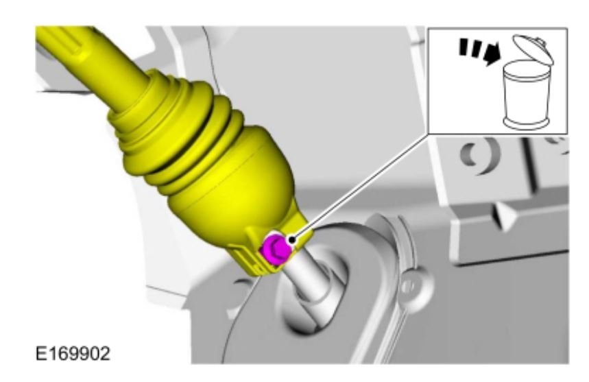

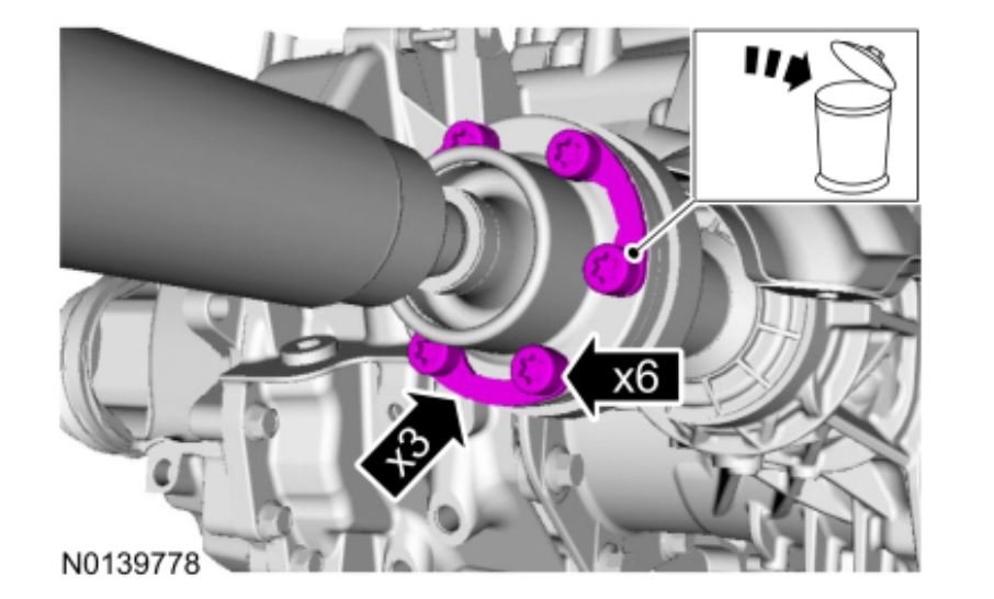

47. NOTE: Discard the O-ring seals and gasket seals.
48. NOTE: LH shown, RH similar.
Both sides.

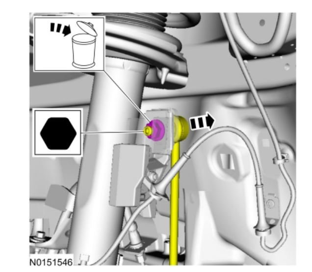

49. NOTICE: Use the internal or external hex-holding feature to prevent the ball and stud from turning while removing or installing the stabilizer bar link nuts. The link boot seal must not be allowed to twist while tightening the link nuts or damage to the boot seal will occur.
Both sides.

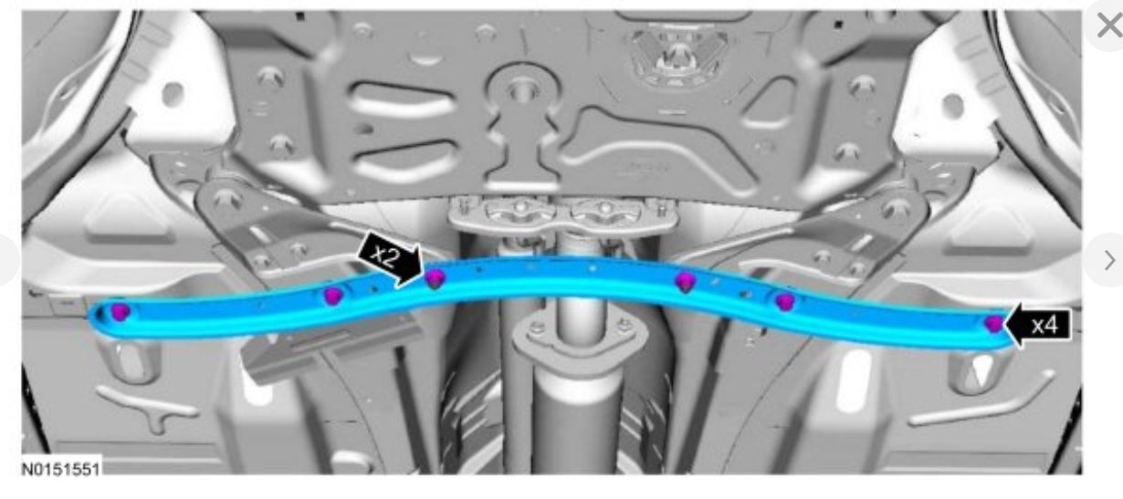

May 1, 2020 at 4:26 AM

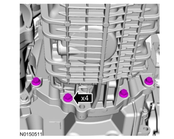

Okay, part 2.

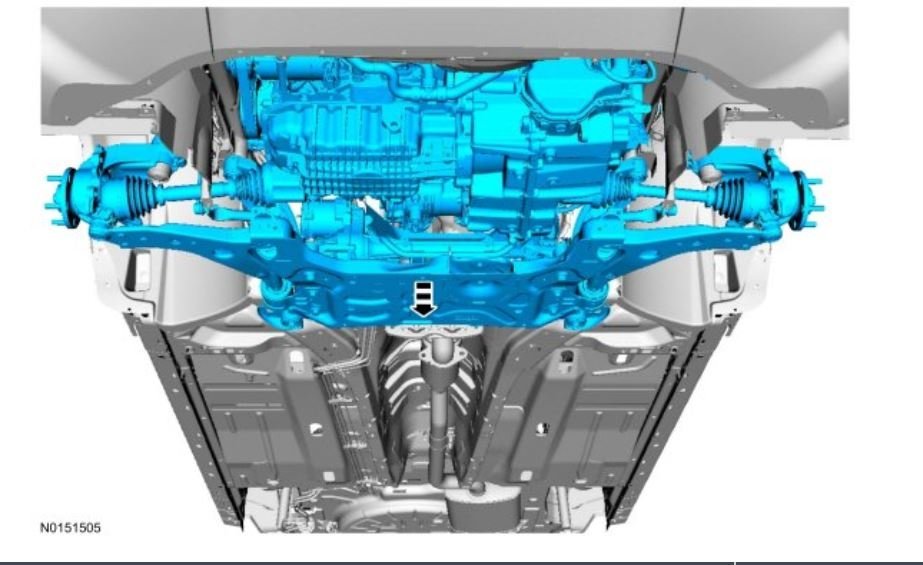

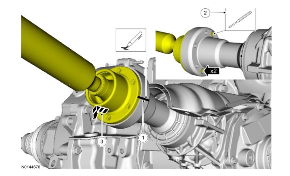

I attached the rest of the removal. The engine and the transmission come out together and come out the bottom as in the illustration.
It is a huge project to try to do without the correct tools and a lift.
Engine
All vehicles

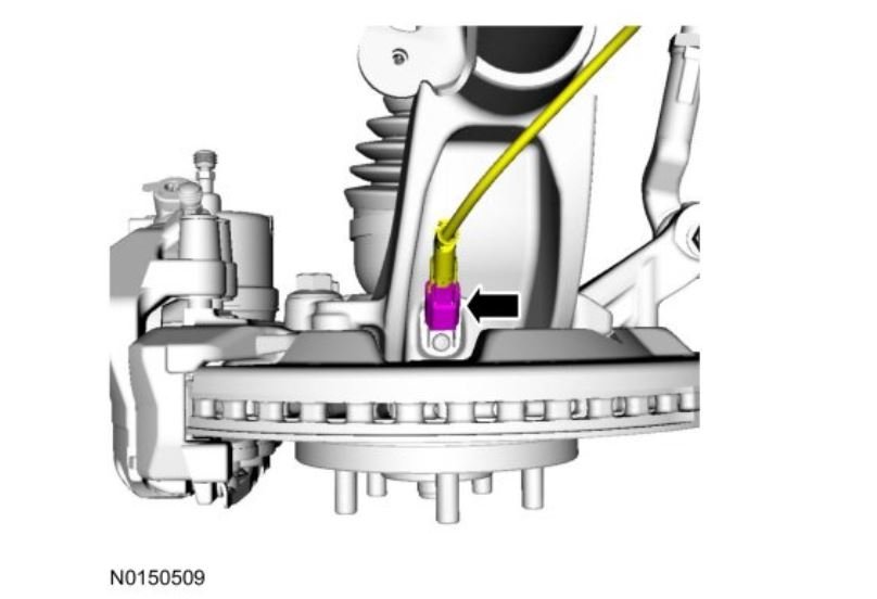

50. Refer to: Brake Disc See: Brake Rotor/Disc > Removal and Replacement > Brake Disc (206-03 Front Disc Brake, Removal and Installation).

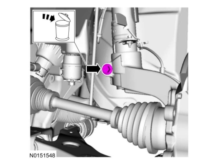

51. NOTE: The struts will need to slide out of the knuckles when the powertrain and subframe assembly is lowered.
Both sides.

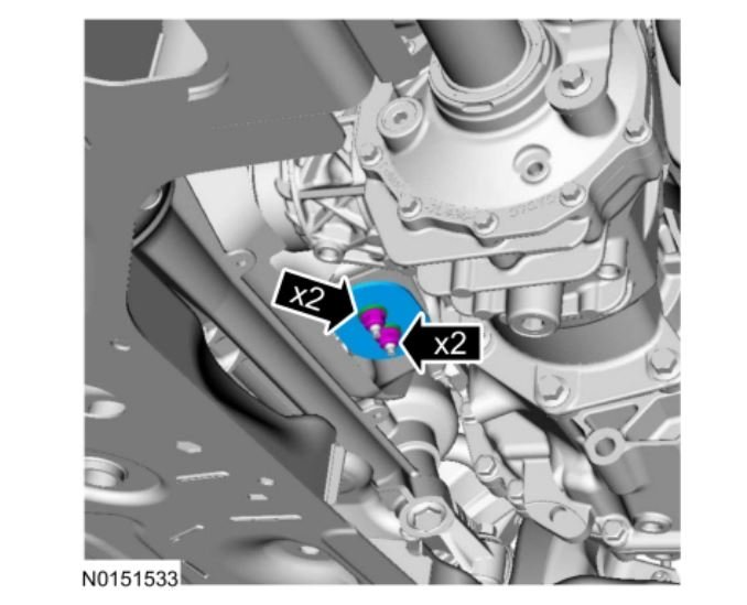

52. NOTE: One of these bolts will be used to mount the Adjustable Mounting Arm to the powertrain.
53. NOTE: AWD (all-wheel drive) shown,FWD (front wheel drive) similar.
Vehicles with

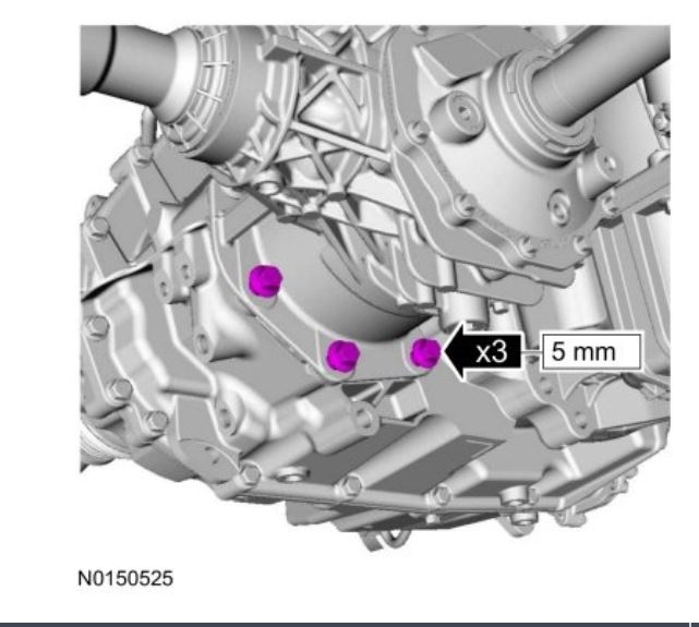

54. Loosen the 3 bottom PTU bolts.5 mm (0.019in).
All vehicles
55.
56.
57. NOTE: LH shown, RH similar.
Both sides.
58.
59.
60.
61.

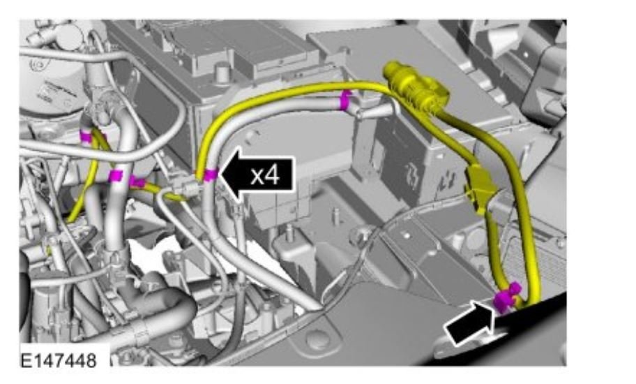

62. NOTE: Front bumper cover removed for clarity.
NOTE: There are 2 similar connectors in this area the area behind the PCM case, disconnect the upper connector.

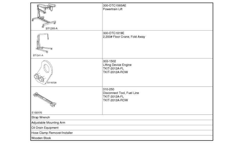

63. Position a 2 x 6 board, 24 in (609.6 mm) in length and two 2 x 6 boards 30 in (762 mm) in length onto the Powertrain Lift.
Install Special Service Tool: 300-OTC1585AE Powertrain Lift.
Use the General Equipment: Wooden Block
64. Position the powertrain lift table with the two long boards under the engine and transmission and the short board under the subframe.
65. Use the General Equipment: Adjustable Mounting Arm
66.
67.
68.
69.
70. NOTE: Make sure the struts slide out of the knuckles when lowered.
Using the powertrain lift, lower the powertrain and subframe assembly.
